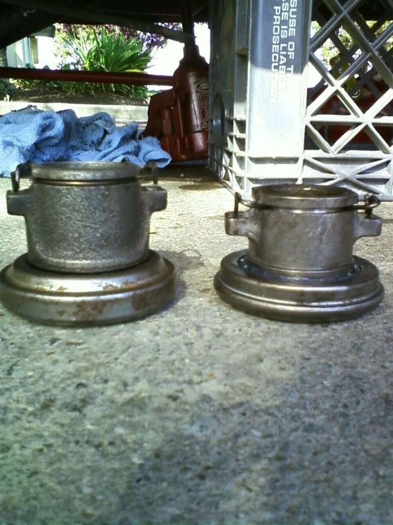

Just so everyone can see the difference, the release bearing and sleeve that came with the clutch kit is on the right. The one Ice was kind enough to give me (the one I needed) is on the left.

that should do the trick.. wish i could help you out installing it this weekend...
