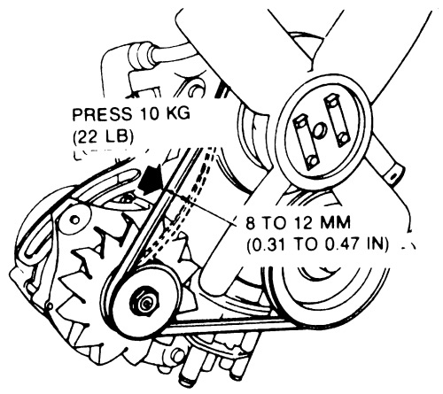

It is easy to check the deflection of the belt...get a long flat tool like a measuring stick and lay it on the longest straight run of the belt so that it is laying flat on the belt. Now take a ruler and push on the belt in the middle and measure how much it moves...1/4" should be fine on a long span on a L28. If you have a quarter inch or slightly more your belt is probably not to tight. If it doesn't move or moves like 1/32 or 1/16" then you need to loosen that belt up!!

Actually Jmmorriso, it depends on the length of the belt between pulleys, the type of belt and how much force is applied to find the deflection amount. I didn't realize which belt he was talking about until I re-read the post but if you want exact figures for the Alt belt from 1970-83 is no more than .44in (1.1cm) at the middle of the longest span or accessible span with 22lbs, (10kg) or (9Nm) of force applied with the thumb. Your Welcome

I drive a 1980 280zx. An s130. Sorry for the confusion. The thread I found on the site when I searched "Overchrging" was part of the 240 forum, I did state however that I could not find anything for later years.
Went to auto zone and for some reason I was under the impression that somone on this thread told me they could test it without me removing it from the car. Anyway of course they cannot without a garage. their machine is not on wheels.
So, now that we know my car has an internal volt reg, if it turns out that it is bad can I just disassemble the alternator and replace the voltage regulator or is that probably too big of a job?
thank you thxone and jmmoriso for the tension info
