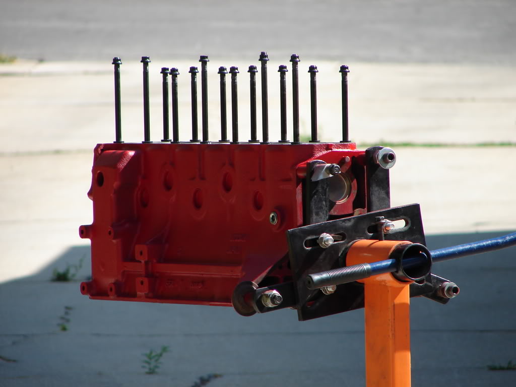

i havnt checked the timing in a while, not since i initially started wrenching on this thing. the rads empty right now, but im not sure which plug the engine drain plug is. anyone have a pic of this? i'll also consult google. (no luck so far)

Engine drain plug for coolant right? (making sure you don't mean oil... which is obviously on the oil pan).
That plug is on the left side of the block under the exhaust manifold, aprox between cyl 5 & 6.
See the chrome plug on my motor? That's the location (stock is a rusty bolt).

yeah,i found the rusty bolt alright.....holy $%^# that things in there. its not reverse thread or some silly thing is it? I cant get it to budge. sheesh.

hehe... yeah, you'll probably need to soak it in PB Blaster for a few, then use a breaker bar. Be careful... that's one bolt you REALLY don't want to break.

^ I didn't break the bolt. I broke the wrench I was using it on. lol Those bolts are practically welded on.

got it, with nothing broken, cept i did slightly round the edges. oh wel still works fine.
