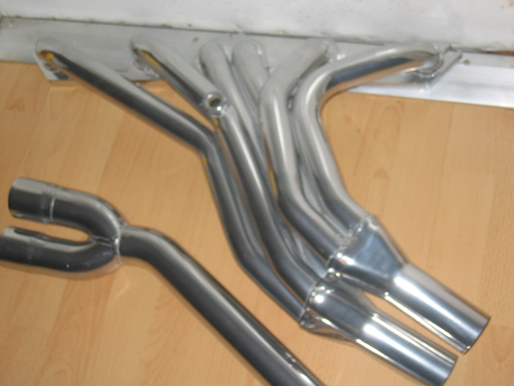

exhaust headers from MSA?
I'm wondering if I have to weld both pieces or if just putting both pieces together will do the trick; they're a tight fit, but I just want to make sure that I'm doing it right. Both pieces are not connected, yet, all the way through, as I said they're a tight fit and I'm wondering if they're just supposed to be fitted manually or welding is the way to go.
Here's a picture of the actual headers I have.

i doubt sliping it together will do, get clamps.

If you really don't want them to leak then have them welded...but some real good clamps will do.

Yeah, I was thinking about welding it.

i have them.. there suppose to be force in.. and when the car is on.. and it gets hot, there suppose to stick together so you dont need to do any of those thing.. but i was looking at em the other day.. and it looks like it is slipping.. it came out maybe 1/4 of an inch... but i had them on for like 6 months w/o welding or clamps
this would only work if the outer one didnt expand with heat, but when both of them get hot they both expand so its not much of a seal...get clamps

I have em' on mine. Slip them on after you bolt it to the head. We got mine on beating them on with a two by four and a mallet from the cat end of the collector, then clamp them down. They have never leaked on me and I never welded it together.

i had to weld mine, just needed to be tacked on. i found out they fall apart after some time. then you here tinka tink a tink. and very loud smelly exhaust. trust me!

Yes, I'm going to slip both pieces together and then take them to get welded.

Those are Jet Hot Coated headers. I don't think you can weld them without breaking the coating away. I have that same header, but I haven't gotten that far in my engine build so I can't help much. Although my slipon wasn't coated just the headers themselves.
Indeed, you're right.
I had them grind them a bit so they could weld them. I rather weld than use clamps and then have to get readjust those clamps six months later.
