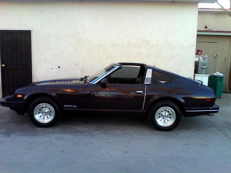

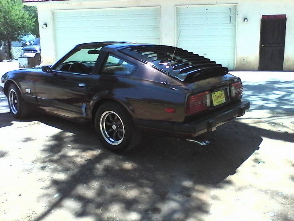

the first picture is my 83 280zx its purple outside and inside.the 2nd car we just picked up a few months ago really cheap its an 82 280zx turbo and its brown,but I love my purple 280 and feel lost without it running
