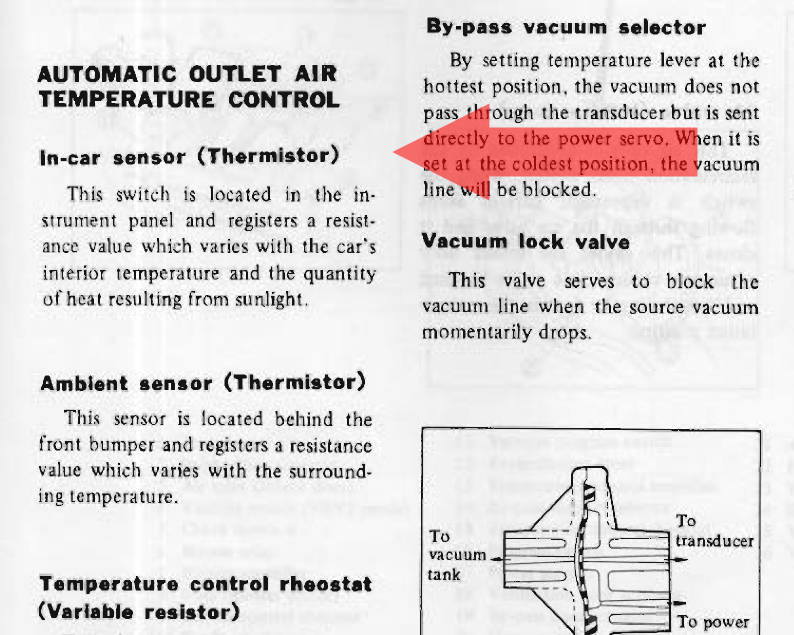

Scans of FSM, Section HA, pages 57 & 60:
See "In Car Sensor" ?
Attached Thumbnails 82 280ZX climate control-ha57.jpg   82 280ZX climate control-ha60.jpg

So what exactly does the aspirator have to do with the in car sensor, and will the in car sensor work without the aspirator?

It's called an "ASPIRATOR FAN" in the FSM.
It's a fan... it sucks in air from the dash to hit the In Car Temp Sensor, so the auto a/c knows the current ambient air and can auto adjust accordingly. If you disconnect it, obviously it won't work correctly.
