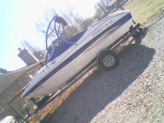

yo hammer pending on what ur amp is mounted to you might wanna try elevating it on spacers just a lil, did this on my boat and no more thermal cut off
