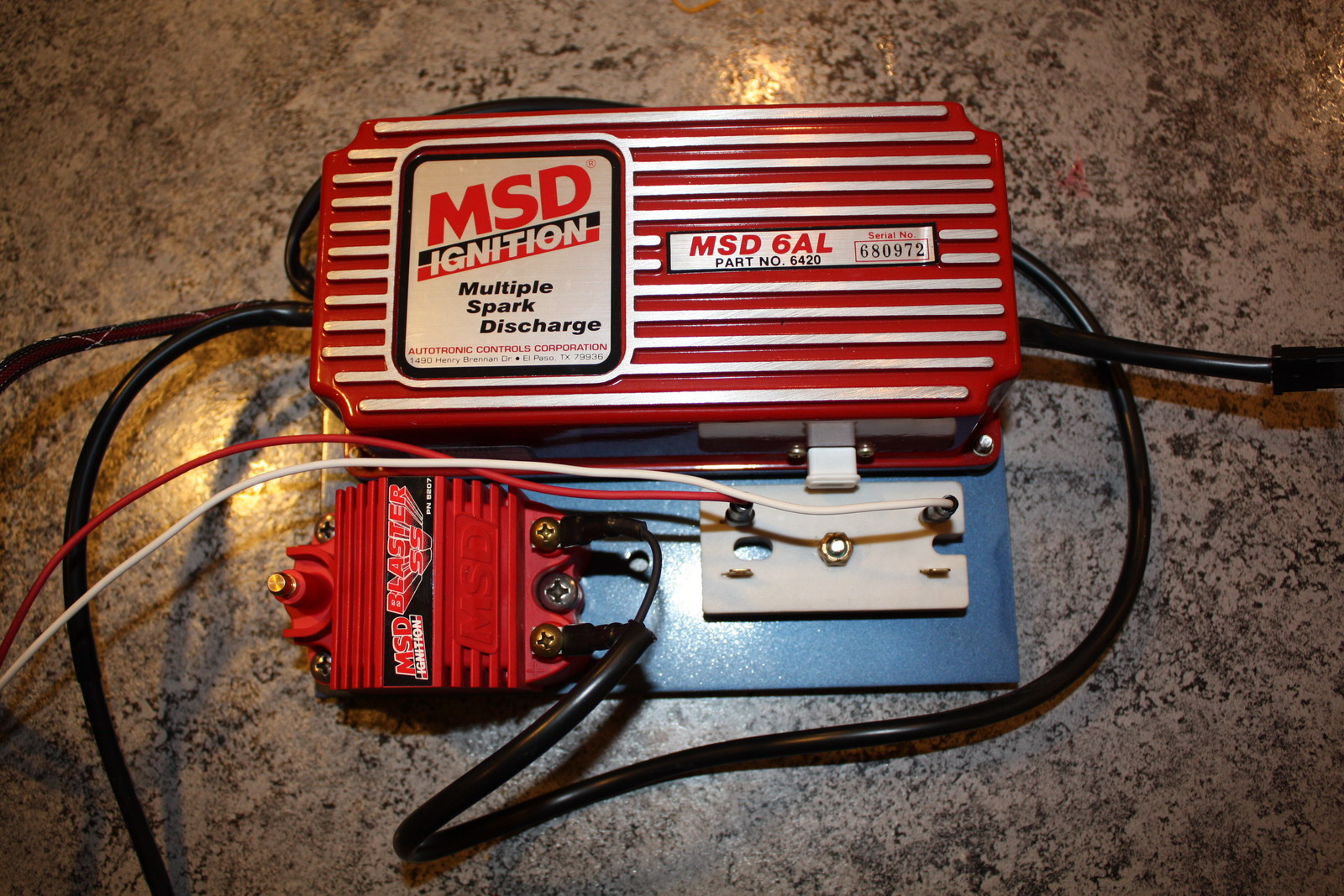

Close - try this one from Autoshepherd instead
This is a picture of it with the MSD 6AL I'm running on my 240Z
