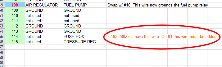

Yes I have the write up and the Zip file. Thanks again for that I wouldn't have been able to do it with out it. My car is a 82 280zxt and harness is stock. That's why I was confused by the Zip drive says "not used" on the 82-83 harness but "fuse block" on the Z31 harness. But after looking at my car again pin 114 is hooked up and has constant 12v power.
Maybe I gave you an old version? I thought I had updated this a long time ago...
