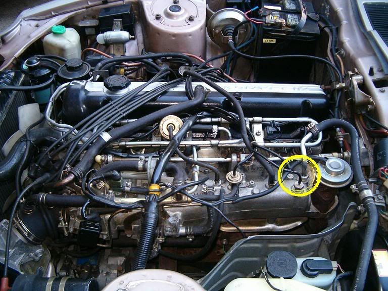

any pictures or sites that i can go to see what hose goes where,none of my books show a clear picture.Jim

It wont let me repost this pic but here is a link to the picture of the engine bay on my '83 ZX. https://www.zdriver.com/forum/attach...achmentid=1640

bleachzee i have a 83 l28e non turbo. lines from vaccum pump to the manifold,and 2 hoses coming out of fire wall. basically the hoses from where the battery is located.thank

100 thank yous bleachzee,if i could only see where the 2 hoses coming of the firewall goes. jim

ok the ones by your battery are your vaccum control for heat/ac and etc.

sir that picture attachment was a great help,however ineed to know or see a close up picture of 2 small hoses coming through the firewall(by the battery) where do they go, also whitch hoses go to the vaccum tank. once again 100 thank yous for your help. thanks to bleachzee and heatrave. Jim

dothedrew great help,but i still need to know where the 2 small hoses coming through the firewall(below battery and a little to front) the picture doesnt show them. any help please, also the where do the hoses from the vaccum tank go?. jim

I believe the lines you are talking about are coolant lines that run along the side of the engine. There is a small metal fitting that sticks off the side of the engine just below the spark plugs near the firewall that they connect to. Are those the lines you are talking about?

no sir they are 2 small rubber hoses next to the metal lines. jim

skully iam sorry for beating this to death but i believe them 2 rubber hoses coming through firewall (they connect to the a/c and heater control panel on the dash) and goes to the vaccum tank (located under the engine night light) which the picture does not show the vaccum tank. jim

Ok, I just looked. I found one line coming out of the passenger side of the firewall. It ran to the vacuum tank and connected to the thing with the yellow cap on it (the connection to the left and slightly lower). I hope that helps.
thats it,god bless for you taking the time to help me. jim
