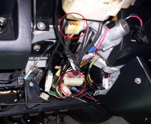

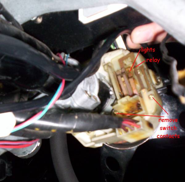

You can see the power wire is nice and burnt. That might just be from the years of use or maybe the lights have been flickering and I haven't noticed.
The two contacts on the right both move with the first turn of the light switch to the running light position. One of them may not make good contact and therefore the lights will not come on. You can unscrew the back part of the switch and clean it up and/or bend the tabs slightly to make better contact... slightly!
