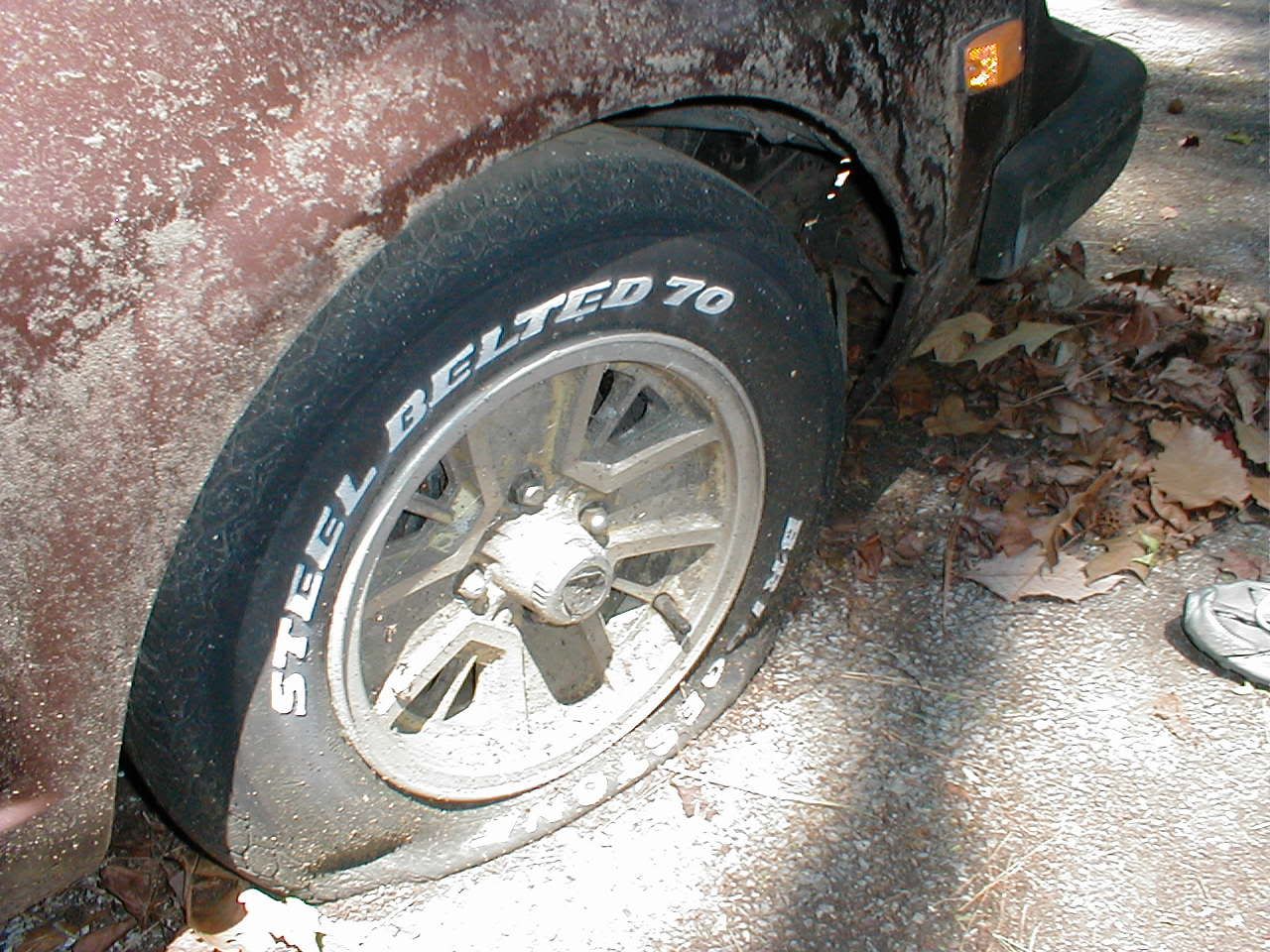

Anyway, went down with anticipations of draining the fuel tank, oil, power steering, coolant, and brake fluid; in addition to replacing the tires and a good strong washup.

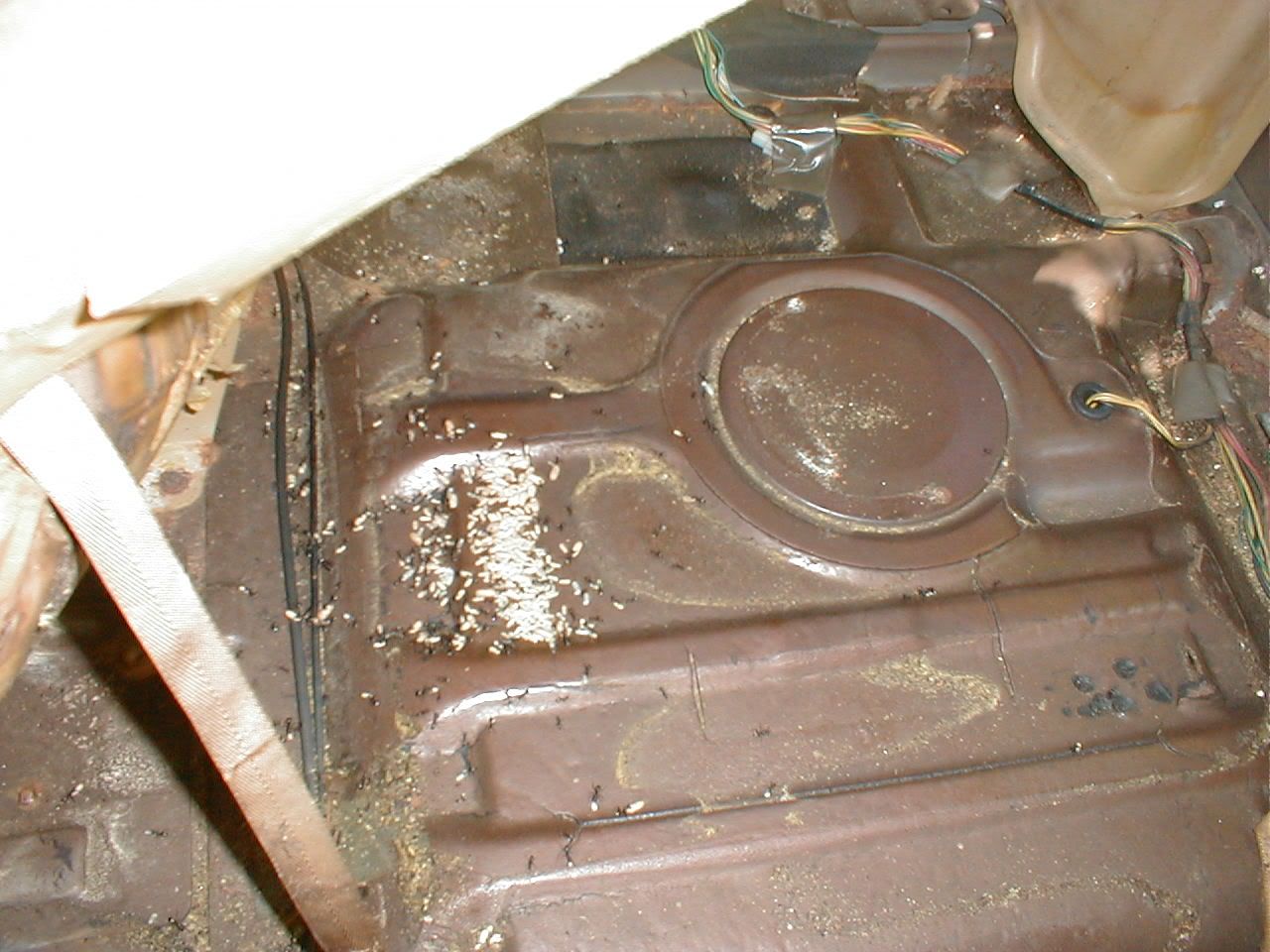

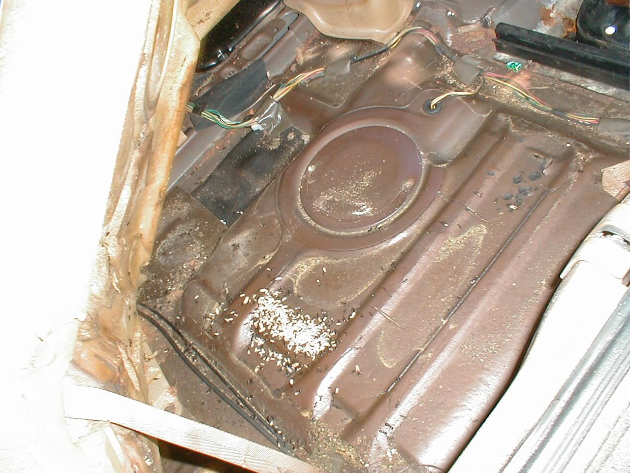

Went to check the fuel tank access, and was stratled by a black swarm. The friggin Brazilian/Army ants moved in. Jesus, there were a few hundred of the buggers. Note the Larvae. =(
A can of Bengal/RAID took care of most of them, and the foam covering (partially rotted out) is on the passenger seat, (antfree, ATM) and the ants I saw were all dead. I need to check next time I have a free day.

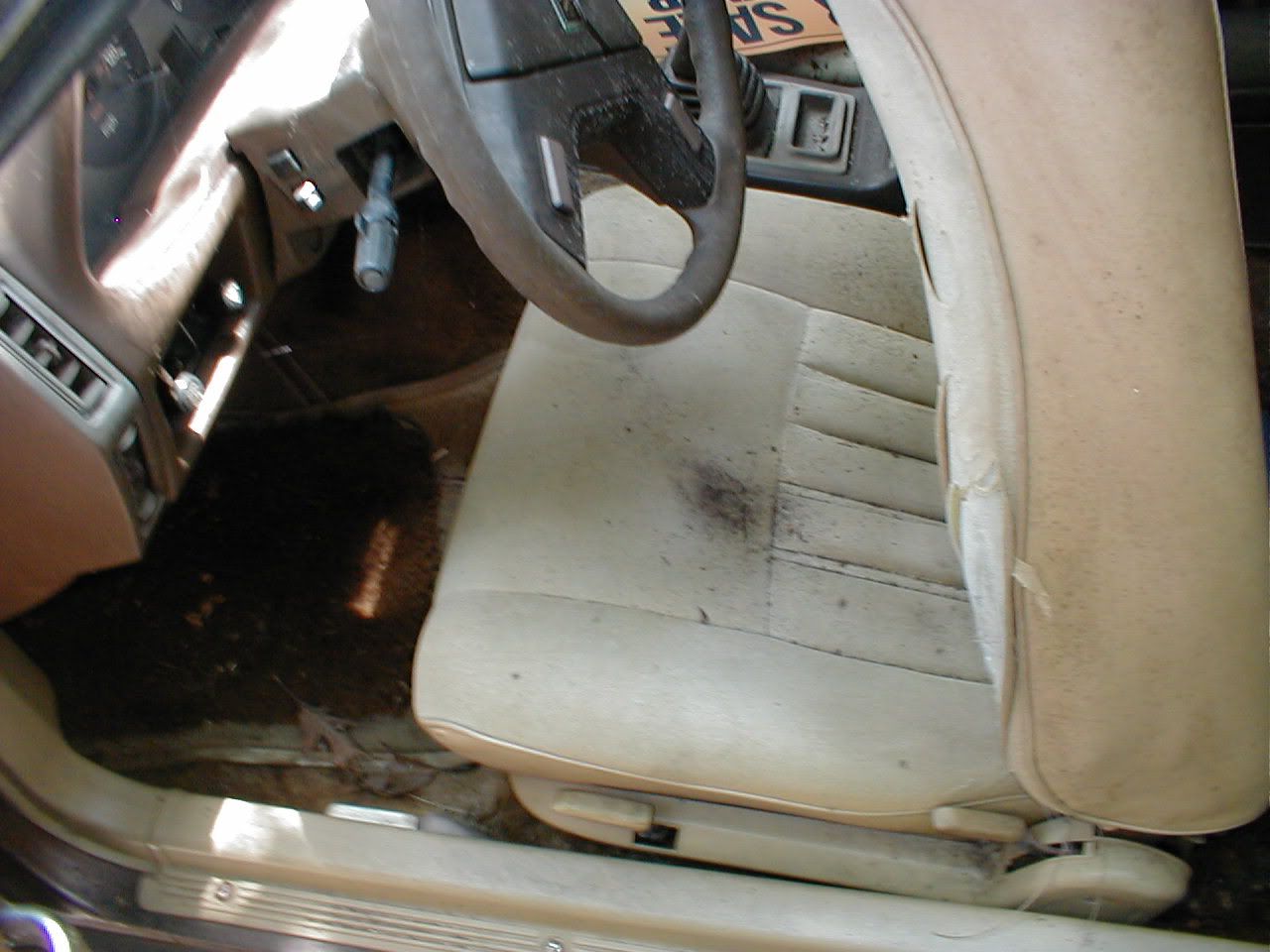

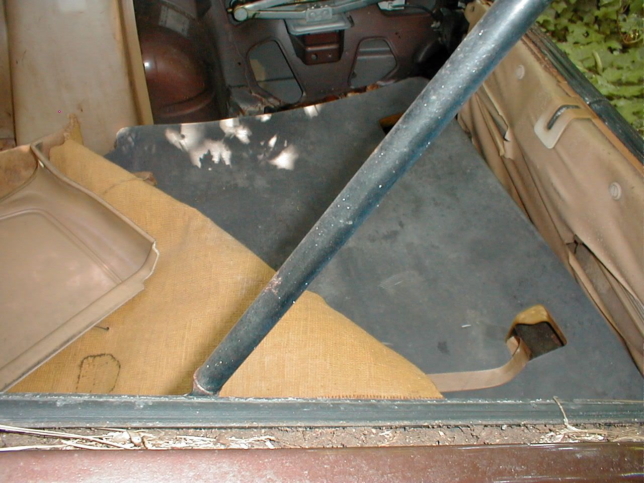

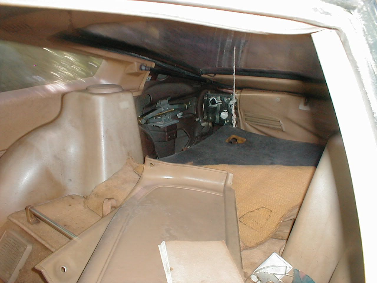

Definately going to need some new carpets. =(
The seats have a bit of rotted headliner in em. Needs a thorough vaccum/steam cleaning.

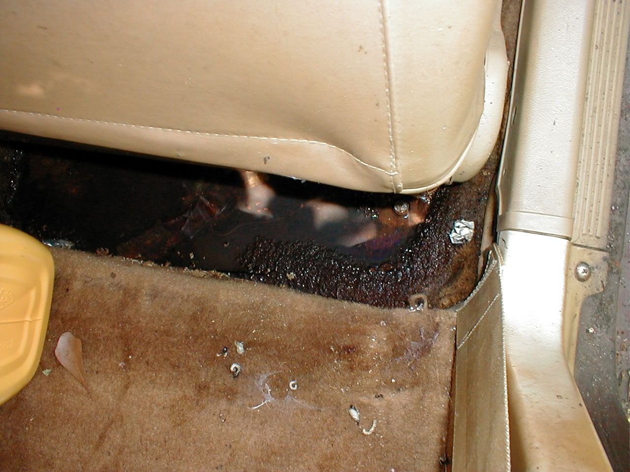

The only leak I found. Probably the passenger window. =( Any suggestions?

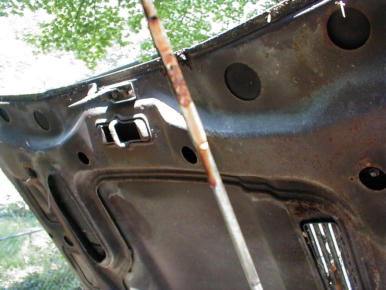

Couple of rust spots underhood, nothing special.

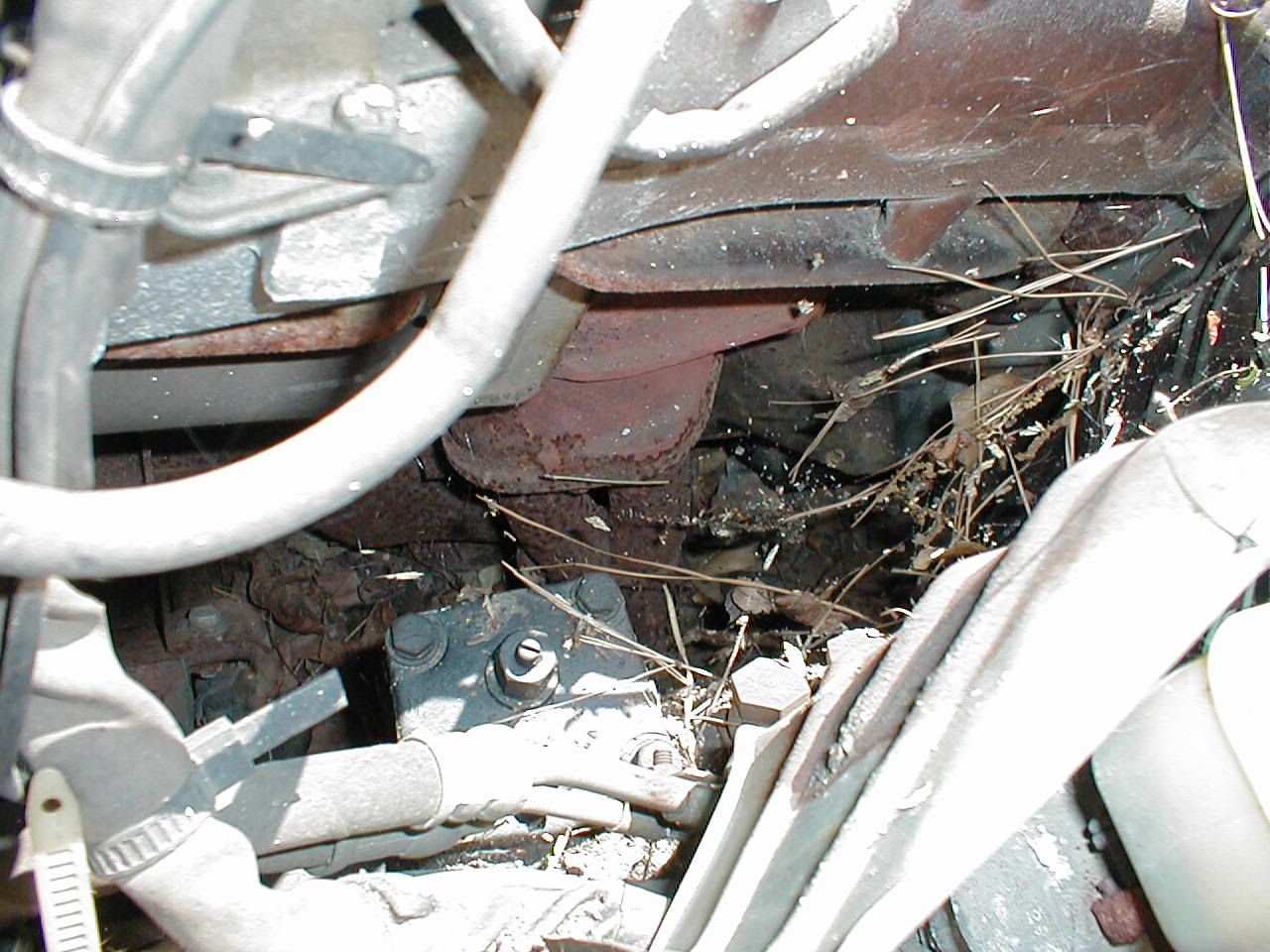

Looks like some shiny headers would go nicely there. Are there any noticable rust spots that I didn't see (that looks normal for a old header, correct?

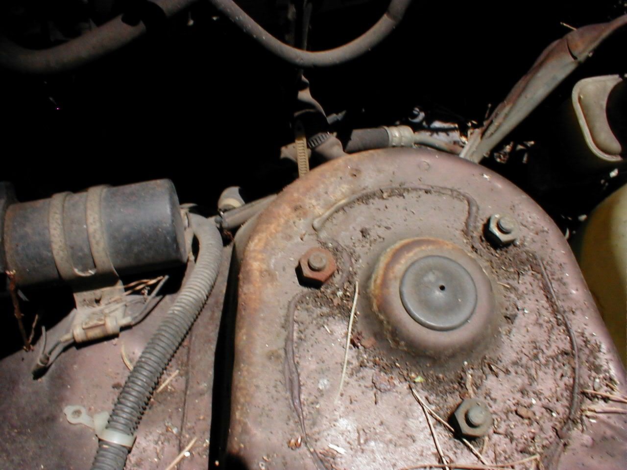

Yeah, both sides have spotted rust on the strut towers. Problem?

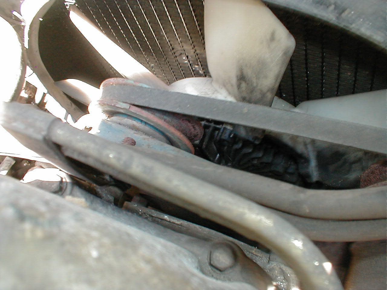

Pulleys have a light coating of rust. Seems to be the bane of 280's, eh?
PB blaster and a good wire bursh should fix this, or what?
Belt is tight, but dry. Not worn or cracked at all, so it'll work, but not forever.

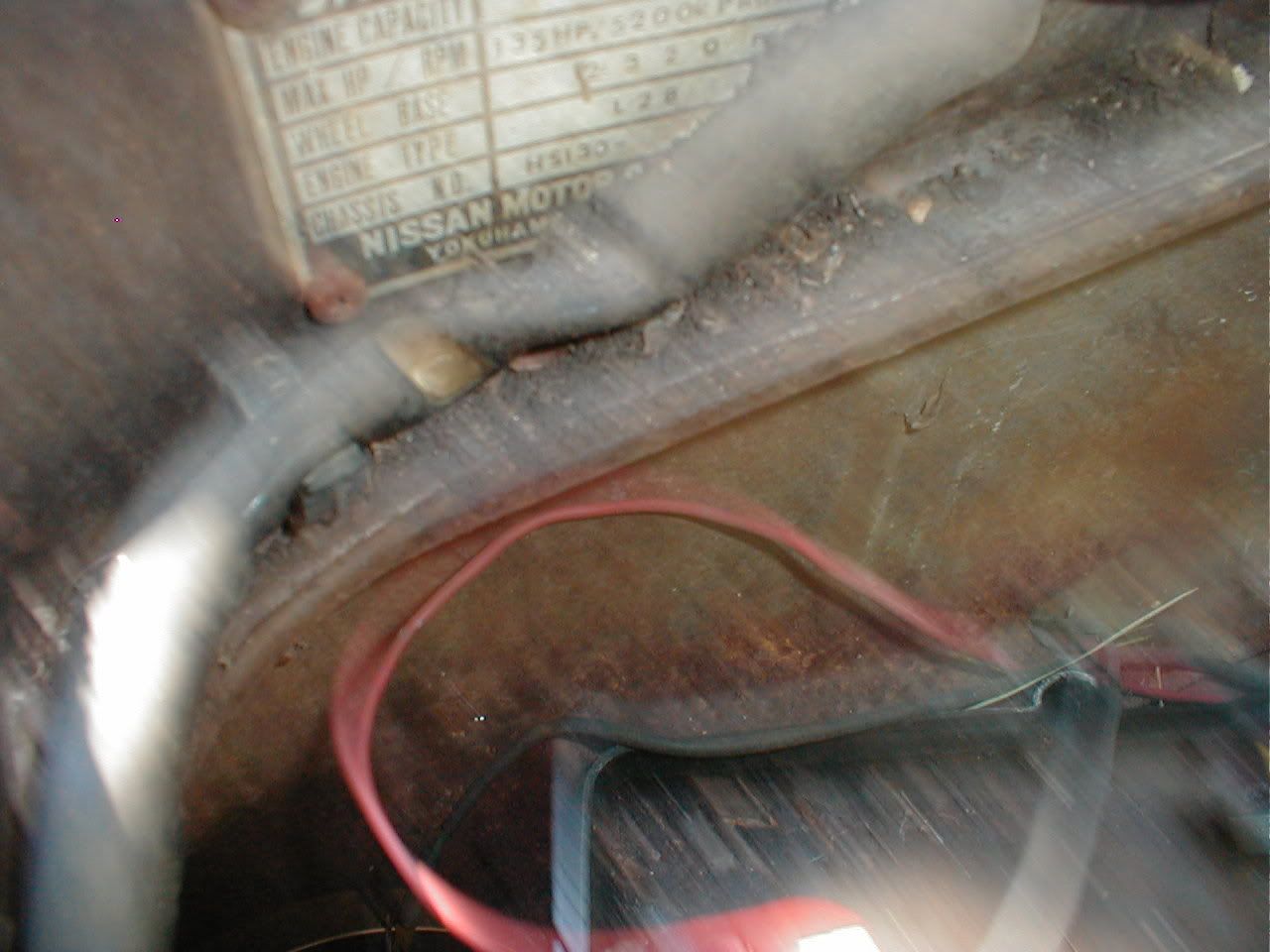

135 HP, with a dab of torque. Civics can't touch this.

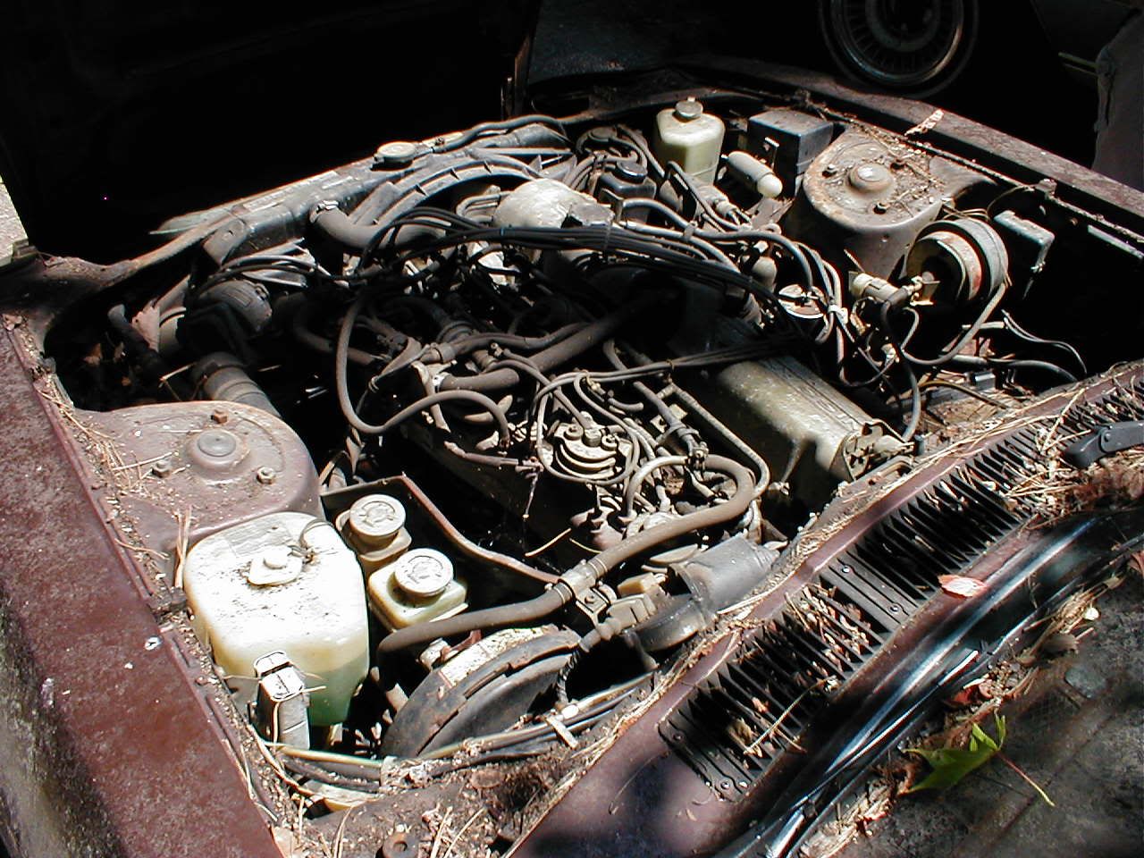

The whole thing. Got a rake, anyone? Or anyone to tell me where to look for the head identification? A guy on TDF says he's got a head off an 80 Z, and will sell it for a fair price. (cheaper than machining a valve?)

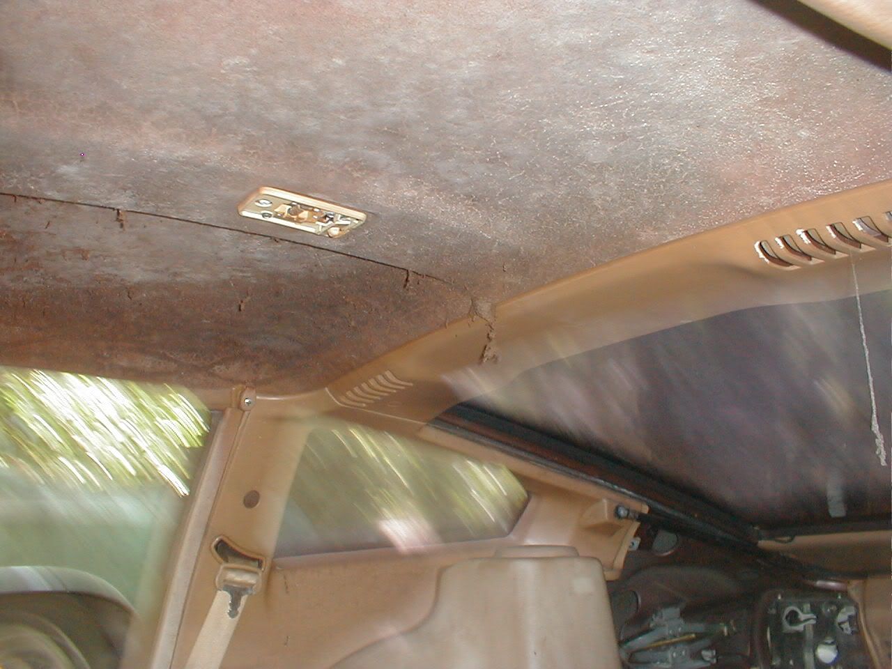

Should I blame age, ants or the humidity for the disentigrated headliner? Anyone else seen this problem?

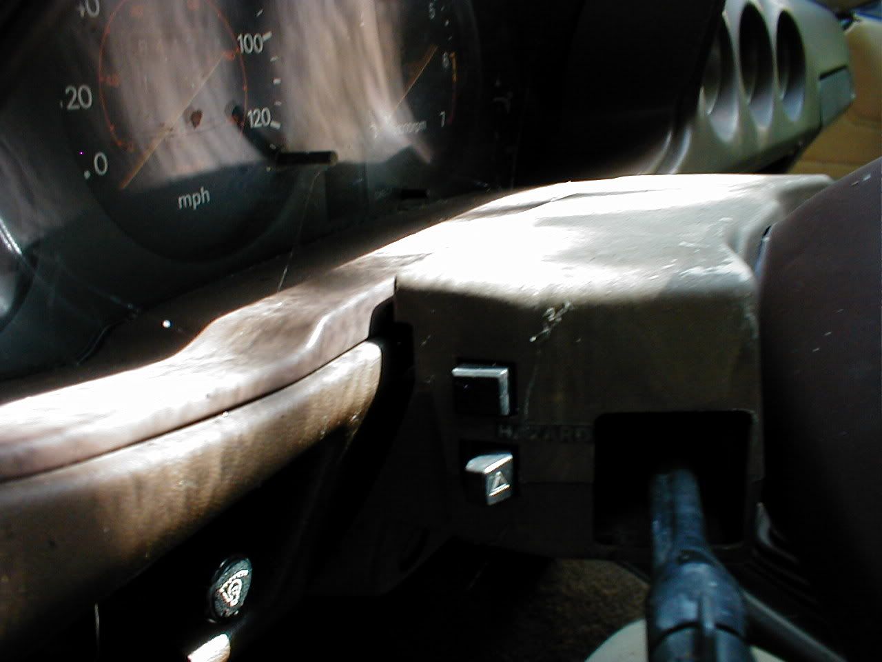

This item should be used sparingly.
Anyone want it, i'll sell it cheap. :rofl
I laughed because it actually says "HAZARDS"

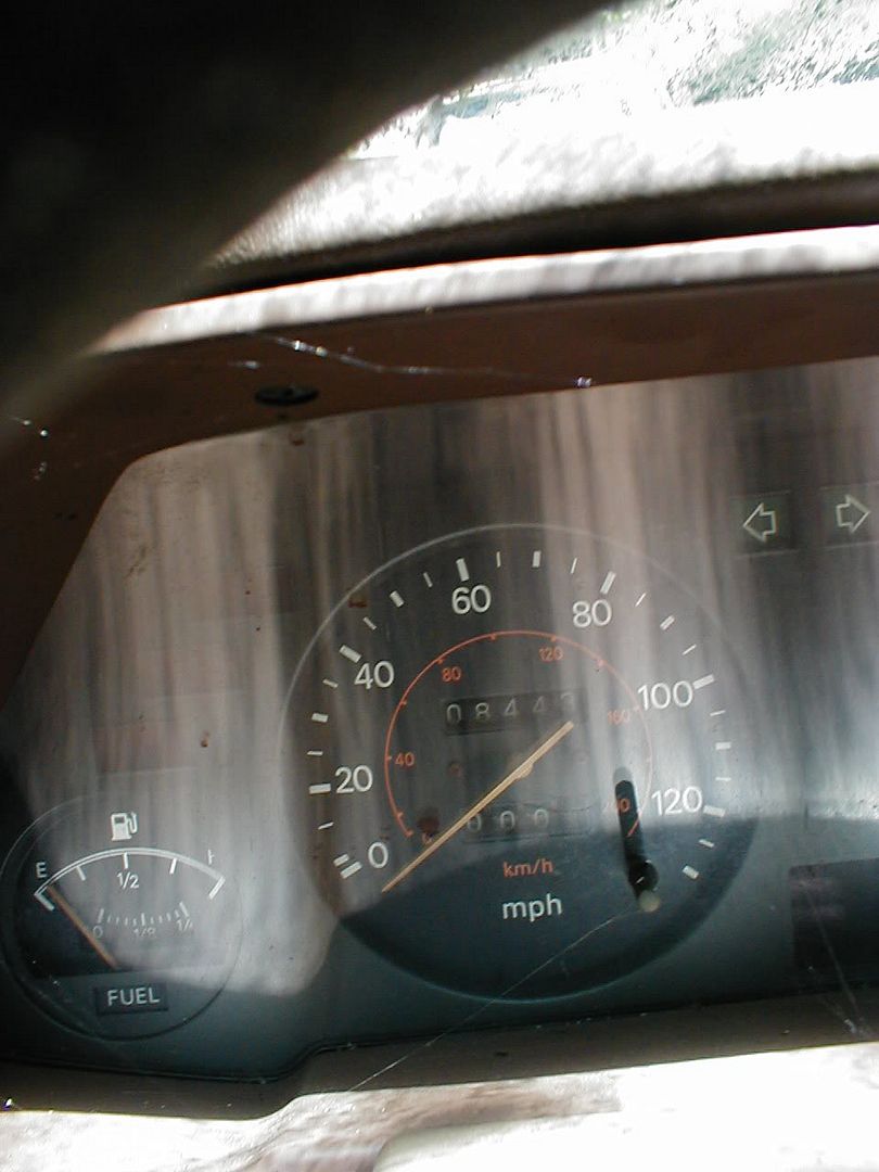

LOW MILAGE, WILL SELL CHEAP, MUST GO FAST!
Naw. My stepdad says it should be under 100k. I'm thinking he forgets, and it's at 108.4k...

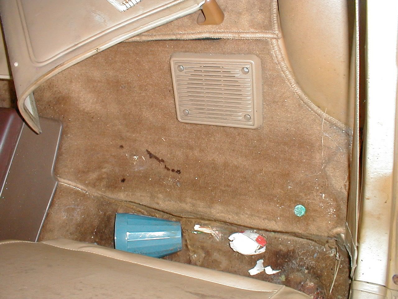

What size speakers will fit here without too much work?

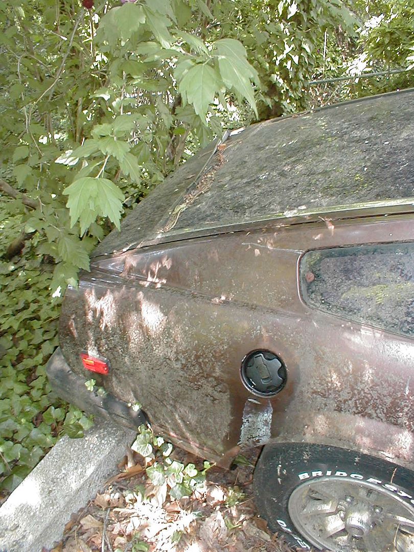

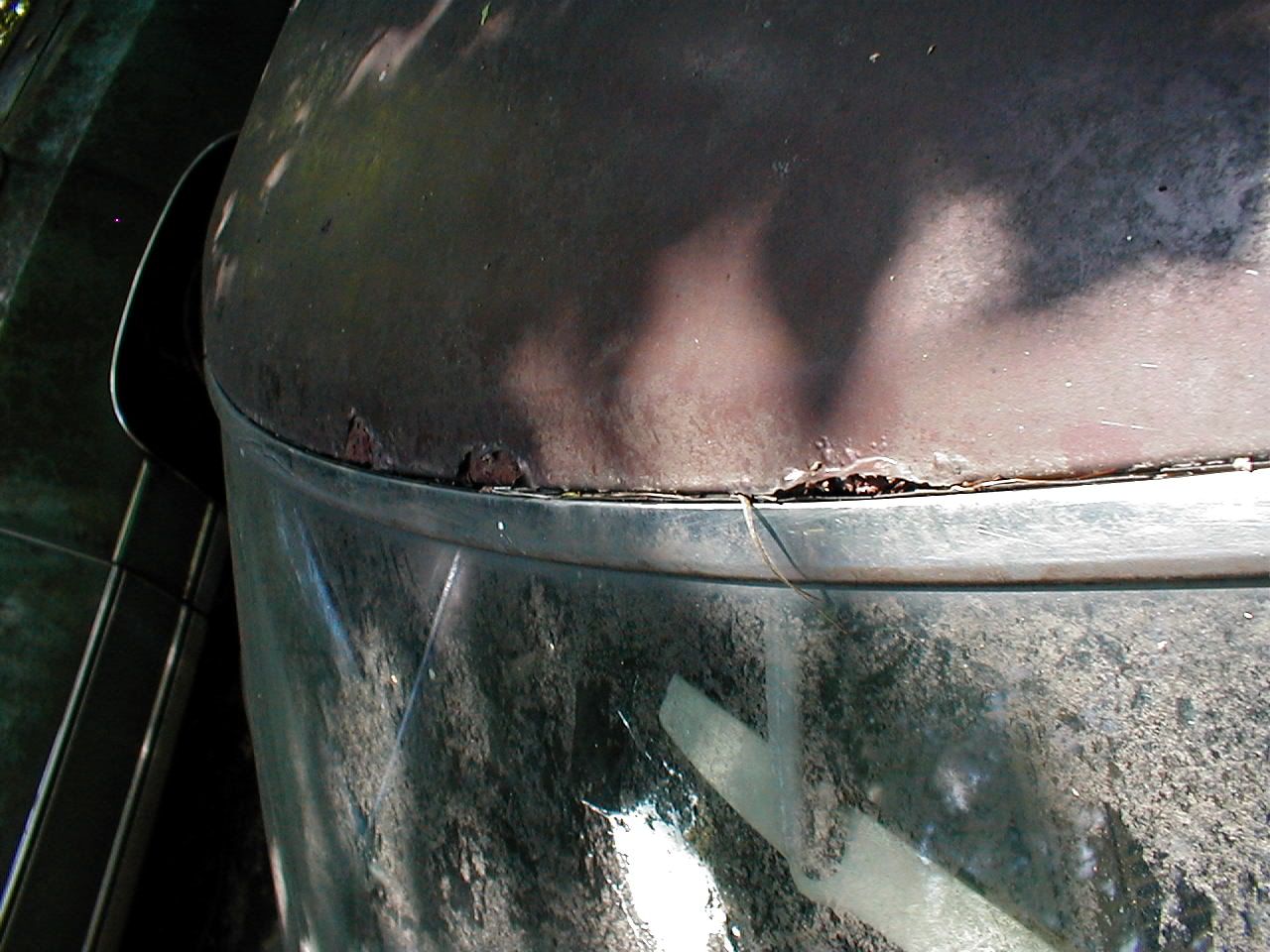

the only *obvious* Body rust. Underside..... I'm scared to look.

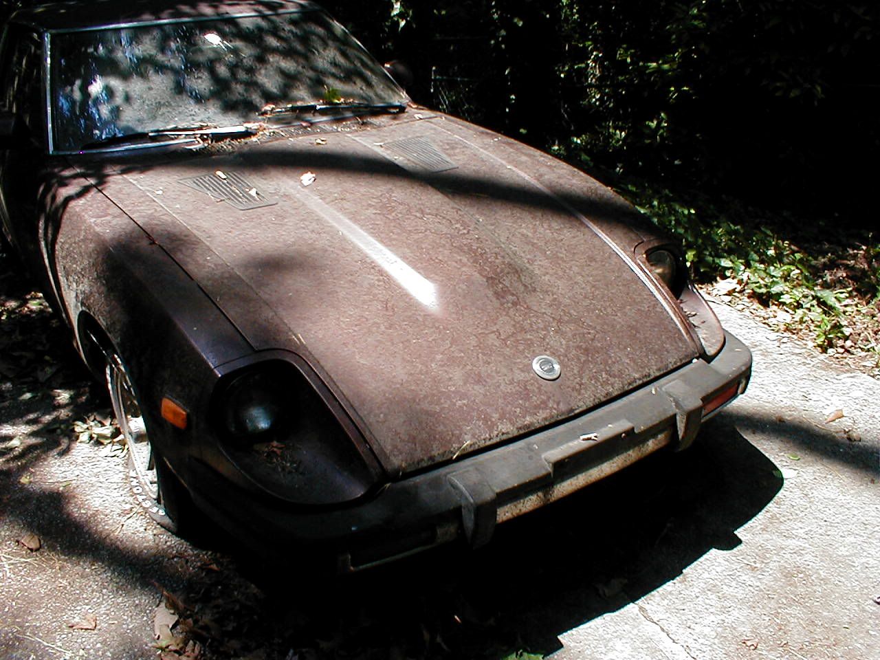

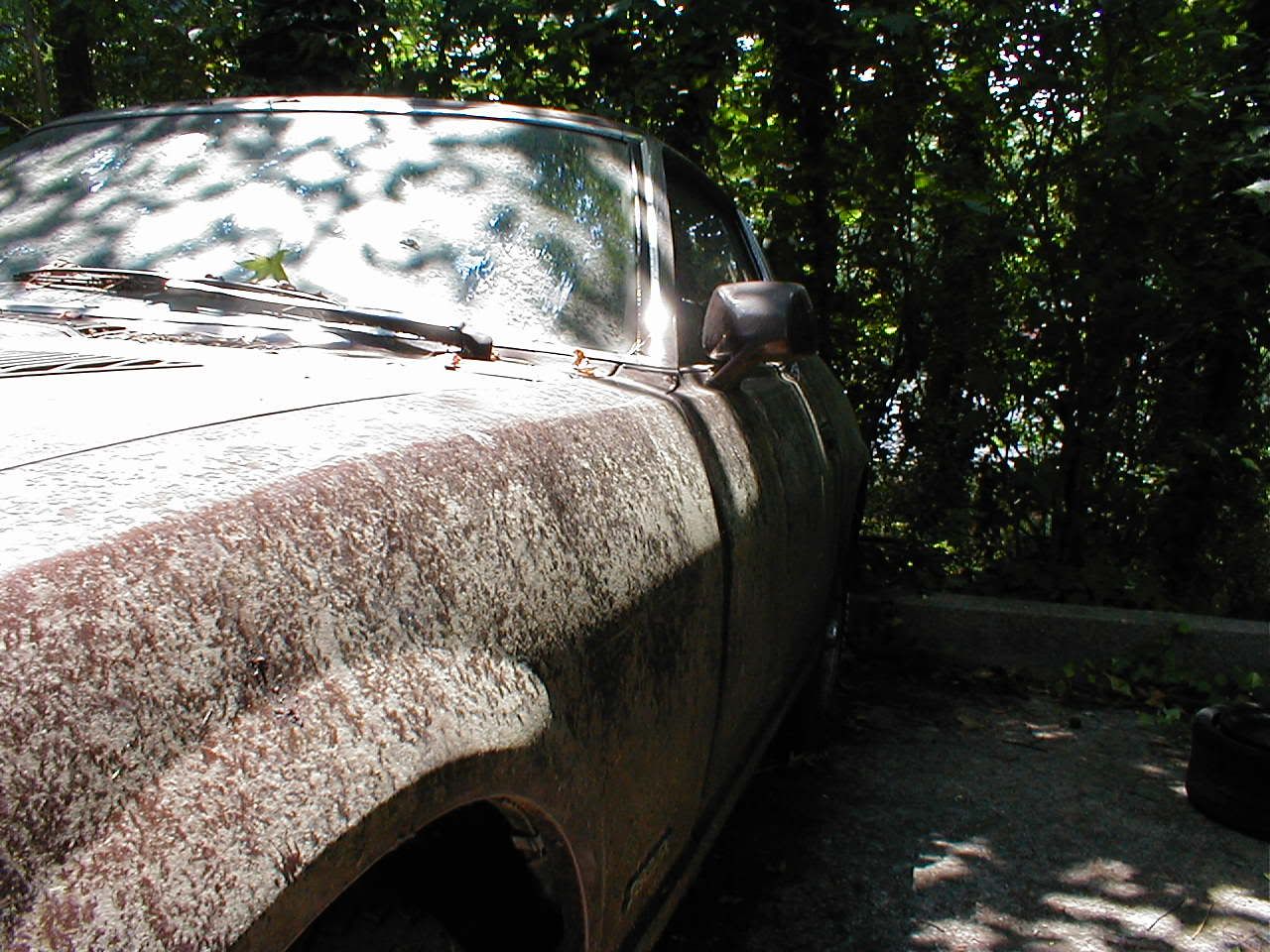

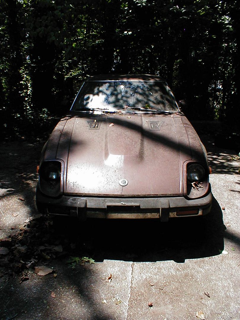

Lastly, anyone run a car wash?
This one needs some TLC on that side...

id do it, its rough, but definatly do able, how are the floors in person?
Old Jun 14, 2006 | 09:59 PM
doesnt look too bad, the rust on the roof is kinda a turndown, but if the floors are ok then go for it.

i would do it but if you arent let me know if you want to sale the 120mph speed guage. good luck and remember all 280zx's are worth it, give it a good cleaning and then i think that you will find that you will want to keep it.

Well, just from the pics I can say it will be a bit of work. That rust at the top of the windshield channel means there's probably more under the channel seal that you can't see. The water in the floor board behind the seat surprises me, but I'd say the pans are probably still intact. Otherwise it would have drained out. The windo seals are bad about leaking, but Black Dragon has all the weather stripping you could need as well as some other hard to find replacement parts. The engine will probably run with a good flush of the coolant system, oil, and fuel system. Check the tank and make sure it's not rusting out inside. The sides of the tank will flake and get into the lines and clog the filters. Pull the injectors, pump and pressure regulator and clean them inside and out. Replace the filters (don't forget to clean the screen filter in the pump inlet line), plugs, plugs wires and battery. Pull all the electrical connectors you can find and clean them with some contact cleaner and small knife point. Throw some dielectric grease in the connections for good measure. Once all that is done I'll bet it will crank and run. Might want to pour some marvel's mystery oil in the cylinders before you turn it over. Let it sit in there over night to free up any stuck rings. These cars are great and they are very simple to get running. Diagnosing the old EFI isn't all that easy, but it's a much simpler system than the new stuff. Good Luck!

The biggest thing that worries me, is the fuel gauge reads nearly empty. Sitting empty for that long, that tank is mostly rusted out and will need professional repair or replaced.
As mentioned previously, the rust at the top of the window seal usually indicates severe rust under the trim/seal.

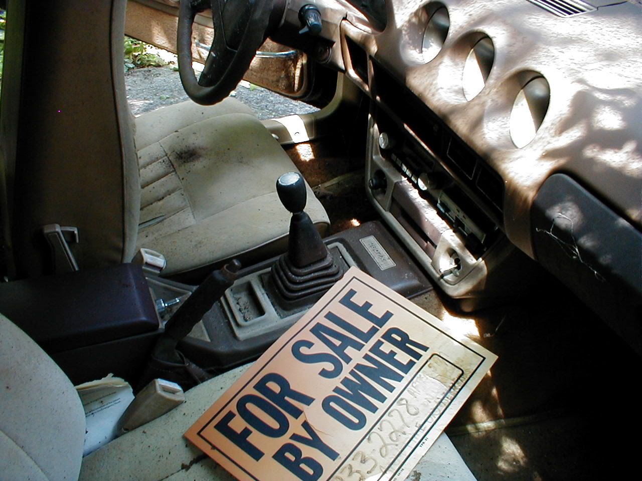

Bump. This is for sale. I've got a guy offering me 500$ for it right now.
Will include a cheap car cover.
Just fishing right now.
