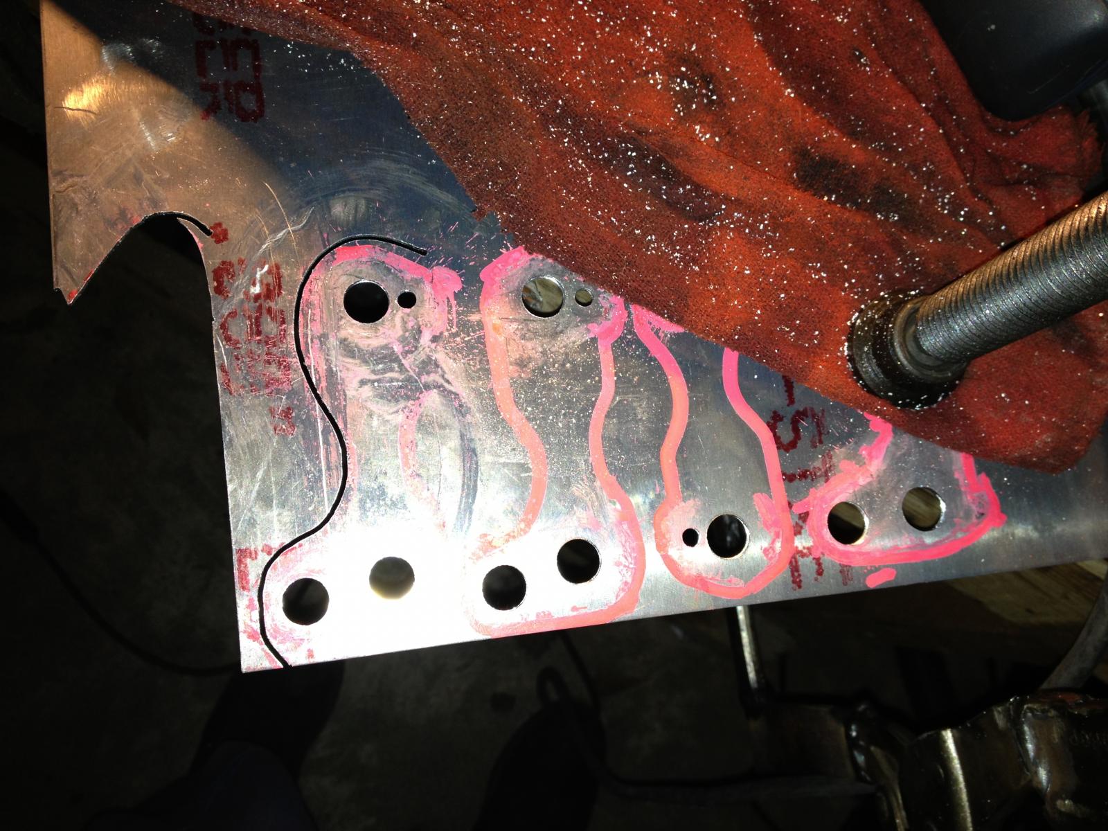

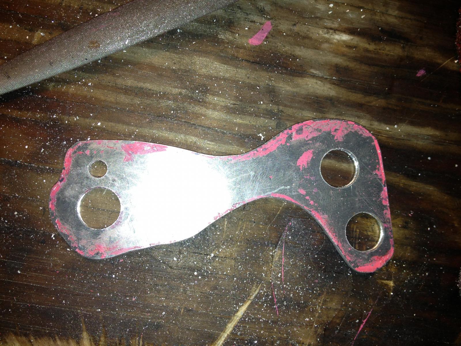

Basically the route i went was shave the head .080 this equaled 44-43 cc per camber. i then bought the Schneider spring kit from MSA. mine were old and my cam is .460 lift, right at the end of stock spring spec. I kept the stock valves and i cut new 3 angle surfaces and new seat angles. So now we have the issue of how do i shim the cam? where do i get the shims? well you can buy them from Derek at hybridz from like 100$? or make your own by hand for 30$ and 2 hrs. Then I bought large lashpads my cam recommended .180 (stock being .160) + the .080 that was shaved= .260. the Schneider spring kit cam with retainers that are deep enough to handle the .260 lashpad. the stock retainers are too shallow. With a felpro 1mm gasket and a .5mm over bore I have a 10.3:1 compression ratio. and 190 psi in each cylinder. I have not broke in the new rings yet and once broke in i except 210psi. meh build thread: https://www.zdriver.com/forums/280zx...x-build-39579/
Attached Thumbnails P79 High Compression-img_0362.jpg   P79 High Compression-img_0365.jpg
