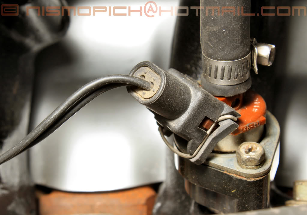

Just adding dielectric grease doesn't do anything... Dielectric grease prevents metal from corroding / oxidizing. Once the metal is corroded, it's corroded... it needs to be cleaned.
So... you can soak the injector connectors is Lime Away / CLR, or... save yourself the hassle of doing that every few years, and upgrade to quick connects (I've posted about this in other threads):

I know, didn't have anything to clean them with. I had actually looked at replacing the pigtails with ev1s or something similar, but wasn't sure which ones I wanted, and really just cheaply wanted to clean them for now to see if it helped.
But I'm not sure that's the main problem.

Spray the connectors out with some carb cleaner to get the grease out then soak the entire connector for 5min in Tarnex, blast them out with compressed air and spray WD-40 inside them. All done! I've found that to be the best way to clean them out.

Pcv valve was seized. Also found one ground wire I missed that was corroded. A few of the injector clips are in poor shape, had to re-bend one and clean all the connections, that solved the problem!
Since I have to replace the pigtails anyways, is there a good swap for injectors? Maybe out of a supra, or something along those lines that I could find in the junkyard.
Or should I just go with the stockies and ev1s?

I know that, I am getting the quick disconnects...
found some info here.
http://atlanticz.ca/zclub/techtips/injectors/
the audi clips look nice, wonder if i can find any at pull a part.
Looks like I'm going to have to pull the injectors to clean the contacts in them.
Thanks guys.

I redid mine using the GM clips. They fit good, look good, and make life so much easier. For the 1 dollar entrance fee to the yard, I walked up with a hand full of wires and they said 'your good.' 10 connectors w/ plenty of wire for a dollar!
The Audi clips look nice, but would that rubber 'boot' cause fitment issues with the fuel rail? Just curious...
