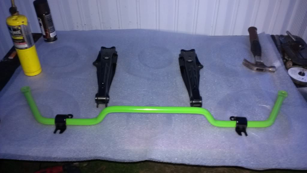

next problem. i got all the struts/shocks, sway bar bushings/endlinks, both out tie rods, driver side inner replaced. I cannot get the pass inner out of the center link. I don't want to remove it(center link) because its still pretty decent but I am thinking I will have to. The problem is I cant find one for less than $250. Next I was thinking of swapping to rack and pinion but then i would have wasted money on all 4 tie rods and sleeves. so I am not sure what to do. will my 81 turbo rack and associated parts work on mine. both cars do have power steering.
