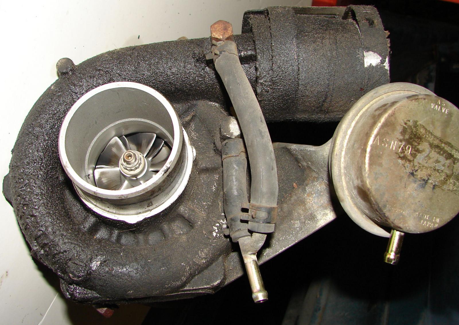

After I got home from work today, I decide to dive into taking the old leaky turbo out and put the rebuilt one in. The guy I bought it from started to do this and lucky for me he labeled everything. I started poking around to see what he had already taken off and what I needed to take off. It appears to be that I only need to unbolt the turbo from the exhaust mani. I started to unbolt it, I got one and was have trouble with the others. I brought over the rebuilt turbo to compare where the bolts are to see if I can firgure out an easier way to unbolt them. That is when I notice the turbos aren't the same.
What kind of turbos do I have?
It looks like the rebuilt one will not fit in the car, it also looks smaller.
Also is this a stock down pipe?
Thanks for the help guys.
Old Feb 23, 2009 | 04:10 PM
How about more, and better pics of the spare turbocharger? What are the markings on the spare turbo's compressor housing? It looks like a Saab or Audi turbo... clocked different, diff downpipe, diff wastegate...
And yes... that is the stock downpipe.

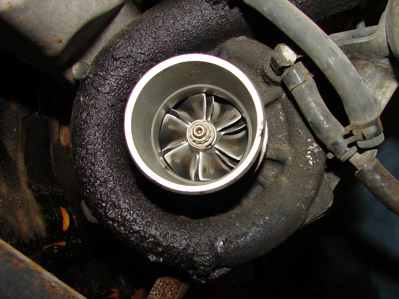

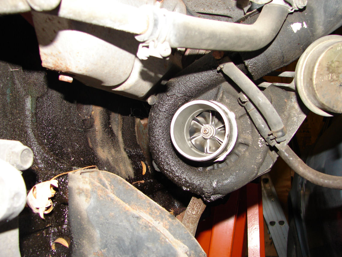

Here are some pics
The pic below says " 063 (on top) 4 602
I tried 063 4 602 on Garrett's site and googled it and came up with nothing.
Old Feb 23, 2009 | 07:09 PM
So is the spare smaller than your stock one? They actually look the same, just that someone reclocked the spare. I was thinking maybe it's from a Z31T... but those are all water cooled.
Old Feb 23, 2009 | 09:19 PM
I looked through some of my turbocharger pics to compare... I'm pretty sure that spare you have is a stock turbo, but it's been reclocked & has a custom downpipe. You can reclock it by taking off the wastegate bracket, loosen the other bolts around the edge, & rotate the compressor housing to match your other one.
EDIT... oh, and you have an adjustable wastegate rod. That means you can manually adjust your boost.

That's a non-water cooled turbo from an early Z31 but someone put the wastegate housing from a 280zx turbo on it.
At least that's what it looks like.
Should just require a re-clocking and undo the 4 bolts for the elbow and put yours on...........and put your wastegate actuator on it.
