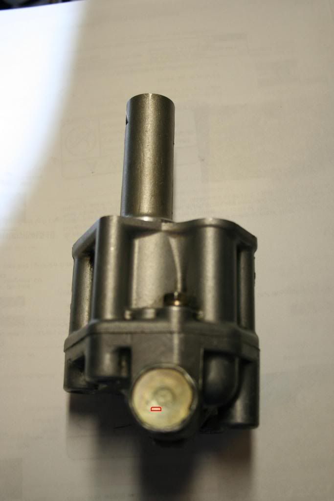

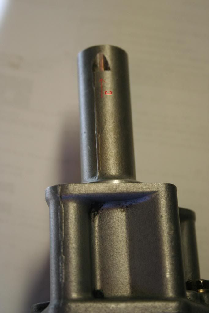

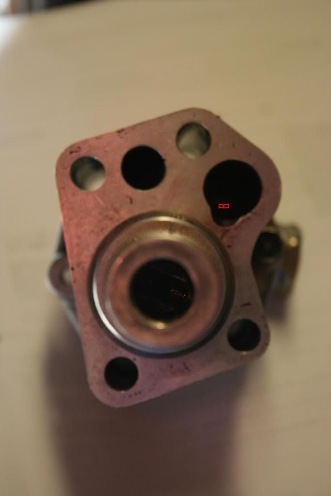

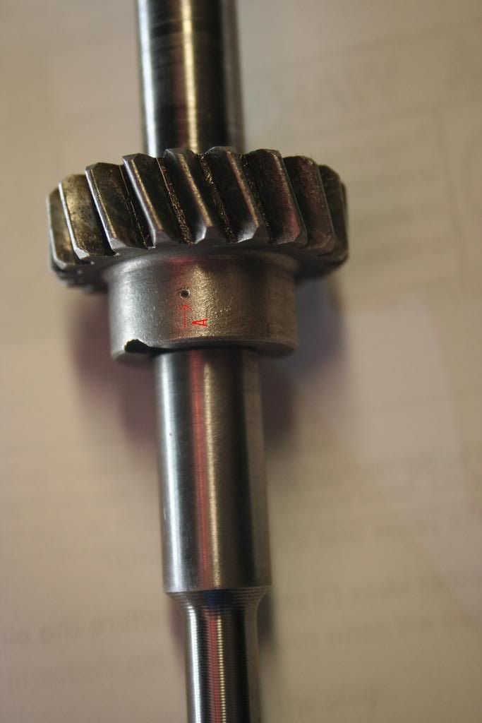

you line up the little dot on the shaft with the big DIP in teh oil pump and install with teh oil pump nozzle looking thing pointing towards the rear of teh car. you might want to check it, mine was wrong and was teh biggest problem with my car.
A should line up with B, and D should be pointed at the rear of the car?
Thanks,
wgc_3
no no no... line up A with C
D points towards teh rear of the car. i think, yeah im pretty sure. lol, youll see teh holes any ways when you under there.
Thanks bro!

well what did you do? right now im actually pulling my oil pump and shaft AGAIN.... so maybe ill snap some pics for you. you dont have the distributor mounted backwards do you?

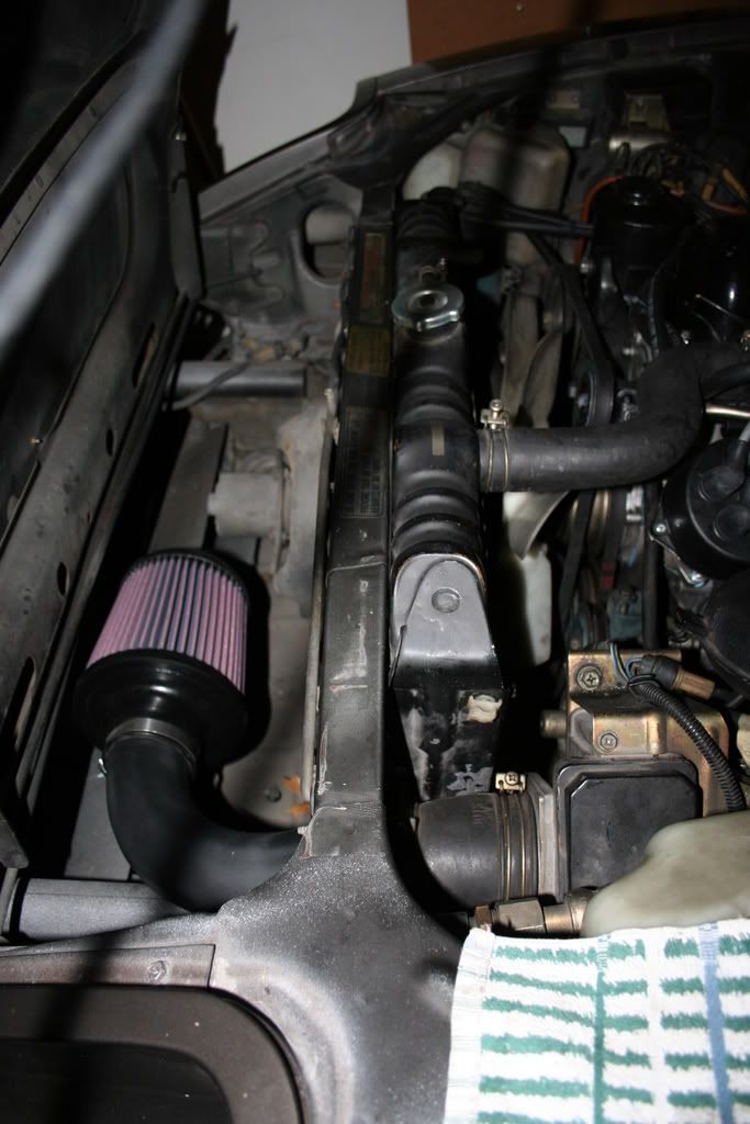

Go over some of your connections, make sure the AFM is plugged in, I saw Apollo mention that he had a problem with his car and it was just because the AFM was hooked up backwards. Make sure your air regulator and lines are all hooked up.

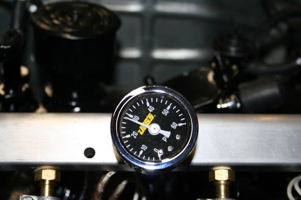

Fuel pump is not a problem I get about 28-32 psi.

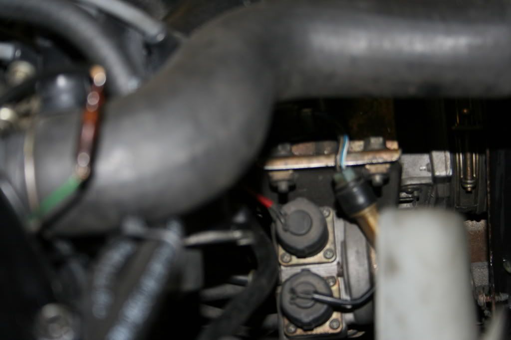

I'll take pics to see if yall see anything.
Ok so went outside to make sure there was a spark and there is, to make sure the fuel was getting a current and it was.
Two things changed now that I recranked it over.
A) The exhausts faintly smells of fuel
B) One time after I tried turning it over I heard a poof not a backfire but a poof
Also, when I trun the dis. the computer sounds like its rethinking I hear this sound like you hear a desktop when it is trying to load.

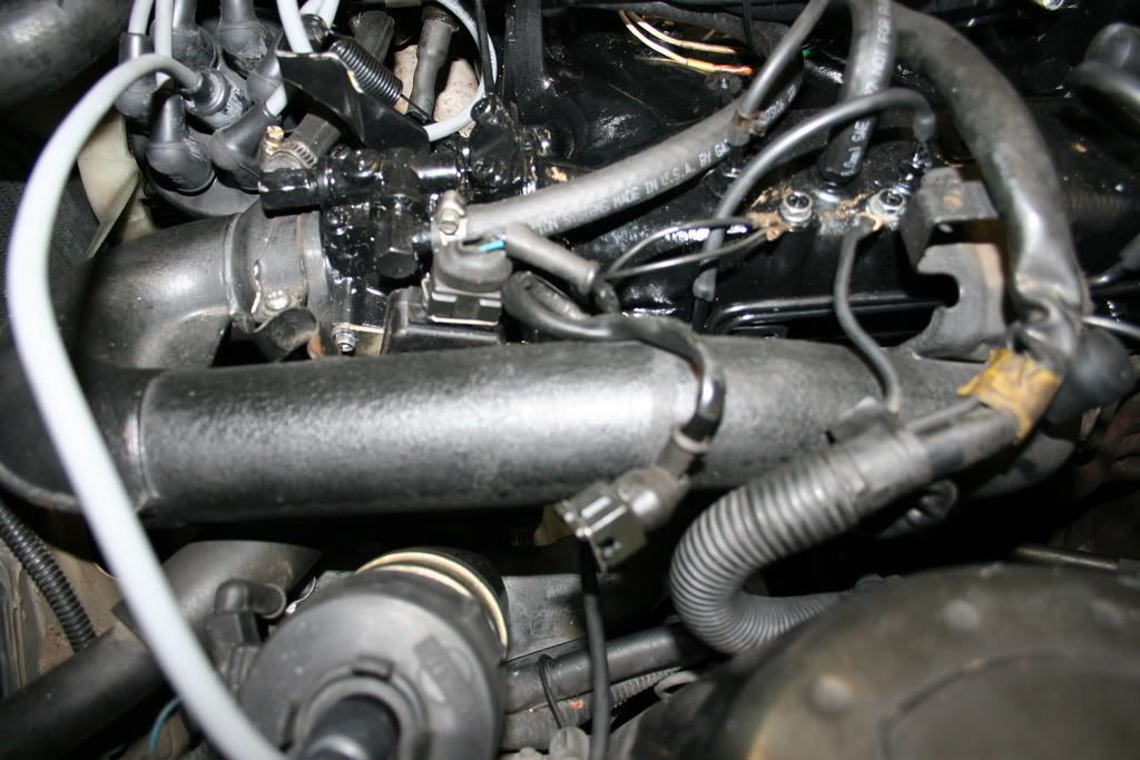

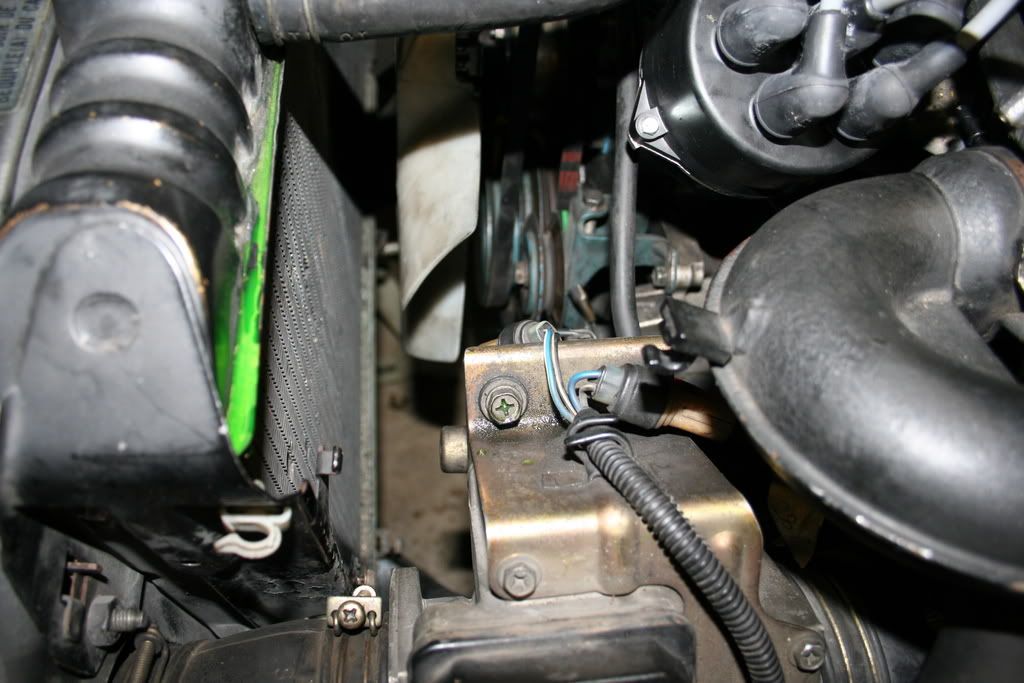

The only thing not connected went to the pipes on top of the manafold which is what I told wasn't needed.
Have a look.
thanks,
wgc_3

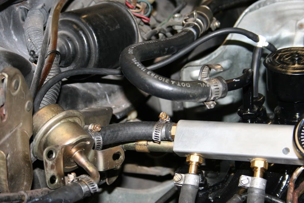

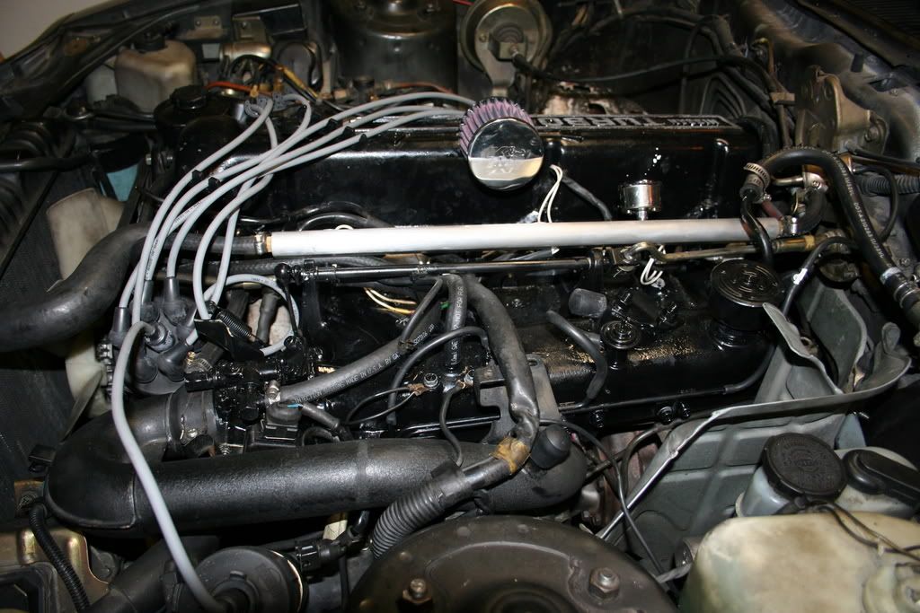

I'm not going to claim to have found your problem, but I may have found a big part of your problem. It looks like you have no air regulator.
Here's a shot of my intake although it's currently off the car.
Here's yours:
If you notice I have an upper hose off my throttle body that leads to my air regulator, and this bypasses the intake for cold startups. Basically this allows extra air into the intake and increases the idle to help make the car run quicker to keep it going. It doesn't operate for long, but will make a difference. I also can't tell if you have that plugged off or not. I know that when I once disconnected the hose from the Throttle Body to the Air Regulator when testing things, my car would not even turn over. So if you don't have it plugged off you currently have a major leak that is not allowing air to even really get into the intake as it's all just coming out of that hose, which would mean the engine is trying to run purely on gas which would explain all the backfiring you got. Now if you have it plugged off, I'm not sure if it would prevent you from starting, but at a cold start you would be required to give throttle to keep it going. On my 76' my Air Regulator has taken a crap so from a cold start if I don't give it throttle my car will die. I'm not sure that this is 100% your problem, but this looks like it could be a major part of it.
As for the thing about the ECU making sounds like a desktop, I've never heard that before. I could be wrong on this, but if your ECU is making sounds like that it could mean that there's something wrong with it.
Here's yours:
