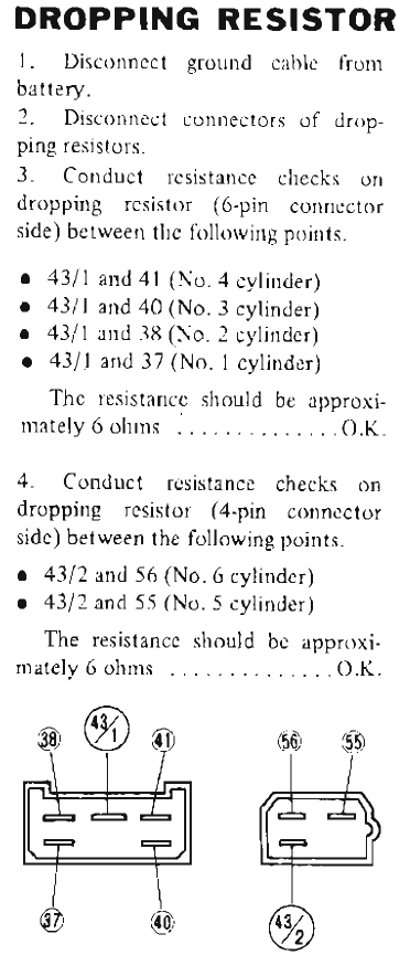

Have you checked the dropping resistors?

How do I check those? I remember coming across them during the harness install, but it seems like a strange device to me.

Unhook them and get out your ohm tester and make sure their all at 6ohms , or very close.

Old Nov 6, 2009 | 07:52 PM
I thought just the 81 L28ET used dropping resistors... his is an 83.
How the hell was I suposto know that??? I've never worked on a Turbo 280ZX lol I figure they where all the same
Old Nov 6, 2009 | 07:59 PM
Yeppers. No need to check the resistors if there aren't any.
Page 1 has 81 swap info, page 2 has 82-82 info: http://forums.hybridz.org/showthread.php?t=99620
