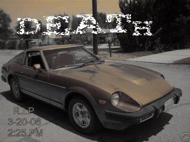

its final, my zx engine is dead.
the engine finally died on it, after some 280k miles of fun driving, she finally took her last breath and quit, so now im gonna go the the J-yard in a few weeks, hopefully get a turbo motor and breath new life into her.

Well it sucks that it happened but atleast you'll get a fresh slate with the engine. So what happened anyways?
Old Mar 30, 2006 | 03:10 PM
im keeping the bodt no matter what, its getting very rare to find a N/A slick top coupe in the origianl blue paint.
Old Mar 30, 2006 | 04:11 PM
that sucks, but as one door closes a bigger more powerfull one opens. what blew up anyway?
Old Mar 30, 2006 | 06:28 PM
the bottom end/top end, the last owner screwed up when he rebuilt the n47 head on it and forgot to torque down the cam towers, so it knocked heavily up in the RPM range, and the bottom end was just old, 280k miles took its toll.
