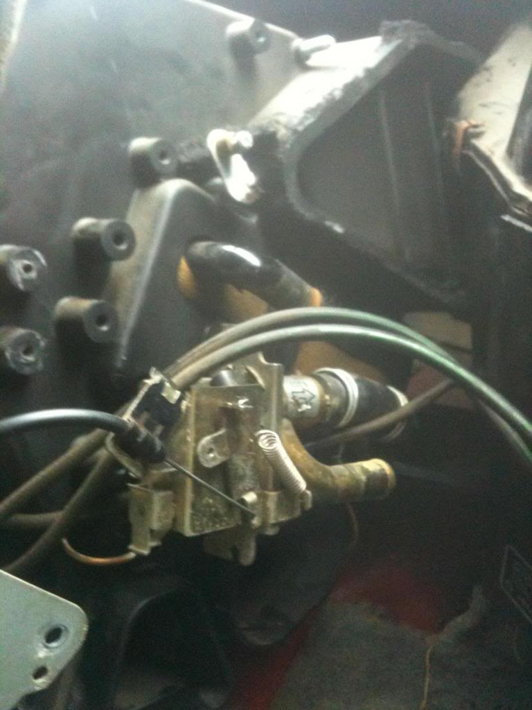

haha so im trying to have good spirits about this. im stuck installing a heater core. in fact the furthest ive gotten is pulling the dash and cross member. ive searched and searched and found something for a 79 but that just isnt helping me. SO, with that said the picture here is where im at. and what do i do next? ive read in the FSMs and owners manual. no help. am i just heater core retarted or....? thanks guys.

the boxes with the vac lines infront of them... how do i move those or take them out?
Color them with paint or other material so you know where each hose goes respectively.

I understand that, i need to know how to get the plastic box things out from behind those
Old Nov 14, 2012 | 07:24 PM
There are 10mm bolts on tabs at the firewall on the bottom of each box. I would explain more but I am Mobile Phoning right now.
Alright awesome. Thank you!!!
Old Nov 15, 2012 | 10:13 AM
That vent towards the left side of your picture is the top of the housing that holds the heater core. You can remove the whole unit and then swap cores.
I tore all of that out of a junkyard 280ZX in record time. It seemed to all makes sense when I was removing it but that was years ago.
What about the ac lines are they ok to just disconect?
Old Nov 15, 2012 | 05:09 PM
^^^ I thought you were installing a heater core?
The heater core is located in the center control box... you don't touch anything else.
Oh i figured i had to take everything on the left of it to get to it.... So that center piece just comes right out?
Old Nov 15, 2012 | 09:37 PM
Yesh.

Is it just two bolts cause i couldnt get it loose

there are 2 bolts on the transmission hump and 2 more one on each side in the middle on the firewall.

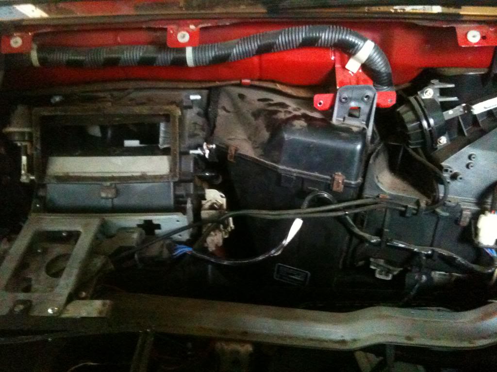

Ok so now how do i get it out of the housing. Sorry guys butbthis is a puzzle for me

this is where i am... thank you guys so much for all the help

My only queation i have left is what hoses go to the heater core. Like i said befre the previous owner disconnected the two, and looped them under the hood. How do i know what ones are what. Thanks guys
Old Nov 16, 2012 | 06:36 PM
The line coming out of the head goes to the right side, the return side (left) goes back to the water pump...
