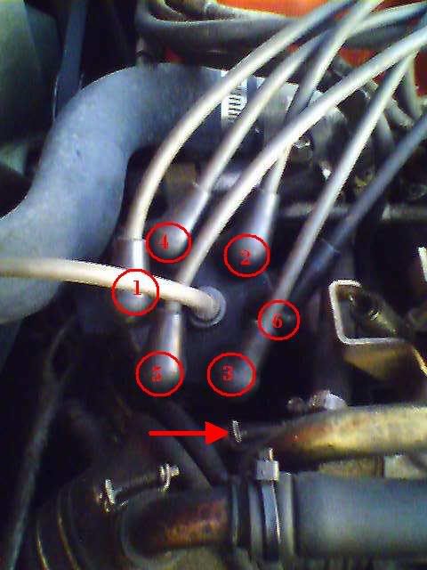

do they look like this? and is your rotor pointing at #6 in this pic?
1-5-3-6-2-4

The wires are exactly the same as that picture (1-5-3-6-2-4 anti-clockwise with #1 right above the left dizzy cap snap-on thing.)

Here are some pics of the spark wire order on the cap, the rotor orientation at TDC, and the notch on the crank pulley aligned with 0 (TDC).
