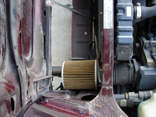

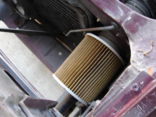

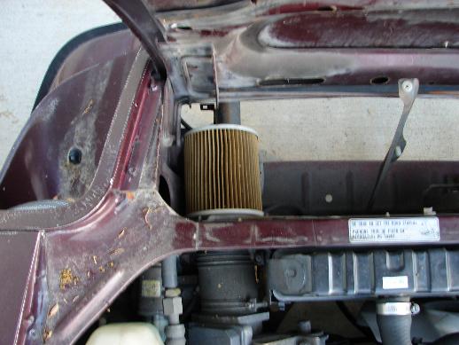

So I popped the hood on my spare turbo today... It's been a while since I've looked under thurr, I was thinkin it was a K&N filter, but it's just a FRAM. Here's the pics:
Attached Thumbnails Cheapest way to put in a K&N?-dsc00819.jpg   Cheapest way to put in a K&N?-dsc00820.jpg   Cheapest way to put in a K&N?-dsc00821.jpg

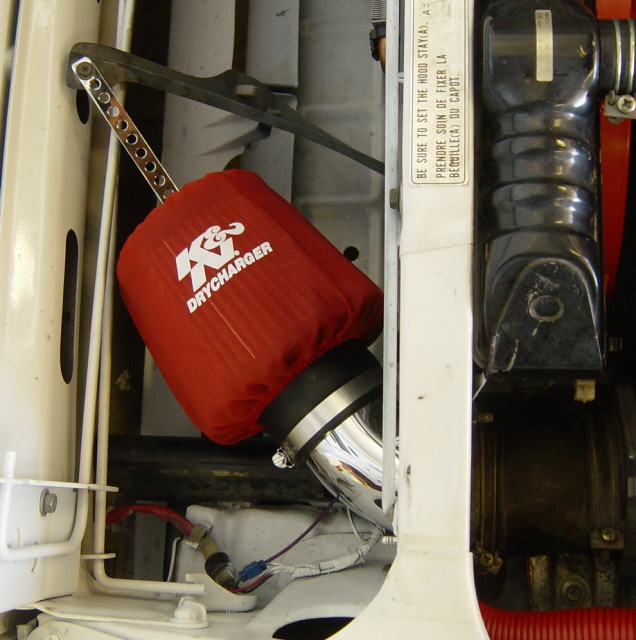

I just bought a piece of 3" 45-degree angle Spectre intake tubing for $10 (available at Pepboys, Kragen, Napa, etc) and it fit just right. My filter had a hole in the end through which to put a bolt, so I could have the end supported, which, because of the 45-degree angle, pointed it right at the old filter box bolt hole.
