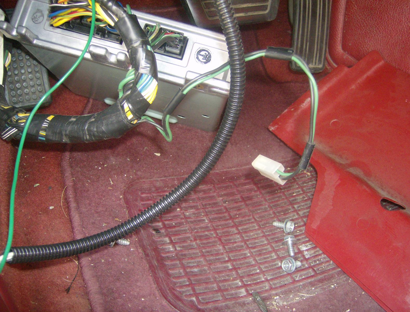

Opened ecm kick panel on 1982 280zxt and found a green wire/black wire with a white plug on the end not connected. Can anybody tell me where it goes? Thanks.

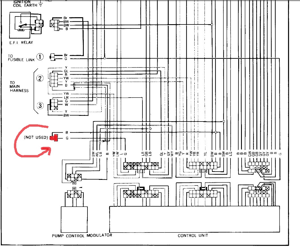

Unused
It shows it on the EFI turbo harness as an unused plug. Found it in the Turbo PDF page 1 / 5. No other reference to it (that I could find in a quick search), most likely a factory test point.
