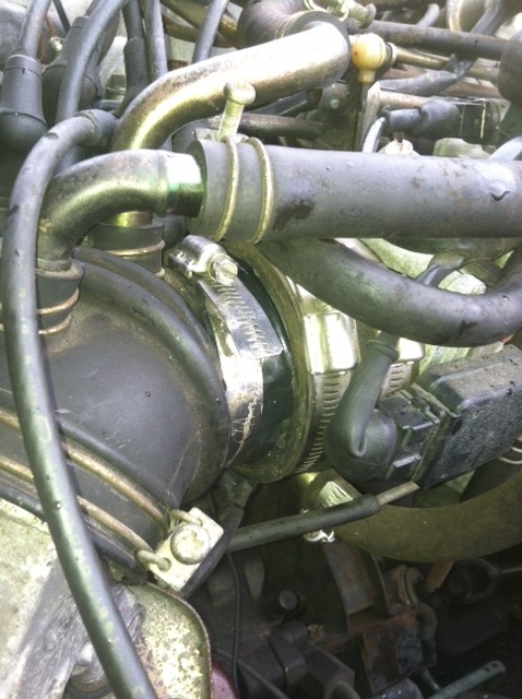

Here's a picture of the original boot re-installed.

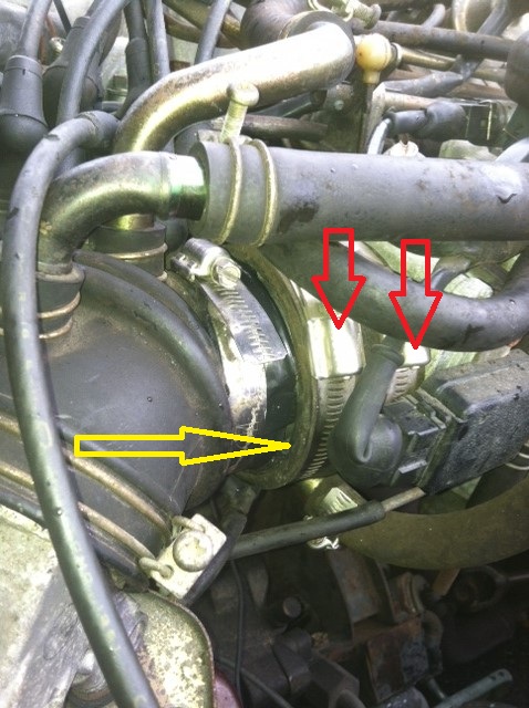

Welcome to ZDriver!
I'm seeing lots of clamps where there should only be one... It looks like there's still a boot on the throttle body (see my red arrows). Remove the boot at the yellow arrow.

Air flow booth to trottle body
Welcome to ZDriver!
Nismo, the reason he has extra clamps is that he has a Weber big troat trottle body which requires those extra clamps.So yes the stock trottle body was replaced by a Weber which requires a bigger diameter booth which was never manufactured by Nissan to accommodate the Weber T/B. That's it.

I'd agree with Zdon. The extra clamps seem to be an adapter to reduce down the intake. There's a metal reducer that's not the right size for the boot. So some one did the "make it fit" cob job. Thanks.

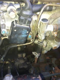

Now Rough
I replaced the throttle chamber with a stock one, sorry Zdon found one nearby less money. Now it won't idle. The idle adjustment assembly appears to be disconnected see picture one. Do I have all the hose correct? see picture two.

Think I got it
Had some more time this morning, checked all the vacuum lines and changed a few of them around. Tightened all the other clamps and she idled, low at first then dies out. I think it was because it was cold and when warm the idle setting is too low. I still might not have the correct throttle chamber. The illustration shows a port on the bottom. The one I installed does not. I believe this is where the idle speed adjustment hose is suppose to go. Any one know if I can "bolt on" this port or just go and get another throttle chamber

ZX trottle chamber issues
If i'm not mistaken that port at the bottom is a water port. I had a feeling you would have a problem with it as there are various trottle valve configurations. The trottle chamber i had if you wanted it actually eliminates all the extra gismos. The one you're using now has a water inlet and an outlet piping which will in do time cause a coolant leak with overheat problems. Your decision to make though. Cheers !

If you live in a place that can get pretty cold I would suggest keeping the throttle body with the coolant lines going into it, they go in there because of the cooling effect of engine vacuum, on a cold day you could get ice build up after running the engine a while, the coolant prevents that from happening by circulating it through the throttle body.
