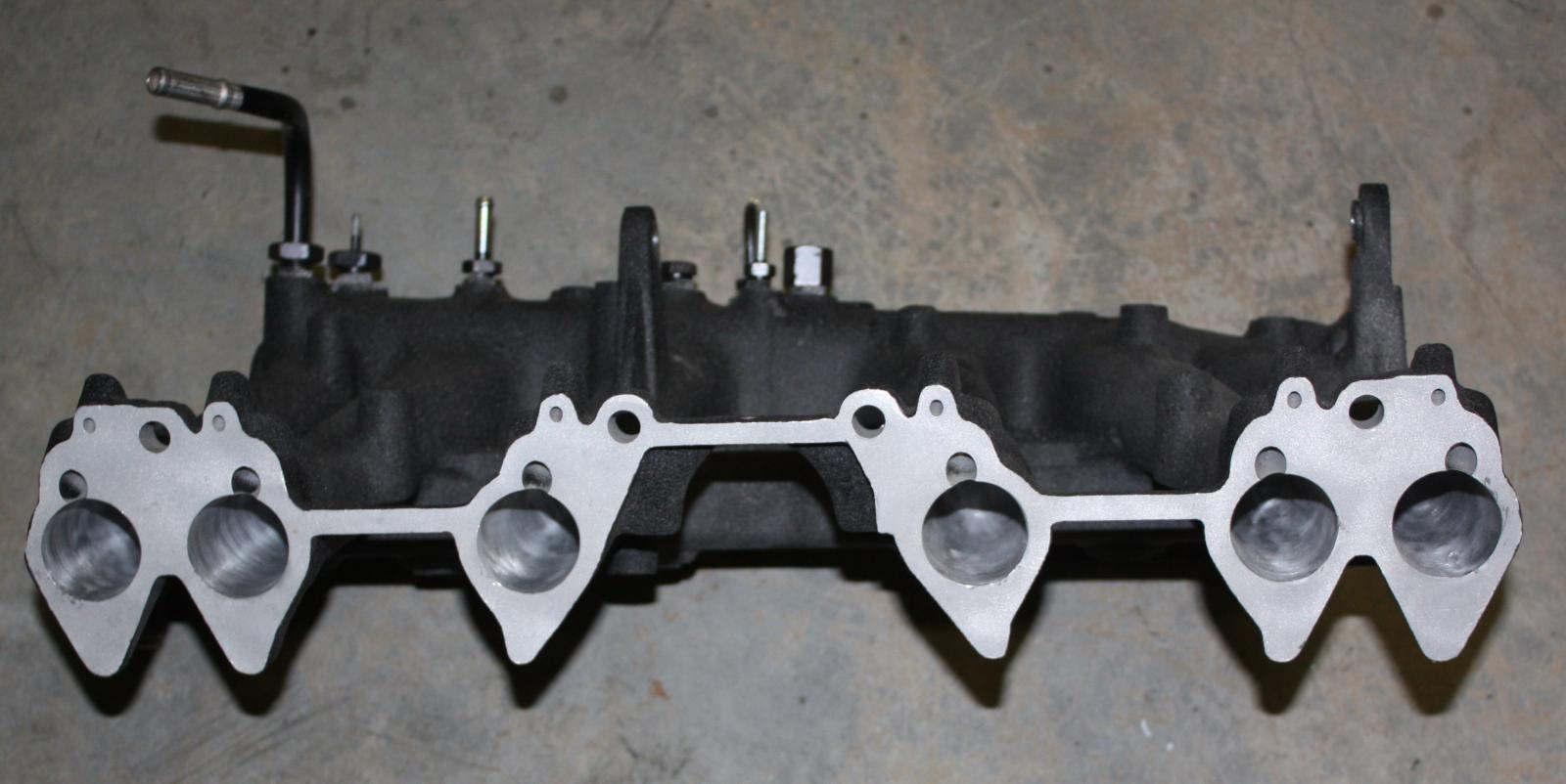

Old May 2, 2012 | 05:18 PM
From: Victoria, BC
Originally Posted by jasongeek
So I decided to replace the head gasket working on getting the head off now gonna do the valve seals why it's off hopefully it's not warped. The intake manifold was a complete pain thinking about Dewebbing it any thoughts?
I dewebbed mine but IMHO you need to do the heat shield as well with a thermal barrier like the DEI heat blanket. Also porting out the intake runners is a very good idea - at least take the flashing out and try to open it up as much as possible... Your intake runner is almost half the area of your intake valve...
Here's a pic of one of the NA plenums I did. I did the same thing on my turbo plenum but I cut the back off and did the back side of the runners as well. I also ported both of them for a 240SX TB.
Attached Thumbnails 280zx adding coolant but no leak?-na-plenum-2.jpg   280zx adding coolant but no leak?-na-plenum-1.jpg
