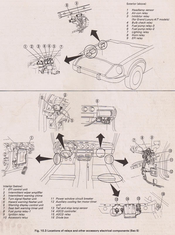

Old Aug 14, 2011 | 09:34 AM
  #32
#5 on the lower fig.

Old Aug 14, 2011 | 10:40 AM
  #33
jaromgi's Avatar
Joined: Jul 2011
Posts: 126
From: Provo, UT
Thanks! I just don't know where to get the part. I found I in the FSM and Haynes manual, but don't know what the replacement part # is.
Old Aug 14, 2011 | 11:41 AM
  #34
Flasher relay at AutoZone: http://www.autozone.com/autozone/par...=6416_0_11714_

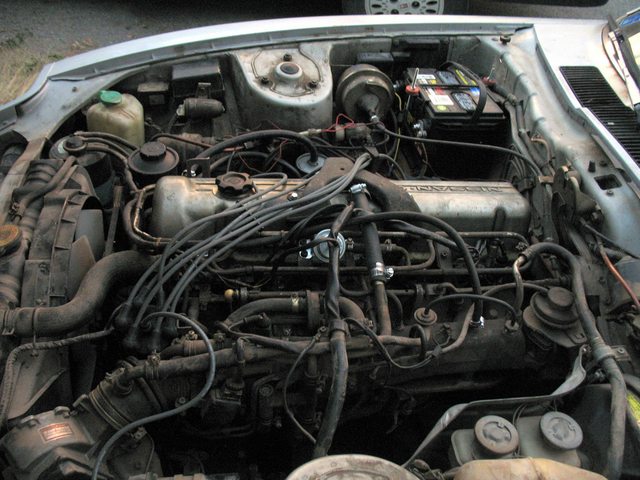

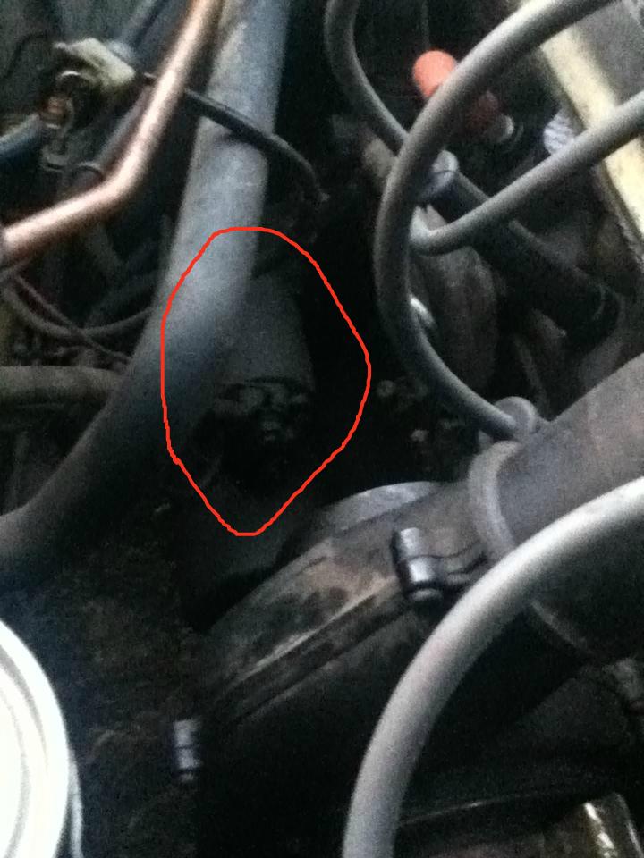

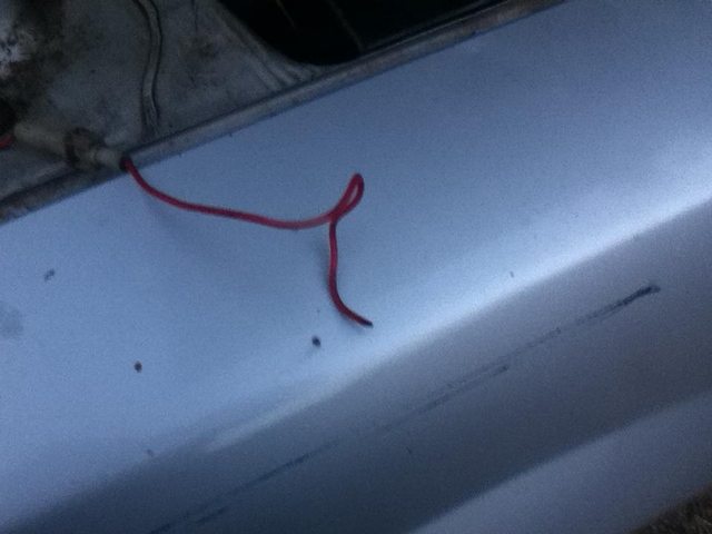

Joined: Jul 2011
Posts: 126
From: Provo, UT
Sorry about poor image quality
under the hood
mystery wire that has been cut by ... gnomes?
the mystery wire leads to this:
Old Aug 18, 2011 | 11:38 PM
  #45
From: Victoria, BC
Lol - that would be your starter solenoid. On my '83 280ZXT the previous owner had hooked the starter up to a pull switch to bypass the ignition switch... sigh....
so just connect the red wire to the positive connector on the battery? The car seems to be running fine without it, which is why I am confused. Well, it "runs fine" without it. see above for various problems
