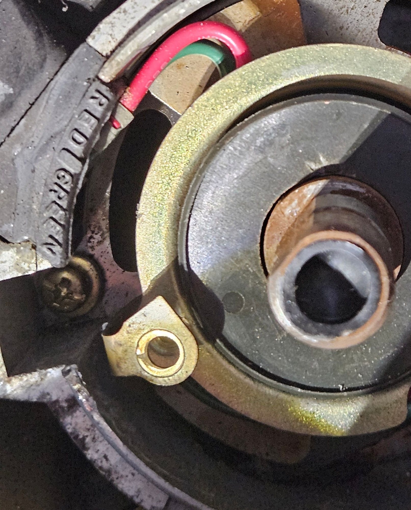

I lost the grommet that goes on the i c u that tells where the red and green leads from the pick up coil plugs into it Don't know which goes closest to the vacuum advance. The factory manual doesn't show the orientation

just did mine last night. Here's a picture showing the red/green markings. Hope it helps!
