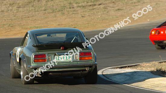

2005 with the custom 8" Volk Racing wheels.
EDIT those pics are rubbish, see the 15 x 8" Volks better here
Attached Thumbnails Widest 16" Tyres/Wheels-qr-sprints-tracktime-28-5-05.jpg   Widest 16" Tyres/Wheels-resize-volk-wide-wheel-z-001.jpg

Ok, we are talking 280ZX here by the way. The 280ZX has quite a bit larger fender wells than the 280Z.
My measurements will not be the same for that S30 car.
Also, are those 16" Simmons wheels? They look smaller for some reason.

15" x 7". To put some perspective on 16 x 10" under a 280ZX see the pic EDIT on my previous post showing 15" x 8" under a S30. The ZX should look fearsome

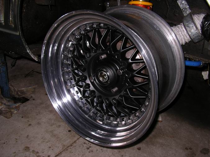

I have attached some phots of my '81 280ZX and have some specs. for you. The car has been lowered using Tokico springs and Tokico HP struts at all four corners. The wheel and tire package is as follows:
Front: P225/50/ZR16 Birdgestone Potenzas mounted on Epsilon three piece mesh wheels measuring 16x7 with zero offset and zero backspace.
Rear: P245/45/ZR16 Bridgestone Potenzas mounted on Epsilon three piece mesh wheels measuring 16x8 with zero offset and zero backspace.

Very nice, thanks for the info. Your car is beautiful. I have pics of it in your driveway but these are even better.
Looks like everything fits with room to spare.
