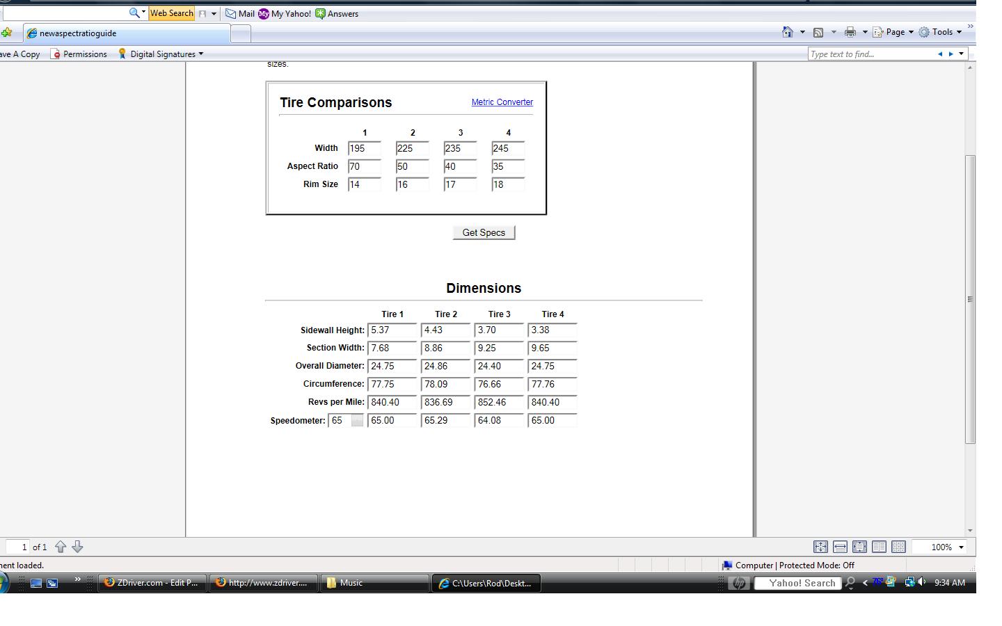

P.S. Here is an updated ratio guide to include an 18" option:
