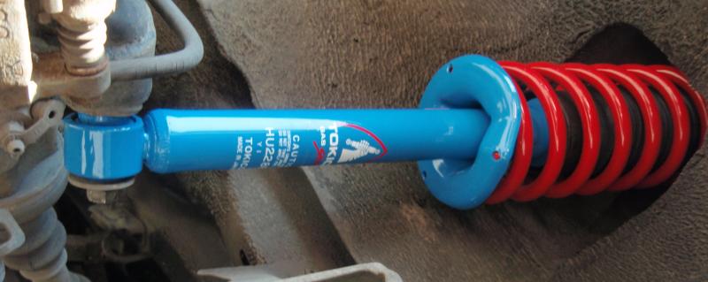

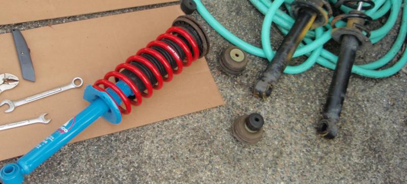

I threw the rear shocks and springs in. It was super easy.
Picture with cut springs:
Then with the Tokicos. Raised 1.25" from the cut springs and it is a much softer ride. It dips just a little on takeoff but handles way better than that jarring bouncy cut spring.
I still plan to cut the rear springs just a little. Maybe 3/4 of a coil. I like the higher ground clearance though. I was scraping the sway bar mounts quite often since they are the lowest point on the car.

I didnt' measure the clearance. There really isn't that much angle change on lowering. The trailing a-arm is still fairly level. There is plenty of inside room. I think over 2 inches now.
At least an inch on the outside to spare. No need for fender rolling. I could run much wider wheels and tire in back.
The Tokico set includes all four struts and springs for a good price. Coilovers are expensive. I don't have a welder nor the time. Plus this is a daily driver not a racer. Once I set my height I'm done.
Camber plates in front would be fun but un-necessary. The camber is perfect up front. In the back it could use less camber but plates won't do a thing as its not a strut setup.
Now that I have this setup, in future years if I needed to replace a strut insert or shock I could possibly consider a pair of weld-on coilovers for fun.
Also, after driving this car for a couple weeks I would say the ST springs I had a few years ago are more firm. These dip a bit too much on acceleration and I'm still running a stock setup. (slow) I don't consider the factory turbo Z to be a fast car. Its geared way too high. 3.7 R200 and more BOOST are in order
