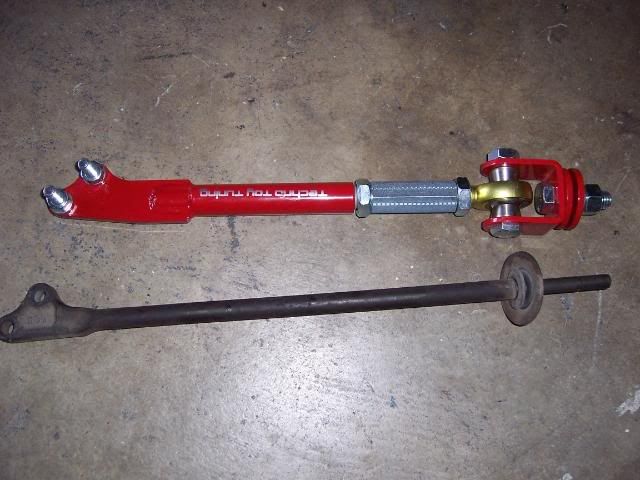

Out of my whole suspension package, I have the first set of parts.
Techno Toy Tuning (T3) adjustable tension rods and roll center adjusters. AKA bump-steer spacers
These things are heavy duty.

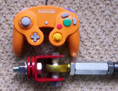

stronger than a GameCube controller!

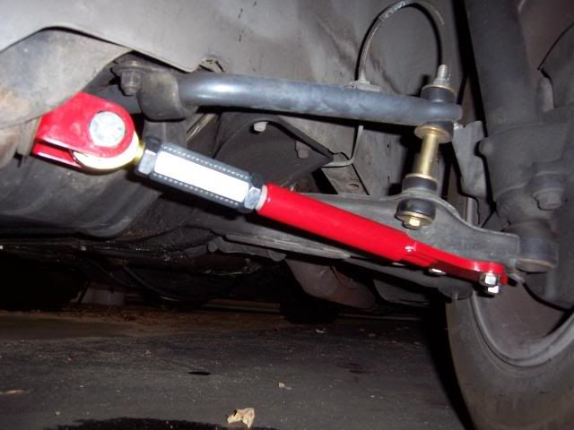

I wanted to be more like Bleach so I ordered a set. Ordered Tuesday, arrived thursday installed Friday. Awesome company that Techo Toy Tuning is...
Now to get it on a frame rack and see whats up with the Z.

Ok, the Techno Toys adjustable TC rods are about 50% thicker diameter and use a heim joint at the greatest stress point that is the most prone to breakage from the torsional stresses created by a lowered 280ZX.
The heim joint eliminates the possibility of this kind of breakage and if it's a high tensile strength heim joint, it'll rip out at the mounting points before the heim joint itself fails.
