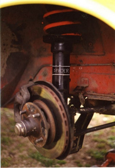

Tires came off just fine! I guess I'm showing my lack of knowledge here because I wasn't quite sure what part to call it . I meant the part of the wheel where the strut attaches to the brakes. I searched for a picture, and attached what I meant (not from my car).
Attached Thumbnails Stupid springs/shocks question-280zx_struts.jpg
Old Mar 29, 2012 | 10:15 AM
Ah... the ROTOR. You don't need to take the rotor off to remove the strut. Makes things a lil easier, but not necessary.

I guess the overarching problem was that we could not get the strut off of the rotor. I'm not sure I'm saying that right ...
Old Mar 29, 2012 | 04:18 PM
To do the springs and strut inserts (shocks) you won't need to touch the rotor. The only time you'd need to remove the rotor is to replace it or have it machined smooth for a brake job.

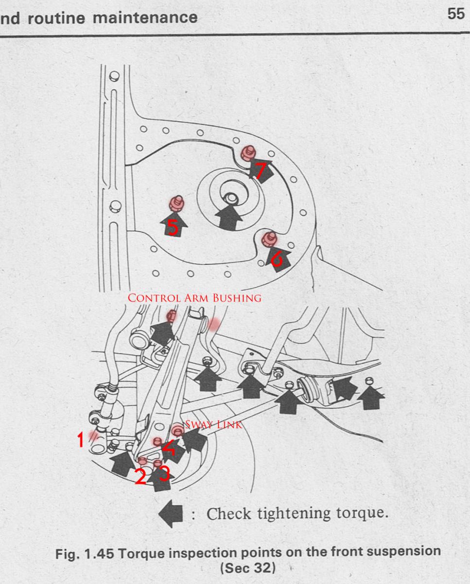

To remove the strut, remove the 3 bolts holding it onto the control arm, remove the cotter pin and nut holding the tie rod (then knock out the tie rod), remove the brake line clip, and the three nuts on the strut tower top, and out comes the strut.

I whipped up a guide in Photoshop for ya: Haynes manual pg 55 & 257-259.
Attached Thumbnails Stupid springs/shocks question-s130-strut-removal.jpg
