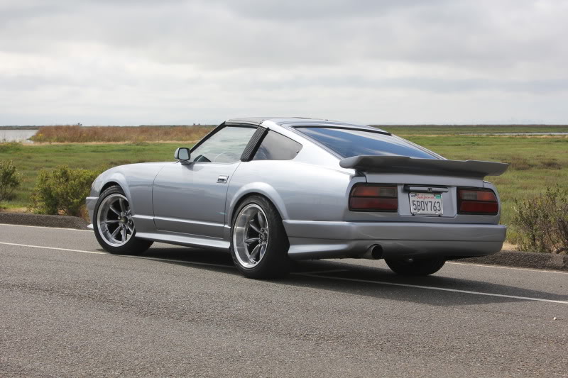

I'm running the the Racing Labs rota RBR staggered wheel setup on my car.. in fact they're using my car on there webpage.... ROTA Wheels RB Stagger Package (Datsun 1975-1978 280Z, F: 17x9, R: 17x9.5)
if you go with the same package as i got you wont need spacers to make it look flush.. but you will have to roll your rear fenders heres a link on rolling your fenders
RollYourFender.Com - Home - Fast, Easy, & Affordable Professional Fender Lip Roller Rental
the 16x8 you were looking at wont look as aggressive as the 17x9.5... you also might want to lower your car too.. you can get the tokico lowering package with springs ans struts

The pics of your setup was what led me to desiring this kind of set up. Totally changes the look of the car...making it much more aggressive.
Thanks for the info on the fender roll. Gotta admit, I'm a little reluctant (scared?) to bend it simply because I don't want to have to repaint and worried about damaging the paint.
Going with the 16x8 would be slightly less aggressive...would be 30% cheaper...and would not require the fender rolling. I would not be quite as happy with it...but I might be satisfied.
