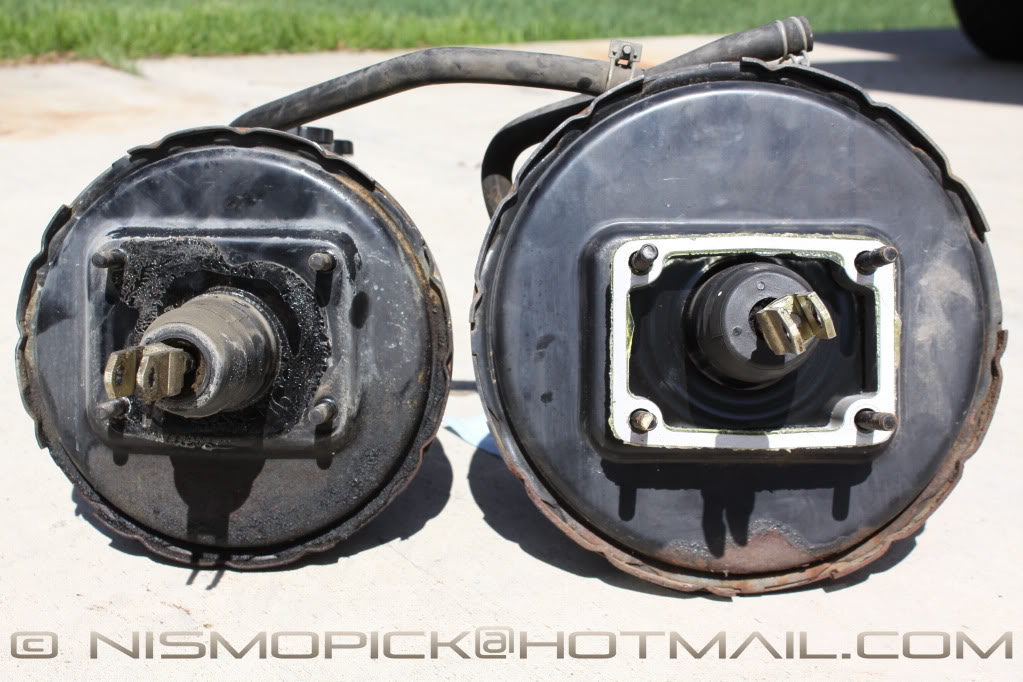

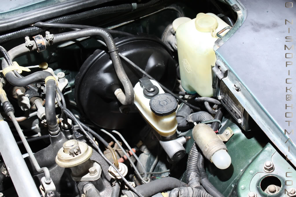

For my 82-83 booster swap into my S30, I clocked the booster 180*. I don't think it would work on an S130 tho?
https://www.zdriver.com/forums/showp...9&postcount=24
