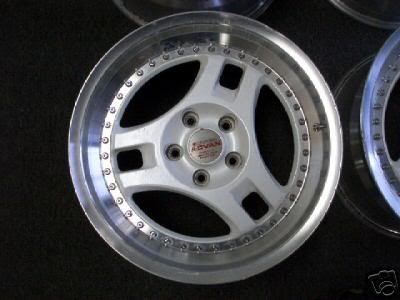

Just bought a set of two peice SA3A Advan wheels. 17x8 up front and 17x9 in the back.
I wanted to get some Advan tires to match my wheels but at $300 a tire its a little out of my price range. So I am pretty set on Khumos but have some questions.. I want a high performance summer tire and Khumo offers two of them, the ECSTA Supra 712 and the ECSTA SPT. Not that it makes any difference but in most sizes the SPT is like $3 more. Not sure which one to go with or what the difference between the two are?
Im not quite sure what tire size would be best for a 17x8 and 17x9 wheels? I see alot of people run 245/45/17's on 17x9? I dont want there to be any buldge or for them to be stretched, If possible I would like to get them completely flat on the sides.
Id greatly apreciate any help
Thanks
Rob

245/40/17 on a 17x9 wheel would be a better choice. Tire diameter will be identical to stock and width will be about 9.65" which is a identical to your true wheel width, measured from outer to inner lip. For the front a 225/40/17 would sit well on the 17x8 wheel if you don't mind a smaller diameter front tire than your rear tire, about 1/2" shorter. As for tires I've read alot of good feedbacks on the Kumho V700 and V710. Some consider these tires best for the track or autocross. Downside is you'll be buying a new set about every 5000 miles especially if you run them on the street. For everyday street use and track use every now and then I would go with Nitto N555RII. I am trying to decide on what wheels to get myself. Post some pics of you 17s when you get them on the car. I'd really want to see how those would look. What offset are they anyways, +0? and how much do they weigh?

Thanks for the help. What are you looking at for wheels. I have a feeling these are the kind of wheels not everyone will like the look of but I really like them. I wanted something kind of rare. Down the road I might take them off and paint the centers the same color as my car, but I think the white will look cool with my blue paint.
I looked into 225/40 and 245/40 tires. Theres a much smaller selection, infact I cant find anyone who makes a 225/40/17. So how bad would it be if I went with 45's? I apreciate how you figured out all the math for because I dont quite understand how you do that.

I like the look of your Advan's, but I'm curious how you're gonna get those onto a 4 lug hub?

Just kidding, thanks for compliment on the wheels. Im going to use modern motorsports adaptors.
That is what I did like about my Rewinds, they were very light. But I think the 17's will look a lot better and the big thing was the width of the wheels. the 7's just werent cutting it. I think the 9inch rear wheels will really fill out my wheel well nicely.
