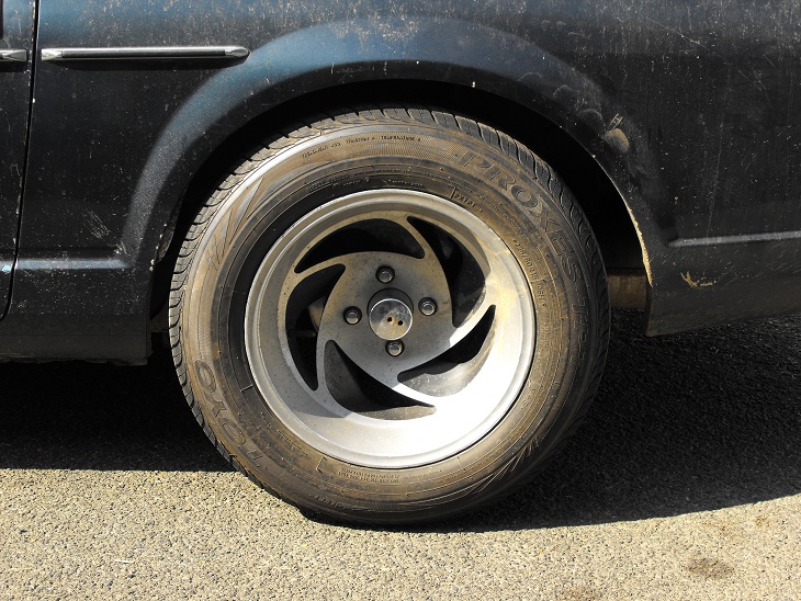

The rear tires are rubbing (225 60r 15), this is most noticeable on the driver side where it has pulled up a bit of the wheel well and is causing it to whine (think chirp the tires). This only happens when going over a bump at speed, accelerating, or anytime weight is shifted to the rear. I have banged down the part of the wheel well that was pulled out and made it smooth, but repeatedly the tire pulls it out. Looking at the passenger side, no part of the wheel well is pulled out, but you can see a little wear on the tire where it is rubbing. Are the tires to big? Are the struts shot? Something else? I'm new to these cars, but my guess was the tires were to big. The tires look stuffed, and the car does not bounce when I tested the suspension. Any help would be most appreciated!

I have about 3 fingers worth of spacing with nothing in the back on < 1/4 of a tank of gas. Quick calc buts the tires at around 25" with rim.... Could be wrong on that.
Pictures included are: A closer view of driver side (problem side). A wide view , and finally a close up of what is going on. I have set it flat several times and it keeps getting ripped up. Finally the last picture is of the passenger side that is fine right now, though I do see some rub marks on tires.
Wheels I assume aren't stock, are they wrong offset? Would that cause this?

ya there not stock wheels
tire size looks fine to me, how far do the wheels stick out? could be the offset.
Old Jul 30, 2009 | 05:03 PM
205/60-15 is stock tire size so your wheels are oversize as far as the outside diameter goes.
They should still clear just fine on the upper center fender flare if you had the car lowered.
http://www.miata.net/garage/tirecalc.html
Buy some 225/55-15 tires and I would bet those clear just fine. (plus your speedo will once again read correctly)

I know it's kind of a long shot, but your wheels are backwards, and the tires look like directionals, maybe the one on the driver's side is backwards... I have no clue if that would cause your problems though... the way the suspension moves, I wouldn't think would let the tire come that close to the fender lip...

No idea if it is lowered. They stick out about 1/2" from the wheel well, is that what is causing the problem? The wheels are pretty wide, I would say about 8-9 inches I am not sure how much narrower of a tire I could go... As I said I just bought it so I am not sure what they did with it. Tires are new (I guess they did 2 burn outs on a Camaro and did not hook up right), I just need to be able to drive her while I do some quick restoration work
Car sits level left to right and back to front.

Those look like some pretty negative offset wheels to me. Looks to me like either it's different wheels, or roll 1/4 panel.

So I need entirely new wheels, no tire size would make this work?

Spent the last couple days looking for a 4 tires that would fit with no luck. Ended up with another 2 195/60-15 for the rear so all the tires would be equal. So I replaced the 2 225/60-15 with 2 195/60-15 so the whole care is running on 195/60-15, and it looks fairly silly. But I needed to drive the car, and get those 225's off so I can sell them, and I got a good deal (45 a tire mounted and balanced). Now that its drivable I can begin to work it out and see what the problems are on my Z.
