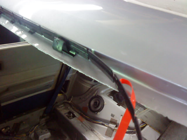

The 82-83 cars are the only models from the factory to use the white clips. 79-81 uses a self-adhesive plastic strip with the clips integrated. I cannot confirm whether or not the strip is adequate for 82-83 models, but I did not need them on my 81. It would be very difficult IMO to replace the strip without pulling the windshield.
As you can see the strip has a "foot" that rests on the pinch weld for proper position (behind the windshield). The large integrated clip you see in the pic is what actually secures the molding. Since you have already painted the roof and do not wish to pull the windshield, I would probably try and pull the upper and lower moldings and apply urethane to hold the molding securely in place of any broken clips on the strip.
If you don't have a urethane gun or didn't feel comfortable doing this you could take it by an auto glass shop and ask them to do it for you. They may even be able to do it without removing the moldings, depending on how "loose" they are. Hope this helps.
