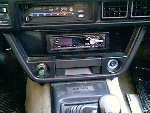

i like showing this pic...

Nice, Looks simple but doesn't sound it.
What's the best material to use as the face plate that holds the head unit? Any rigid plastic?
What exactly is so tough about this install...most say it's hard, but don't say exactly what is.

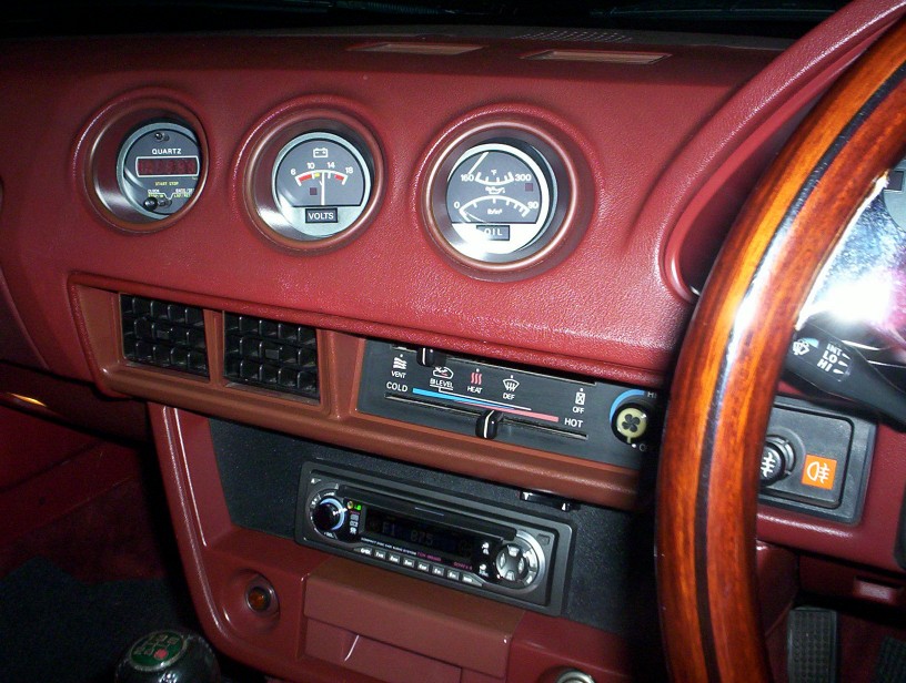

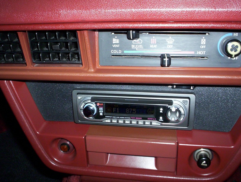

Hi,
I recently replaced my radio with a cd player.I got a replacement fascia plate from Motorsport Auto...http://www.thezstore.com/page/TZS/PROD/RF/50-3301
Cheerz,
Jez.
Attached Thumbnails Aftermarket Radio Question - Wires-zx-stereo.jpg   Aftermarket Radio Question - Wires-zx-stereo2.jpg
