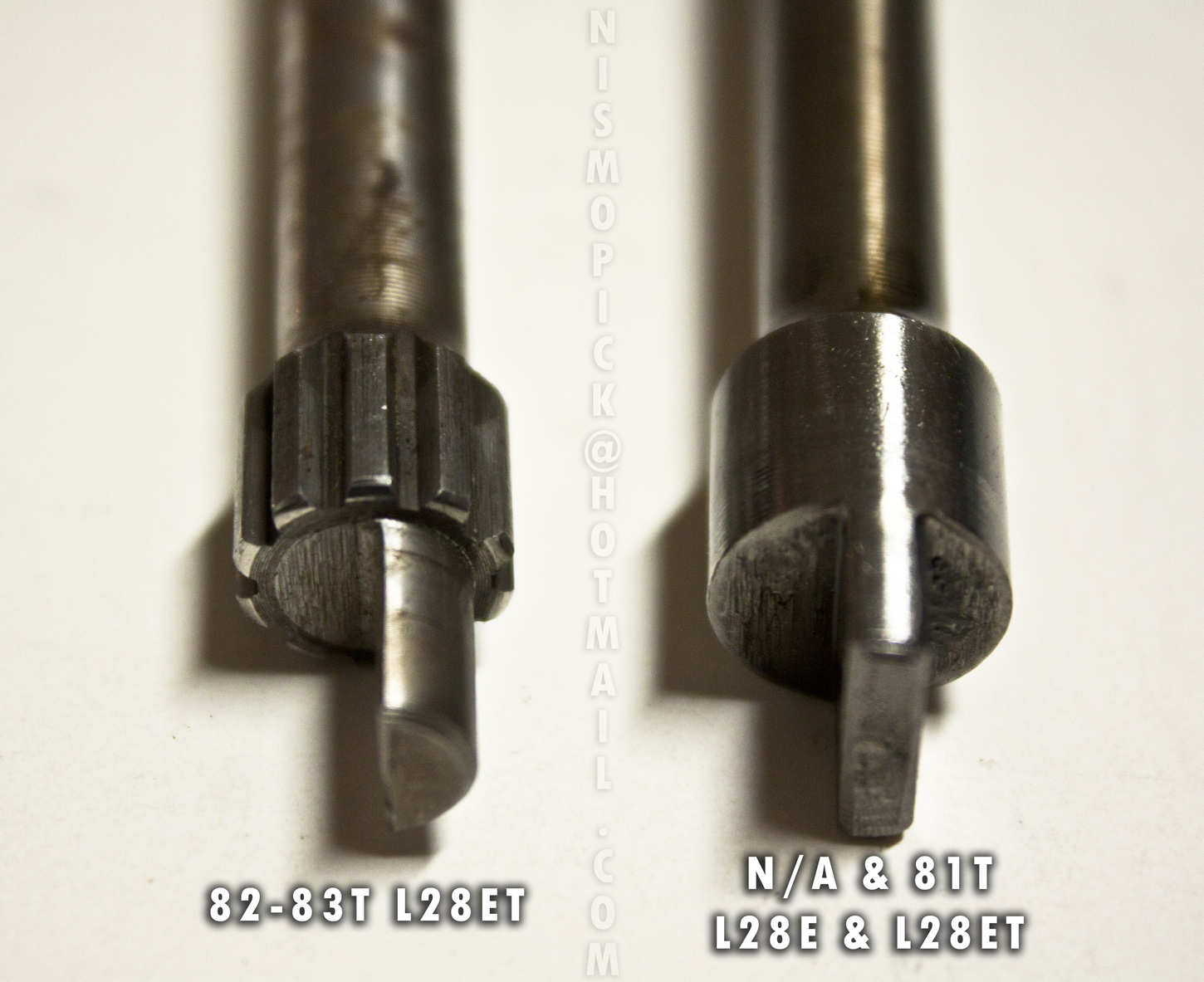

This is a distributor swap guide for those needing an optical Crank Angle Sensor (CAS) for MegaSquirt, Z31T ECU, or other various EFI systems. The 82-83 280ZX Turbo distributor is needed, along with the internal CAS and Chopper Wheel (encoder disc). The Nissan VG30E, VG30ET, and VG33E (Z31, Maxima, Pathfinder, Quest, QX4, Xterra) also share the same CAS which can be used to refurbish a worn out 280ZX CAS (see bottom of this post).
*Note: The 81 280ZX Turbo distributor does not have an internal CAS, using instead a plate attached to the back of the crank pulley and magnetic sensor mounted on the A/C bracket. Both output the same signal, but the advantage to the 82-83T optical CAS is ease of changing the encoder disc for various EFI setups, and ease of timing adjustment.

  1. 82-83T Distributor
  2. 82-83T Oil Pump / Distributor Shaft

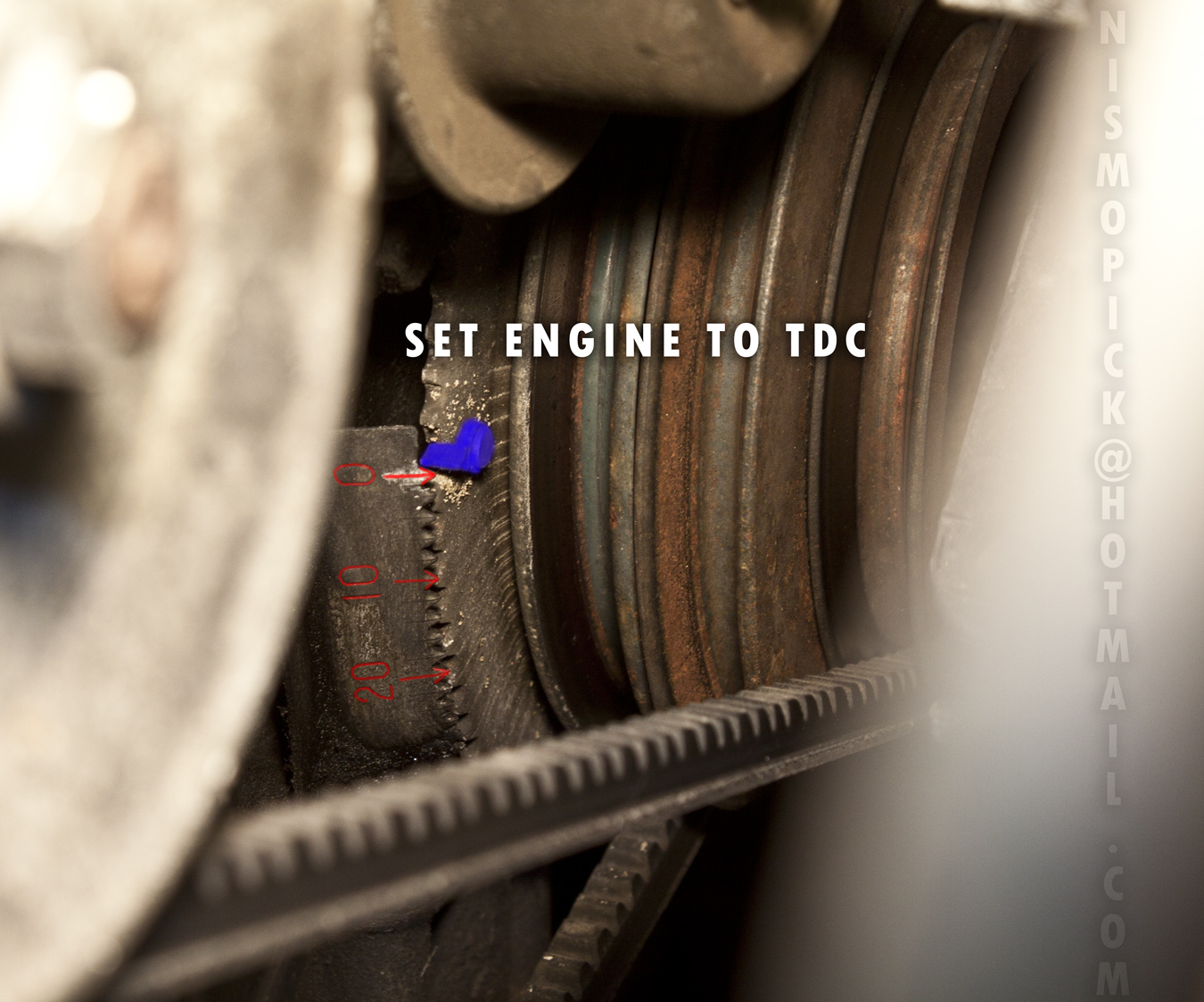

  1. Set engine to TDC cylinder #1

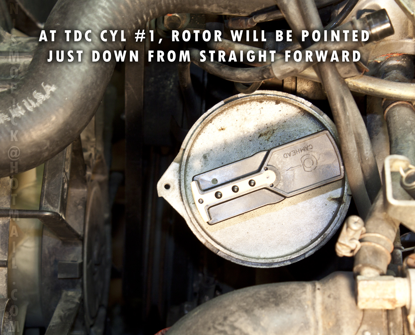

  2. Remove distributor cap and take note (Take a picture!) of the rotor orientation: pointed just down from straight forward. Remove distributor.

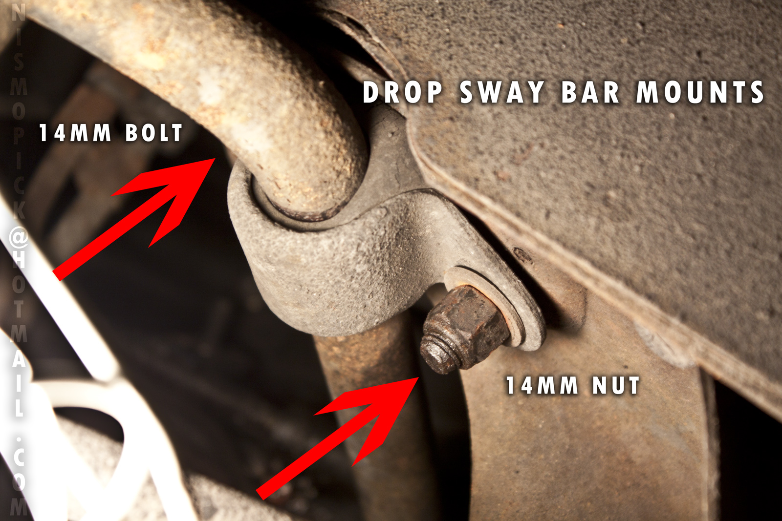

  4. Lower front sway bar by removing the left and right frame mounts.

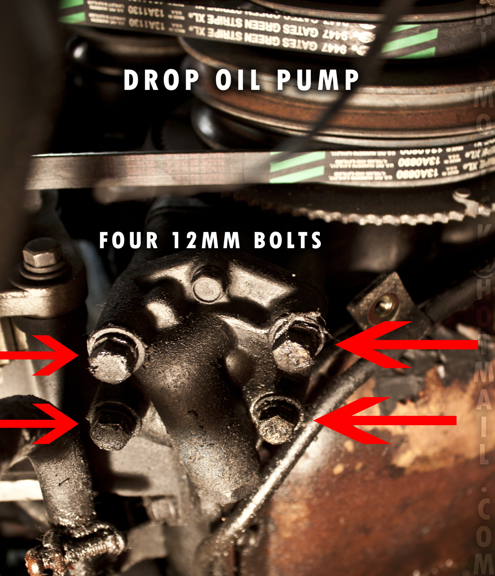

  5. Place oil catch pan under oil pump, remove oil pump bolts (if auto trans, remove 10mm bolt holding ATF line to radiator to allow for more room).

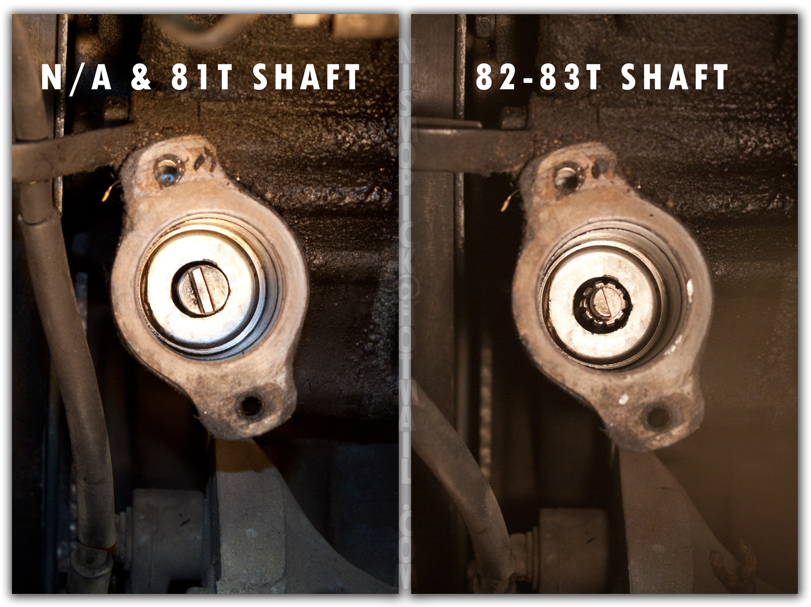

  6. Carefully pull down oil pump (expect some oil spillage!). Distributor shaft will follow.

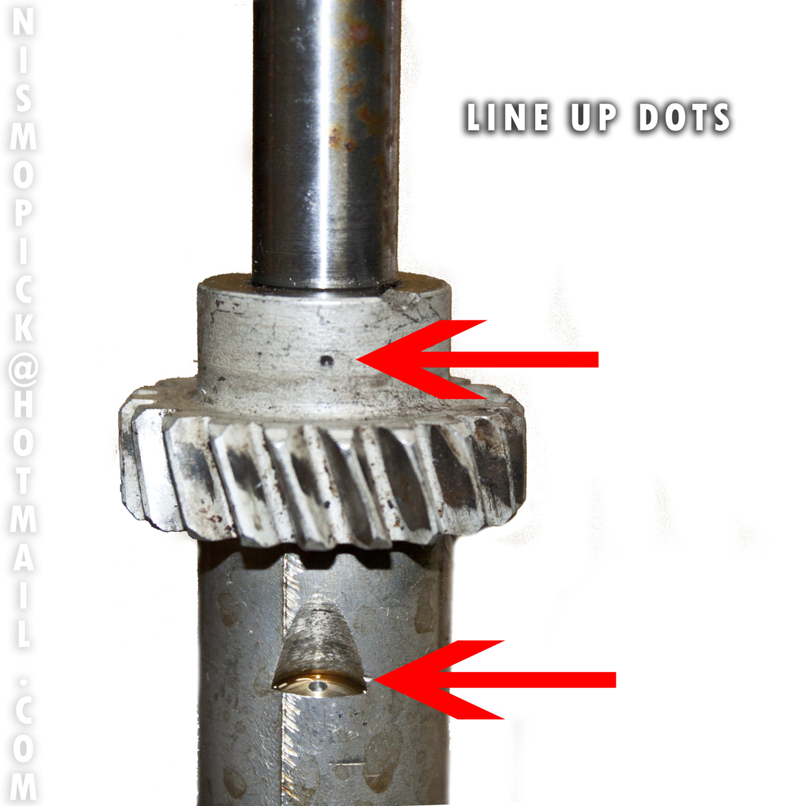

  7. Insert 82-83T shaft into oil pump, aligning the dots.
  8. Without rotating shaft, carefully insert oil pump, new pump gasket if needed, and shaft back into slots in timing cover. Use a block of wood against the sway bar to hold the pump in place. Check from above that the oil pump shaft is properly aligned. If not, carefully pull down pump and rotate shaft a few degrees in needed direction. Repeat if necessary until perfectly aligned (take your time!!!).
  9. Re-install oil pump bolts, torque to spec (8-11ft/lb).
  10. Re-install sway bar brackets, torque to spec (20-27ft/lb).
  11. Install 82-83T distributor with cap off. Verify that rotor orientation is exactly same as before (reference picture).

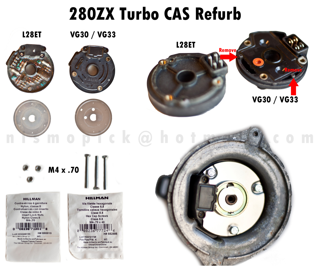

If the 280ZXT optical CAS has seen better days, a much newer one can be had for cheap to free at your local junk yard. Nissan and Acadiana Sports Cars also sell them new for ~$79.
M4x.70 bolts and nuts can be found at any hardware store. The only modification is to trim off the alignment tabs on the newer CAS. Easiest done with a Dremel.
