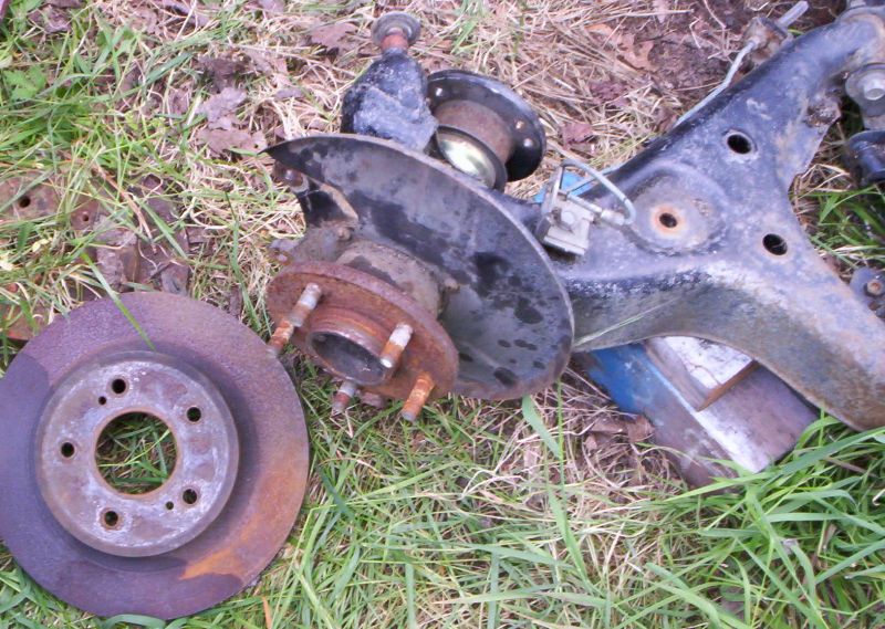

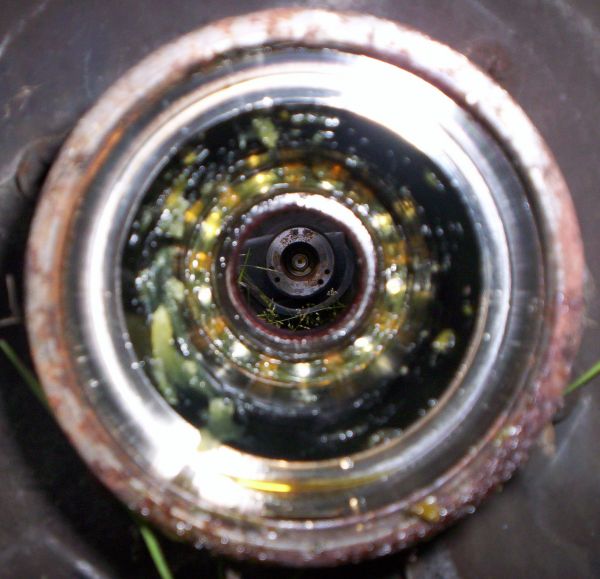

I did part of it. It does bolt in, even with the different flange I have.
The outter hub seems to sink in just a little too far. The caliper looks like it will bolt on but the rotor is in just a bit too far.
Reading Franks post again I think I may have missed a part. The inner bearing that is left inside the Z31 trailing arm probably needed to be swapped over as well. That might space the hub out another 1/8 inch. So far so good though I guess....
Update: I looked at Rockauto.com - they list the actual dimentions of parts. The Z31 inner bearing and 280ZX inner bearing are the same size and part number. swapping that over won't do anything.

On the front with the Z31 struts, yes. But on the back... no. I can use a thinner 5 lug to 5 lug adaptor. That will be better than the 2-piece adaptors I have now. The wheels could come inward a little.

Originally Posted by frank280zx
interesting what year z31 is that ? i have different hubs ! and i have different stubbies .. i have four bolts..
The Z31 I'm using is a 1987 non-turbo.
I compared pics of my 280ZX CV inner flange and the Z31 looks bigger.... it sticks inward farther. I dont' think the CV axels are short enough.
I might try another trick by using the 5-lug Z31 outter half and the 280ZX inner half. If the splines line up it should work fine. But then I'll see if the outter hub is the correct distance for the rotor to align with the caliper. Yours swapped in so easy.
but yes on the axel bolt pattern. Both are the smaller 6-bolt style and they appear to bolt up the same.
