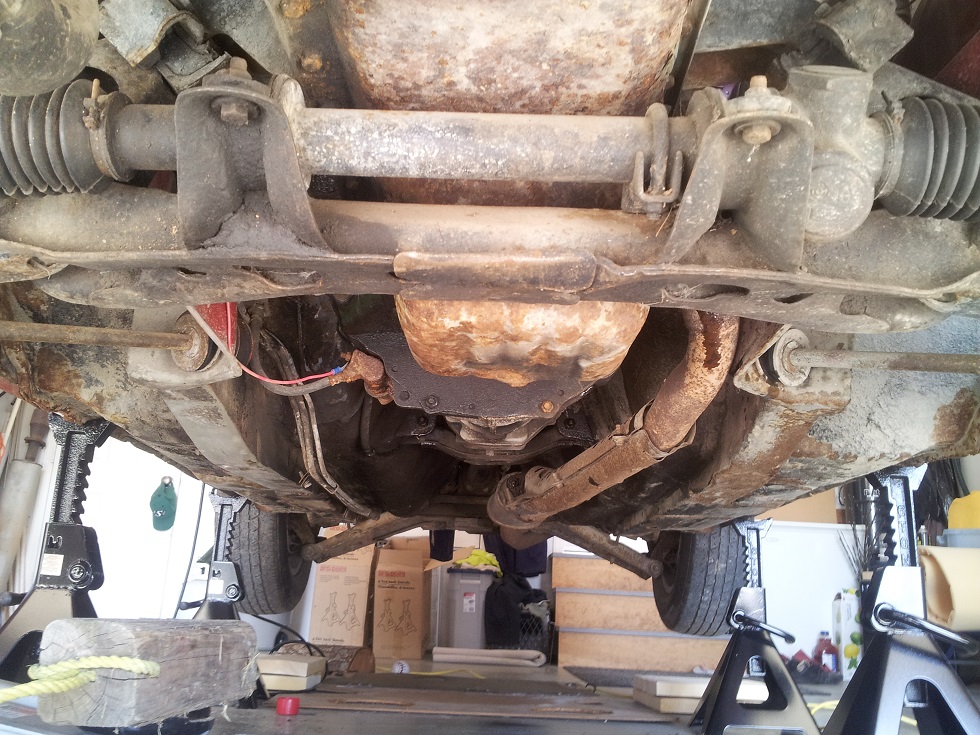

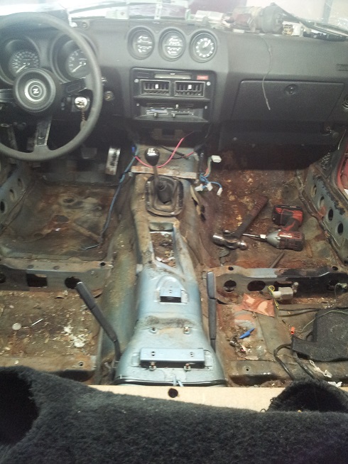

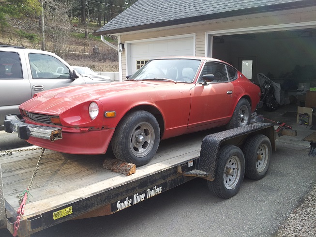

Hi All,
Recently brought home a 77 280z ( non running), came with 2 front fenders, light buckets and a wiper cowl, extra ECU. The frame rails were in acceptable condition, passenger floor pan gone, driver's pan in decent condition. The interior is rough...cracked dash, door panel etc. So, I start to remove the interior to start pan cutouts and replace and any other things I know I would come across, and then I removed the center council the trans tunnel and this is what I saw (see attachments). Now granted, I really didn't pay much for this car, and could part it out for a profit, but I always wanted a classic Z car and have the skill with the mechanical/electrical side of things, but this is scaring the ***** out of me! I do have a neighbor with a frame straightener up the block, should I fix her up, or cut my losses?

Pictures..
Attached Thumbnails Think I'm Screwed, Trans Tunnel/Unibody-20150403_153842.jpg   Think I'm Screwed, Trans Tunnel/Unibody-20150405_135802.jpg   Think I'm Screwed, Trans Tunnel/Unibody-20150411_151935.jpg

Heh, looks like a bend in the console. I can't think of what would do that except a serious t-bone whack to the driver's side door jamb/frame. You should see evidence of repairs there, especially around/under the door. Otherwise your worry should be whether the wheels are even close to aligning now - and if they can be aligned under these conditions. If you can check them and the wheels are OK, then the question is whether the structural frame was wracked out of plane. Your call. You may as well find out first before you start dumping time and bucks into the restoration. When it is restored and rolling again, you will expect the Z to give you the road-hug ride Z drivers expect. You need OEM alignment all over for that to happen (plus good tires and suspension..)

Thanks for the response, from underneath the Trans mount is is crooked due to the twist in the tunnel, so the whole drive line is off. Thanks for the heads up where to look for further scary bits.

The wheel alignment should be the big test for frame wrack. If the wheels are within spec, hard to think the frame is out. But there are only 3 dimensions for the frame, the 2 for being still horizontal (in-plane, L + W) and the 3rd for being out of square (frame corners are no longer 90-degs/not a rectangle = a parallelogram). I think it's worth checking out if you have the tools.

You could tow it and have someone drive behind to see if it is tracking straight. If it rolls straight then go ahead and fix the sheet metal. Huge project.

Another thing would be to get it on level pad and measure the height of the wheel arches and door sills compared left to right. And the level of the rear at the hatch opening side to side. Instead of on the tires maybe better to put it on axle stands.

Have to wonder how that type of damage was caused without an obviuos side impact. Maybe someone jacked it up with a floor jack. Get underneath and inspect it. Take a good look at the trans crossmember. Could have even backed up on a curb.

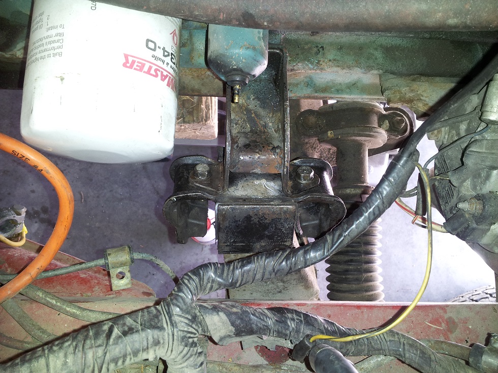

Thanks for the input. The Trans mount is bent with the transmission being bias to the left of the car, with the drive shaft bad angle. I need to get more time under the car, and haul it up the street to a guy who has a frame straightener and get a better look at it. I will check ride heights and measure diag to the ball joints to the rear suspension and other angles...

Just a quick update, going to pull the transmission and exhaust this Saturday. Haven't talked to the frame dude yet, been so busy at the shop and working on the boat as well. Got some interesting advice from a very experienced body guy whole does a lot of fab work, he suggested making a "saddle" in a rough shape to fit under the car in the trans tunnel, and lower the car slowly onto it while pounding out the metal into shape. I'm under no illusion that I'm going to get a factory finished look, but hoping to get my driveline angles right and true.Thanks again to all for your suggestions. On a brighter note, I'm finding way less rust than I thought I would find.

I hear what your saying, Where I live classic Z cars are very hard to find (2 for sale In the Province of 5 million). And when you do, they are priced very high. I paid 1000.00 Canadian for the car. ...that's about $5.98 in American dollars.lol. That being said there are some really promising things about the car. It came with 2 clean extra fenders, a windshield cowl,two nice light buckets, and a extra ECU. In my trade I have loads of access to body and frame guys who are helping me a lot,(I pull wrenches at a local dealership). I'm bringing home some frame-measuring tools the body shop is loaning me this weekend. Ill try to upload some pix this week, should more of the bones of the car, and a motor mount fix, which lined up the Tranny at the firewall.

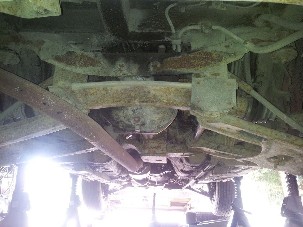

The last two pix are of the mount repaired, and before
Attached Thumbnails Think I'm Screwed, Trans Tunnel/Unibody-20150418_132648.jpg   Think I'm Screwed, Trans Tunnel/Unibody-20150418_132719.jpg   Think I'm Screwed, Trans Tunnel/Unibody-20150419_133403.jpg   Think I'm Screwed, Trans Tunnel/Unibody-20150418_152647.jpg

Those motor mounts are definitely out of whack.
But if you feel like you can get it back to spec - great.

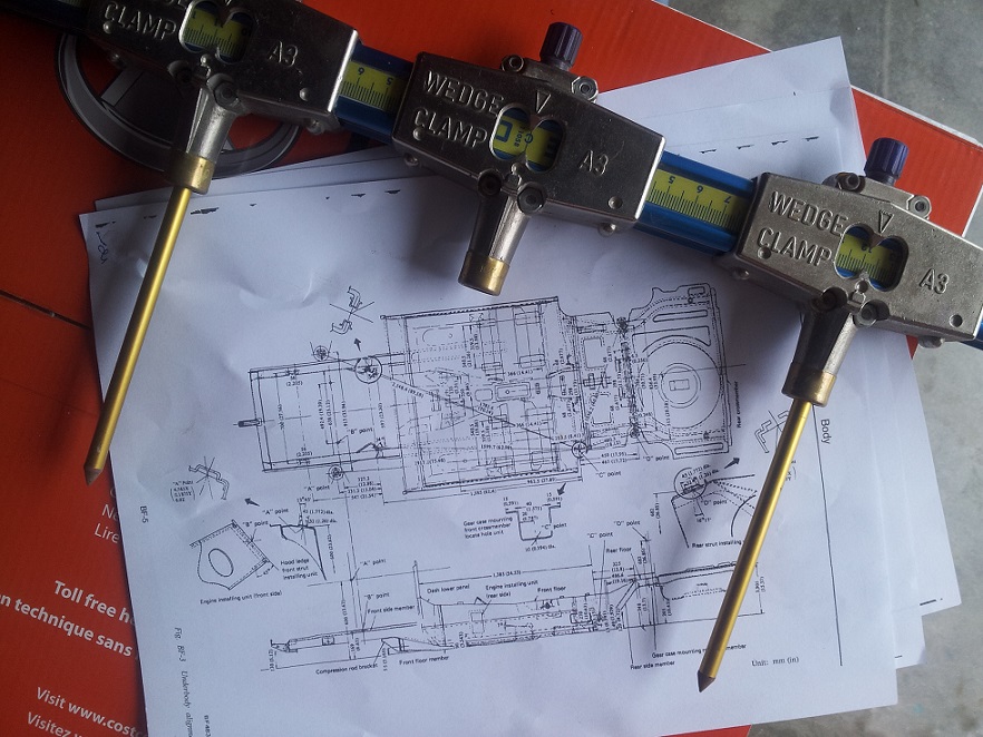

The motor mount was a easy enough to get lined up other than sore hands from cold metal shaping, and spilling my beers in the process. Borrowed a frame measuring tool from the shop next door did numerous measurement angles, from suspension to body points, suspension to suspension, etc. The car is lining up. It has been rebuilt at one point...why they would not straighten the tunnel is beyond me, but it appears the car at this point is straight. Which make me a very happy camper! So now on to why no power at the fuel pump, going to look into the relay and the wiring leading into it...previous monkeys have wiring overlays all over the car. I'm about 4 hours from Vancouver and never been to Quebec, hear it a great place, except for the people who live there...lol
Attached Thumbnails Think I'm Screwed, Trans Tunnel/Unibody-frame.jpg

Looking at your original pics, the doors and body panels all lined up fairly nicely. So I was surprised when I saw the tranny tunnel. I sort of figured that someone must have done some pretty extensive body work and frame rail realignment.
Maybe the tunnel being off like it is, is just cosmetic at this point.

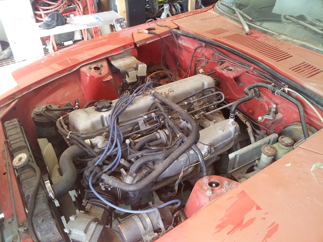

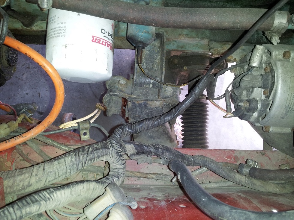

Hi all, just a update. I got the old girl fired up for the first time in nearly 20 years. It took a lot of wiring repairs, new pump and blowing out the fuel lines. I have the exhaust removed, so it's a rumbling! The engine sounds strong, so a bit of progress. Now onto the sheet metal. Thanks all, this forum has been a big help! Can't seem to post the video, will try later.

The start and stall issue is coming down to two things. Bad grounds which there are a lot, or possible ignition. Did a wiring overlay for a toggle for the fuel pump so the car starts and runs steady. Oil pressure climbs quickly, voltage is good. No tach, but not concerned at this time. Removed the fuel rail and replaced all hoses, and the injectors are heading out to get tuned by a Bosch factory trained tech. The injectors were pretty bad, surprised she ran as well as she did.I have be running off fresh fuel from a external cell, the tank is being sent out to be cleaned and re-lined. It is a testament to the quality of these old Z cars that many of the components still function.
