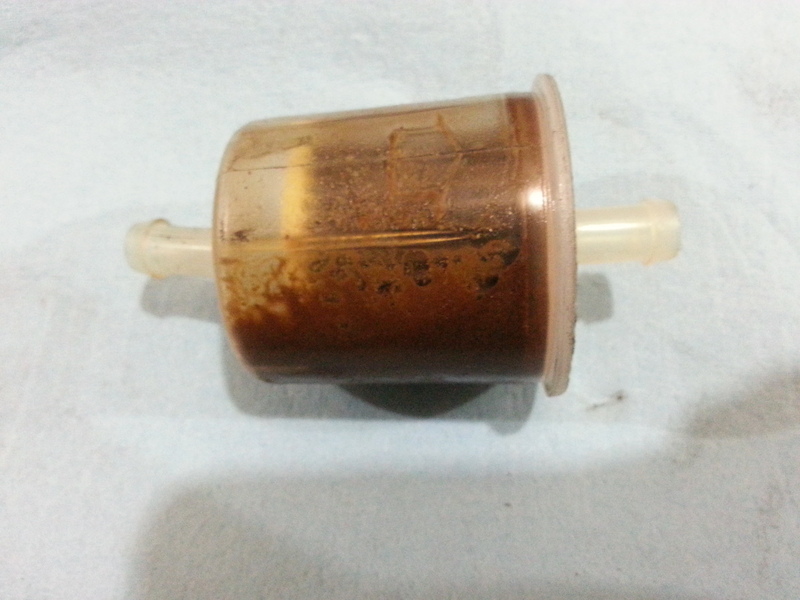

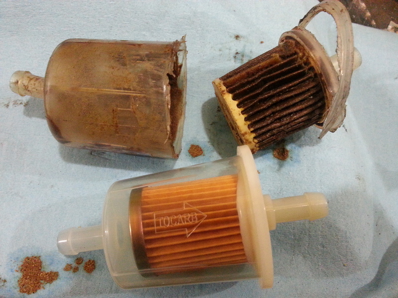

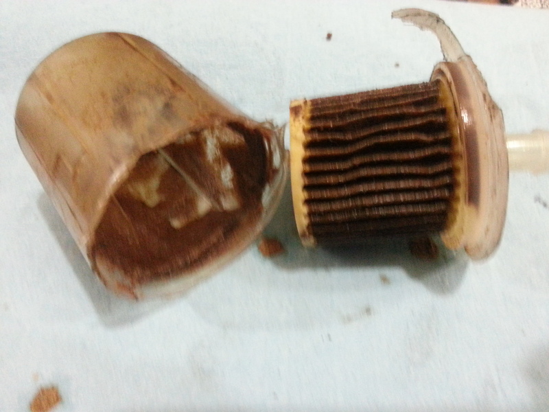

Relatively inexpensive thing to do..this is after 2 years of running with the filter (summer months), filter is before the fuel pump. Should get the tank baked and lined for sure. I think stock pumps come with filters, not 100% on that, but if you are having fuel issues maybe take a look!

Compared to new

I did that on my 78 280Z before I dropped the tank and boiled Lined it but still I have a filter before the pump.

What filter are you using, this one is 40 micron I think, but a 100 would be less restrictive, but so much junk in there , walbro working overtime lol
I am using the same filter that you have....
I think they are good clear filters.....
