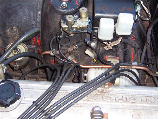

Thanks guys. I have run this to ground I think. The switch is a high pressure switch attached by fitting to the reciever/dryer. I attach a pic if I knew how to insert into these forums. I found the part number and talked with a couple of "Z" club guys who have a track record in this area. I'll use the work around and keep an eye open for a switch. It's somewhat disappointing in that the car is just as my dad parked in in June of 1983 and ever single item works except the pressure switch. When I get the bumpers back from the chrome shop I'll figure out how to post the pics and then do so of the finished product.

I think I have managed to attach a jpeg of the offending pressure switch. It is at the apex of the copper linesatop the reciever/dryer and has a disconnected pin plug connected to it.
Thanks,
Don

I'm pretty sure that switch turns on/off the clutch. If your compressor is turning then the system is to weak to build enough pressure to make the switch open and dissengage the clutch.
