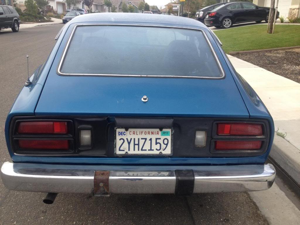

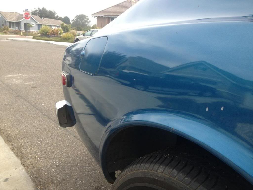

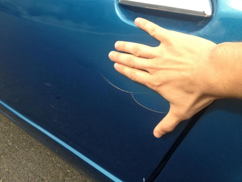

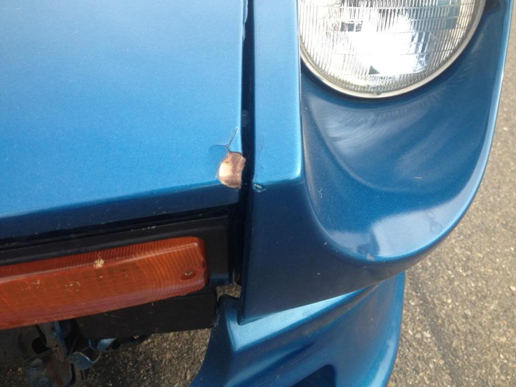

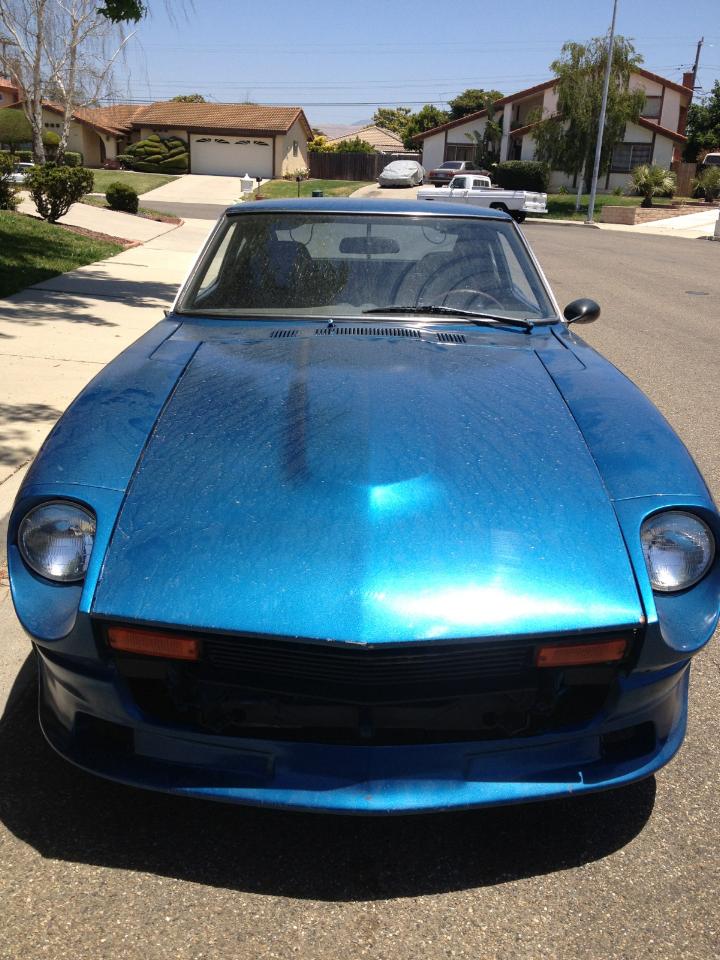

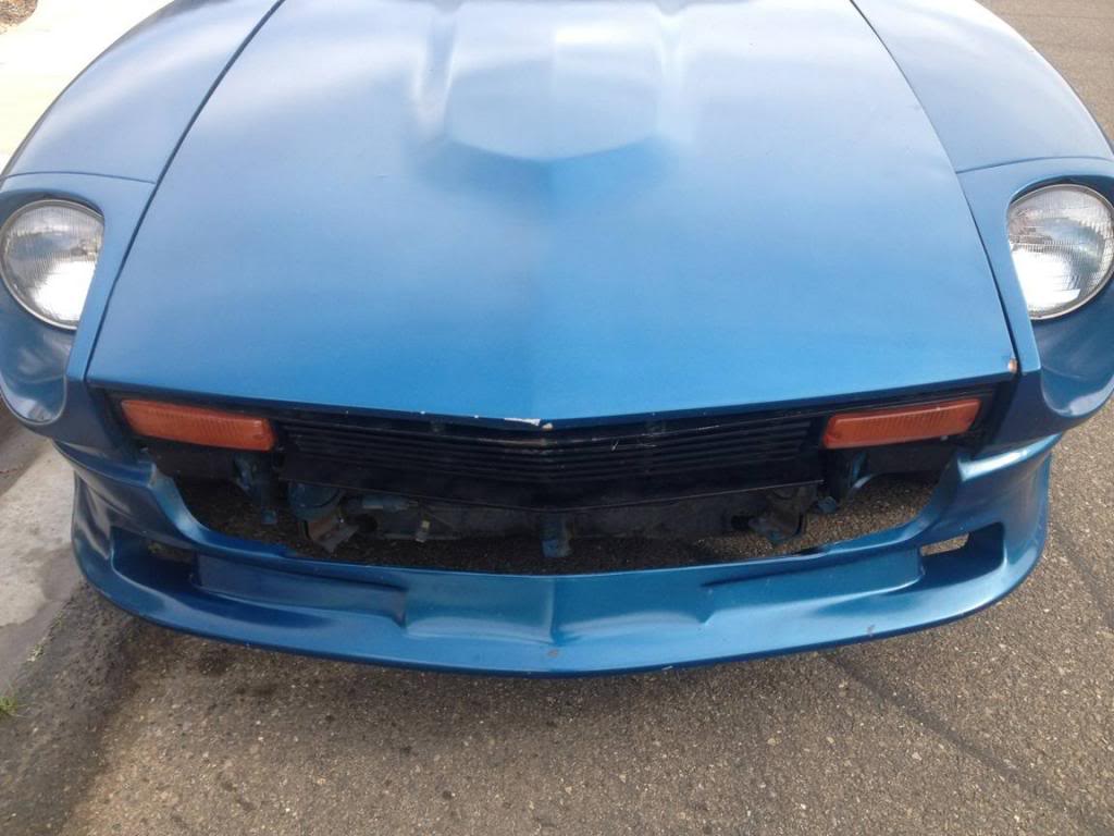

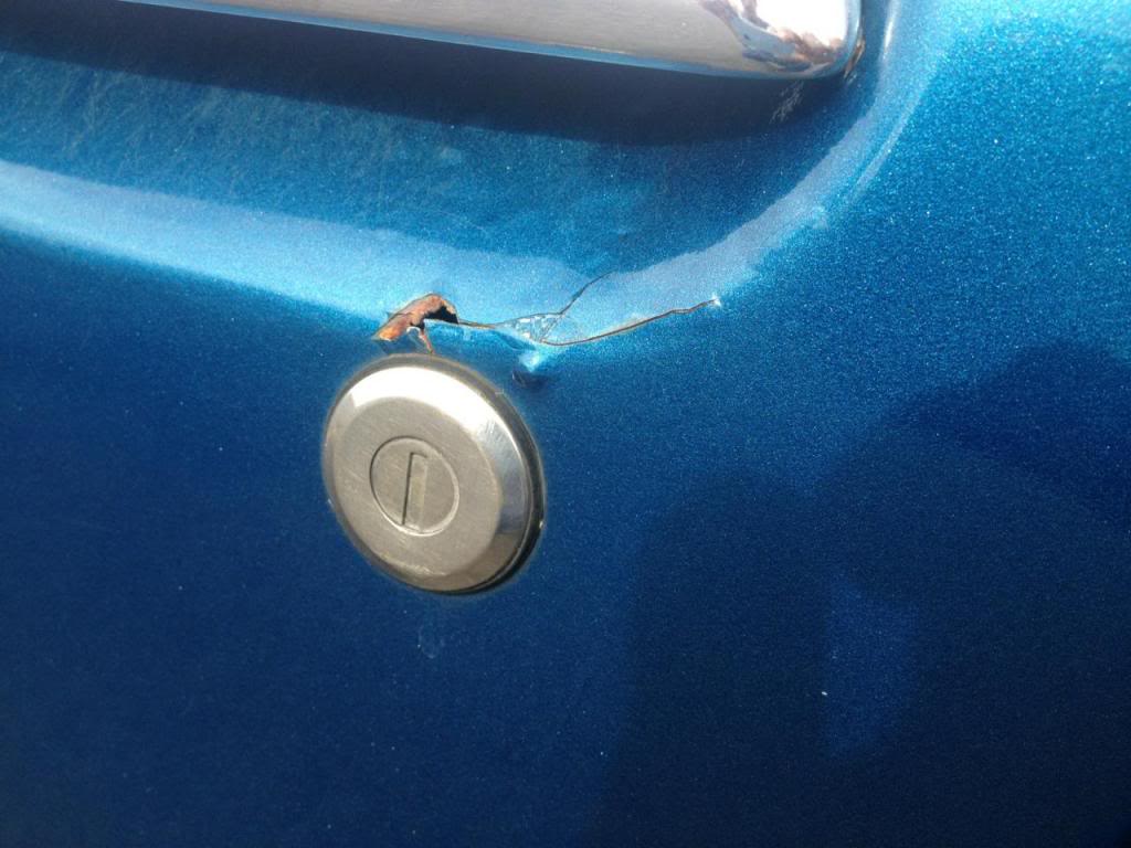

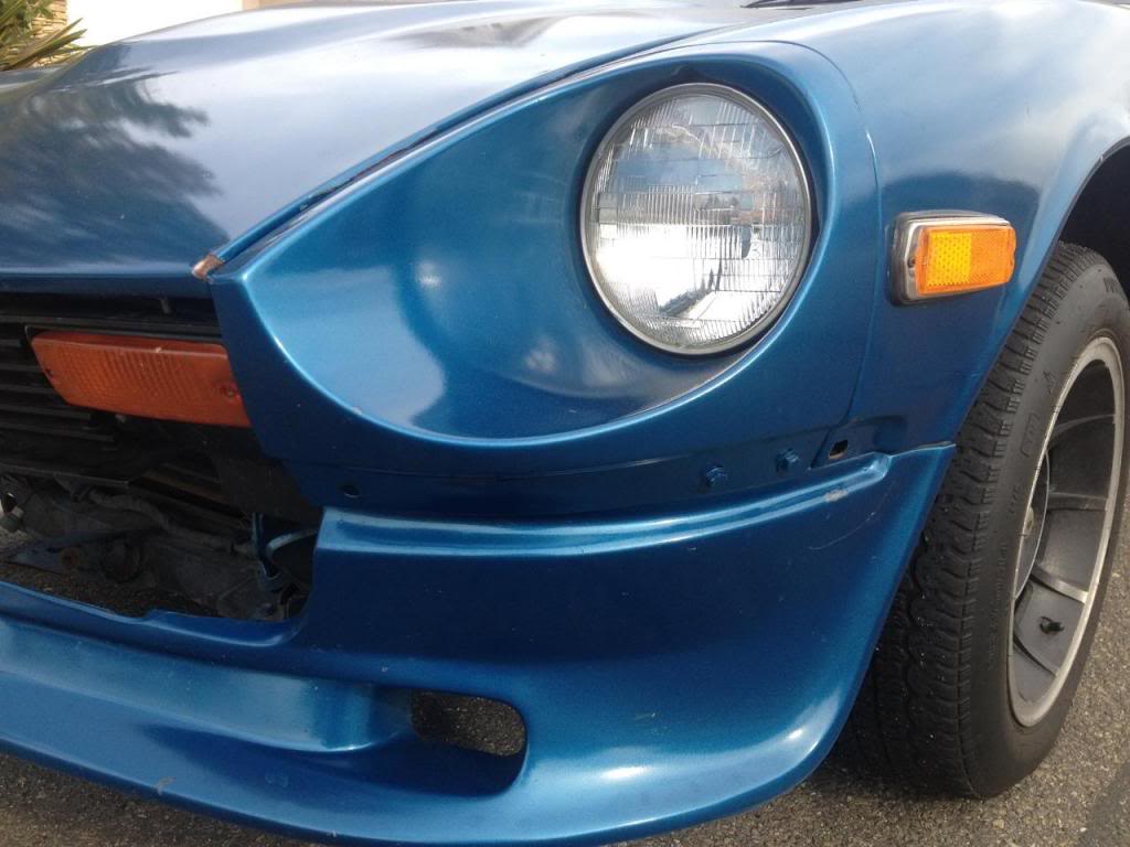

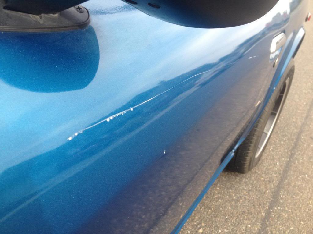

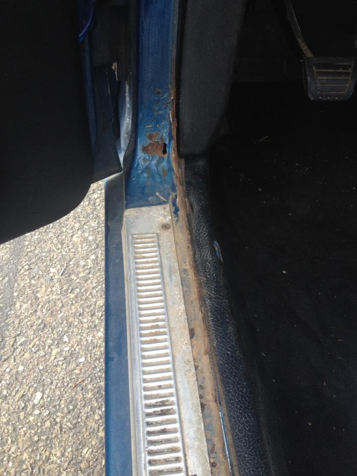

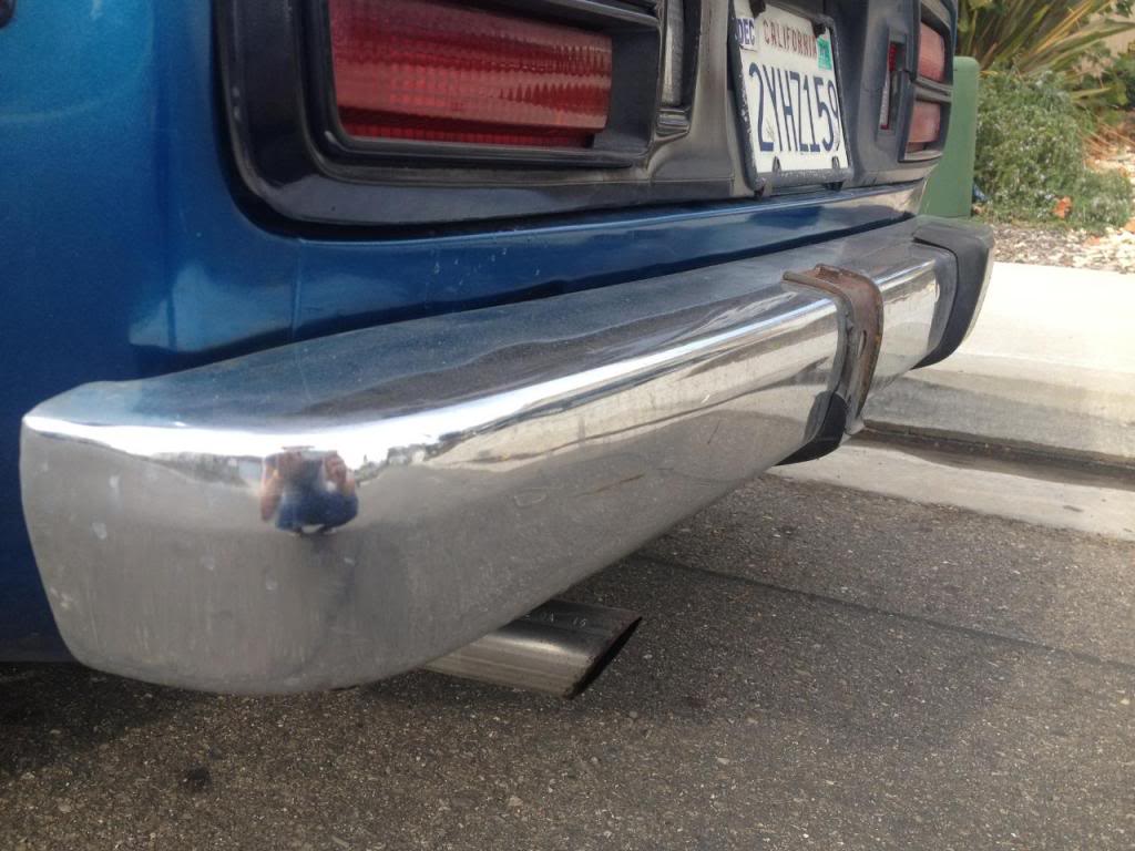

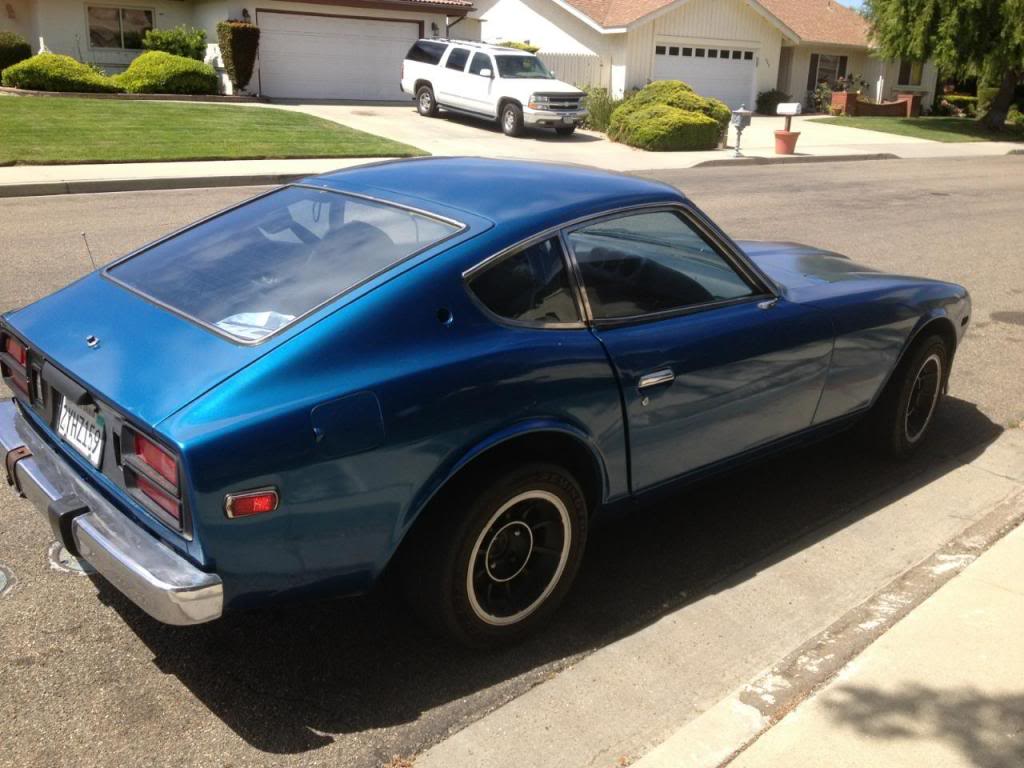

Looking forward on buying this Z but would like to know if I'm getting a good price. Can someone please let me know if this Z is a decent price at 2K?

Pros:
-1975
-Running
-Not an eyesore
-new head gasket
-new water pump
-new timing chain
-new muffler
-new calipers
-new brake pads
-"turned the rotors"
-few things in the interior
-has replacement dash (no cracks)
-rollbars installed
-tags are good till' dec
cons
-Stutters at about 3000-4000 rpm (mechanic said Air Flow Meter needs to be replaced)
-Rust, dents and other body damage (as shown on pics)
-original head gasket was blown, fixed. heads were warped, fixed.
-fuel gage does not work
-missing one wiper
-one turn signal not working
-small tears in seat
-ac does not work
-no spare tire
-driver side needs weather stripping
-passenger door closes and latches but has half inch gap
-rollbars installed?
Please let me know your opinion. Thanks in advance!

It has through rust in areas that don't normally rust that bad. Check the frame rails, hatch area and under the battery tray. Your cons don't list that it has major rust, needs body work and paint. If you can't get it for $500 and fix it yourself, pass!
Old Jan 27, 2013 | 09:58 PM
evandubya's Avatar
Primer Grey FTW!
Joined: Jul 2010
Posts: 587
From: hawthorne, nv
Looks like a lot of Bondo, and wavy paint, from having to fix bad repairs on the ones I own, I'd run away from it!!!
Old Jan 28, 2013 | 12:19 AM
Homeboyx's Avatar
Joined: Nov 2012
Posts: 95
From: Los Angeles, CA
Run forest run!
