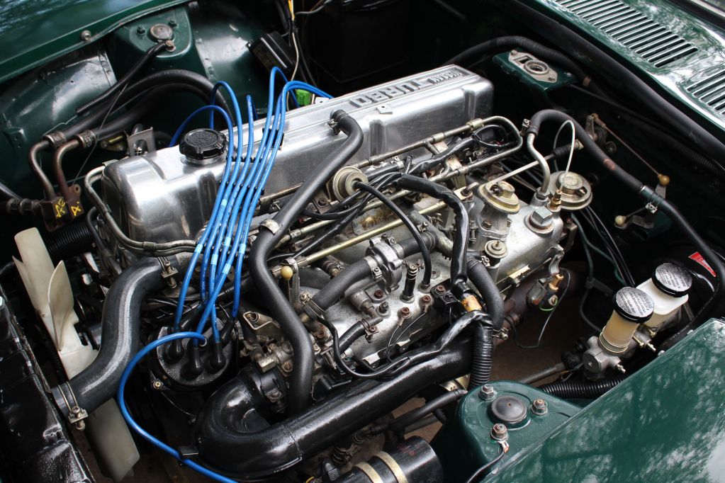

This car is the culmination of 2 1/2 years of work restoring this 1970 240Z, with every major modification being a direct bolt on from another Datsun Z-car, keeping it all in the family. I started with the 1970 body for its collect-ability and light weight. The engine is from a 1982 280ZX turbo, which is the best and most powerful iteration of the L6 motor. 5-speed transmission from a 1983 280ZX NA. Differential is the highly sought after R200 limited slip from a low mile 1988 300ZX turbo. Wheels are the 15 inch "snowflake" wheels from a 1981 280ZX turbo. Gas tank from a 1975 280ZX (fuel injected). Further details:
The engine is from a garage queen 280ZX turbo with auto transmission and 119K miles and has always used synthetic oil since break-in. The engine runs great and smooth and is very powerful. It always starts right up, even when cold, and has perfect compression. I tested the compression this weekend on 7/13/12 and is 141, 140, 140, 141, 141, 141 from cylinders 1-6, respectively. The engine has never been opened up but I did clean and de-grease everything and painted the block with black POR-15 when it was transplanted. Manifold and valve cover gaskets were replaced as well as the water pump. Recent tune-up with new spark plugs, distributor cap and rotor. Recent new injector and cylinder temp sensor connectors (the nicer quick-disconnect type.) Motor is currently running stock boost but can easily be increased for more power with a boost controller and intercooler. I will include an NPR intercooler and enough bends to install it at the buy-it-now price. This intercooler is an ideal size for the 240Z. I had plans to install it at some point, but the car is already very fast and I was satisfied with it's current power level. I kept the factory oil-cooler as well to keep the turbo bearings nice and cool.
Exhaust starts with a 2.5 inch stainless steel downpipe (from ScottieGNZ) and expands off of that to a 3 inch, fully mandrel bent exhaust ending at a Dynomax Ultraflow muffler. The intake and exhaust is very open helping the turbo to spool extremely quickly but is not too loud and sounds lovely at full throttle.

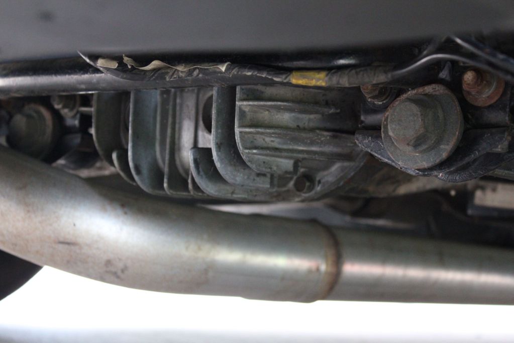

The limited-slip differential is from a low-mile (90K) 300zx turbo with auto tranny. It is in great shape and really helps to get the power to the ground and stabilize the car when accelerating out of turns. A very nice upgrade for such a light car with this much power. The mounting "mustache bar" is fitted with urethane bushings and the nose of the diff is held down with a custom steel strap that keeps the drive train in place and eliminates the common "rear end clunk" found on so many classic z-cars.

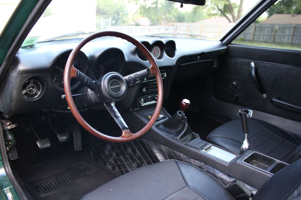

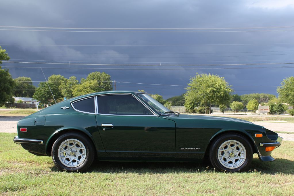

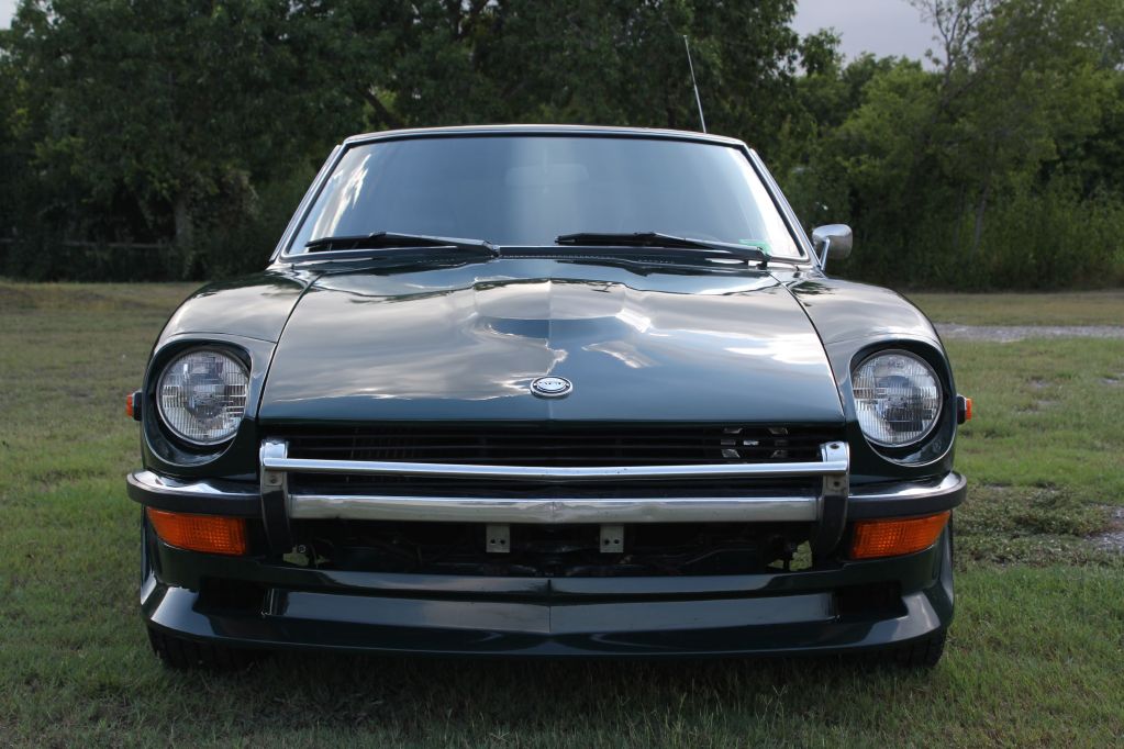

The body was stripped to bare metal and primed and painted in 2002 Jaguar British Racing Green with high-quality materials. Chrome is in good shape on the bumpers and trim. All emblems are brand new OEM Nissan. Front urethane air dam has been added for high-speed stability, but otherwise, the exterior is stock. Interior has been fully restored as well and is in excellent condition. New carpet kit, new half dash-cap, new weatherstripping all around including the glass seals and a new front windshield. There is on small tear on the driver's seat where I put my hand through a seam when I was detailing the interior (Aarghhh!), other than that, seats are excellent. I believe they are from a 1978 280Z. All interior vinyl is in good condition and the shift boot and **** are new. All gauges and lights work as they should.

Hey Guys, I'm going to search, I promise, but can anyone quickly tell me why my turbo engine looks so different from the attached...I'm wondering why my manifold is so drastically different:
http://i2.photobucket.com/albums/y43...2/IMG_0768.jpg
http://i1100.photobucket.com/albums/...EngineLeft.jpg
Sorry - I'm so brand spanking new to these cars and engines - so flame away if you feel the need. LOL

Its most likely because yours looks like its a mostly stock turbo engine and it has all the factory redundant vacuum lines. theres a write up on here that can show you how to remove and reroute all the redundant, uneccessary vacuum emissions. The other one has abunch of the lines removed and rerouted along with what might even be an aftermarket intake manifold.
However, I wouldnt remove or reroute stuff unless you're confident you know what you're doing or you're having a bunch of vacuum/emissions/starting problems.
And you are correct, these guys will tear you a new one if you don't search for stuff haha.
Actually i found it, heres the link:
https://www.zdriver.com/forums/240z-...anifold-19937/

You're already missing 3 vacuum lines that I can see and another is capped off. The manifold on that other "Turbo" engine is from an early NA motor and it has a intercooler plumbed in. It may not even be a Turbo engine.
