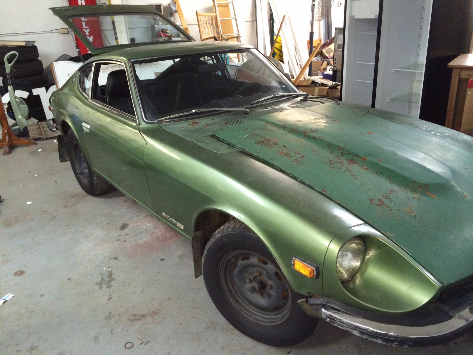

New to the forum and z cars. Wasn't quite ready for a project but this fell into my lap after my brother decided he did have time. One owner 74 260 that has been sitting in storage since 1990.
Just reinstalled the gas tank after cleaning the inside and got it running. But now the transmission is not doing anything when placed in gear. No forward or reverse.
Any thoughts?

Welcome to the forum!
I've got a thread running on a major 260Z restoration project here: https://www.zdriver.com/forums/240z-...project-37922/
From the looks of your car, you have the late model 260Z. If you don't already know, the 260Z was a 1974 only car (sort of) with two variations, the early and late models. Some folk will call the late model a 1975, others call it a late 74. Whatever.
You can think of the late model as an early 280Z body with a 260Z L26 motor and crappy flat-top carbs. That will help you figure things out when you purchase parts.
Download the FSM (Factory Service Manual) for your car. You can find it at XenonS30
I suggest you get manuals for both the 260Z (the one on the web-site is for the early model car) and the 1975 280Z.
Now for your question, first of all we need to know if this is a manual or automatic transmission car.
If it's a manual, do you get any pressure on the clutch pedal?
If it's automatic, I can't really help (zero mechanical experience with automatics) but hopefully someone else will chime in.

Looking at the photo again, you're right. I confused your bumpers with the larger ones that are like the ones on the 280Z. I also couldn't see the combo lights on the front. On the later model they're in the grill. Your date code confirms it is an early 260Z for sure.
Ok, back to your four speed manual tranny. Looks like you've got some hands on experience.
Are you sure the clutch is engaging/disengaging? If it's fried or just worn out, you'll likely get the symptom of no-go as it won't grab the flywheel surface. If, with the engine running, you can change gears without the clutch pedal depressed, I'd bet on a clutch problem.
Do you know why the PO parked it so many years ago?
