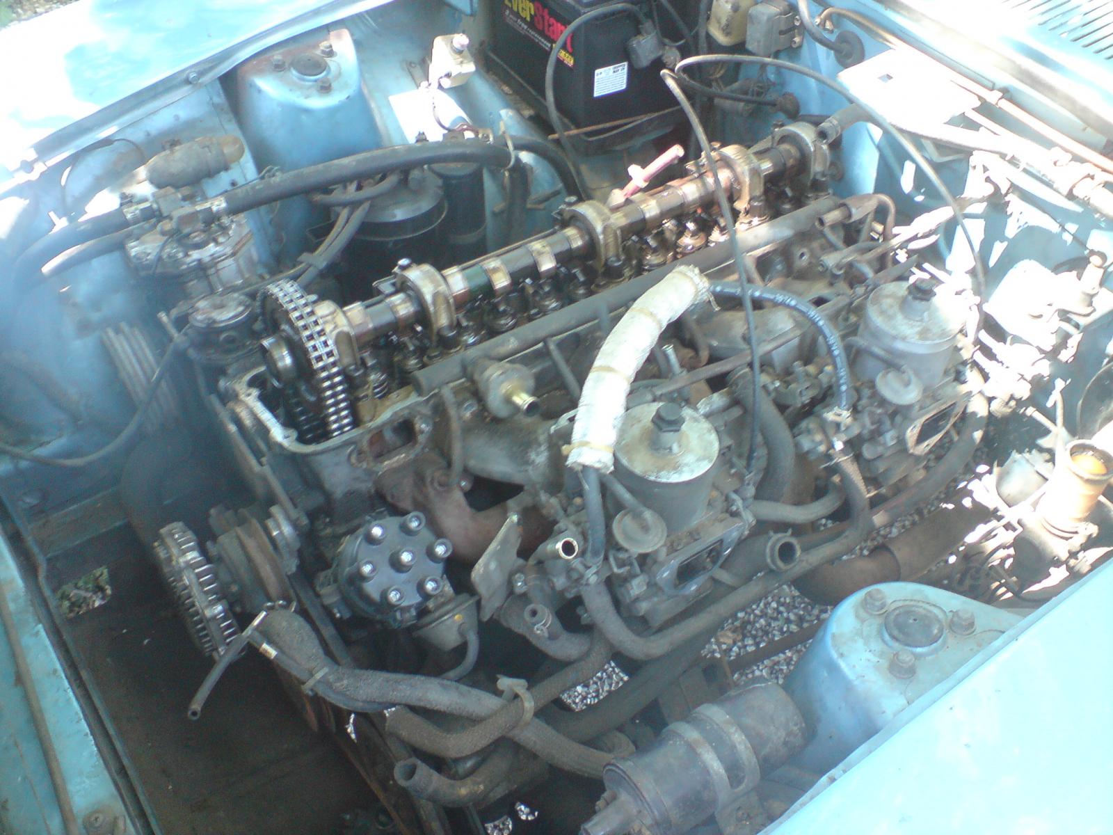

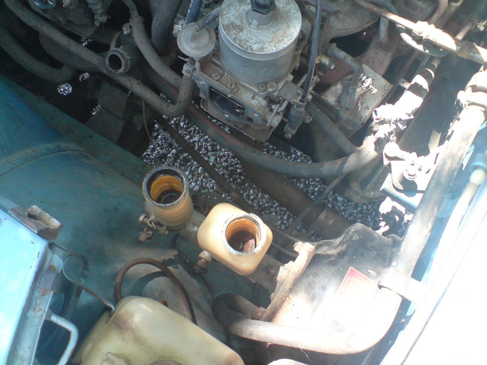

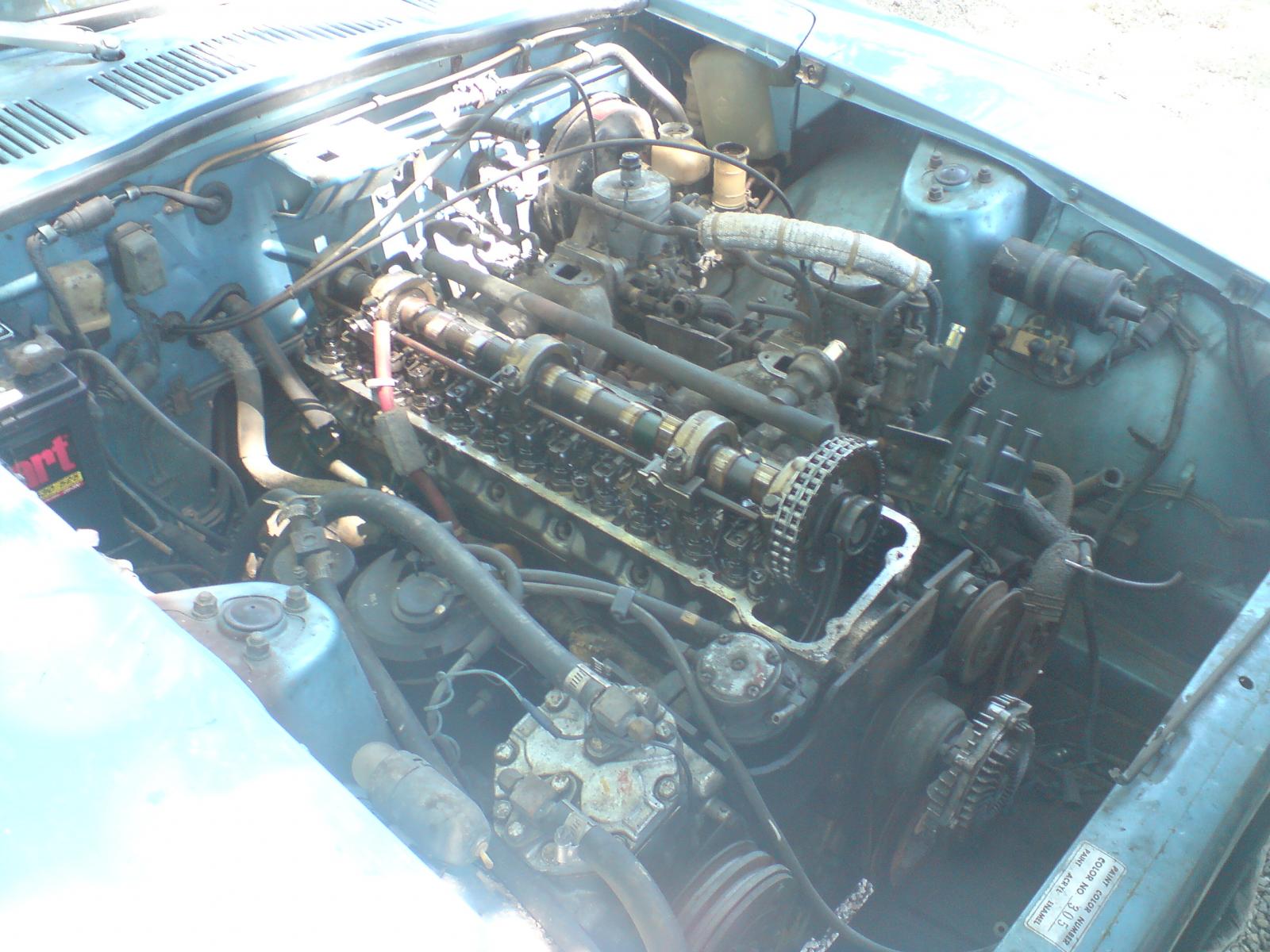

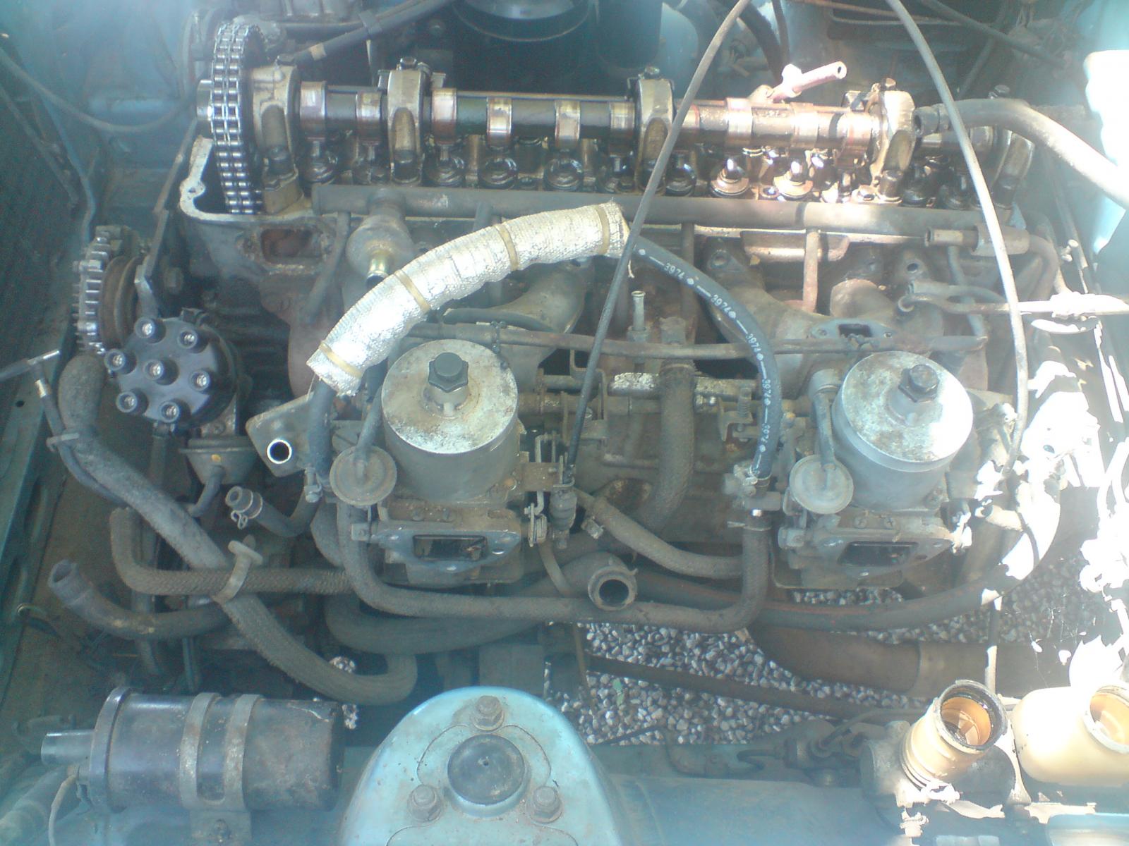

Finally able to get some pictures of the engine bay. If more detailed ones are needed, lemme know

looks like your going to have fun trying to get that engine back together. if you planning to stay as carbs do yourself a favor and get the 240 carbs. the 260 flats will give you more headaches. also noticed you will need a coolant housing that has a temp sensor. and a fan. as well as many other things. you can throw some body shots up. to please our addiction.

Yea, I've already started to rip at apart and clean up alot of things... and O...M...G there was so much carbon inside it... not to mention I found some bone from a MOUSE inside cyl4... wtf seriously...
But I do have an L24 with the carbs, so you suggest to just use the carbs from the L24? and just so I'm sure, what numbers can I look up on the carb to ensure they are indeed for (from) an L24?

The earlier SUs have round domes on top. There is a 3 screw and a 4 screw version, I don't know which one is best. Use the head off the early 240 if you can. The later E88 smog head has smaller quench area to run hotter.
