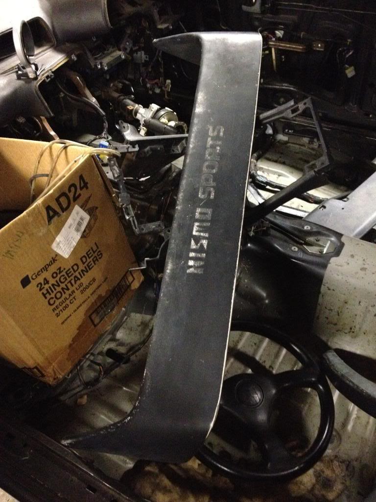

I purchased a car and I'm trying to figure out this wing. It says Nismo on top and it's a one piece. Also has holes ready to screw on bottom. It's factory where you can just insert a bolt underneath through the hatch. Im curious what kit it is and what's is value. Plus, if it's a real authentic Nismo, considering many thought it was.

I've never seen an S30 wing like that... I just looked in the 3 Nismo catalogs I own and can't find anything even close to it, nor does it look like an OEM / Nismo product.
Got any close ups of the Nismo logo?

Perfect person to ask, I just snapped this.

The logo looks like it was spray painted (to me anyway). I think that's a super old version of the logo... but I doubt "Nismo" would have just spray painted it on there like that. I think someone found a universal wing that would fit and bolted it on.
