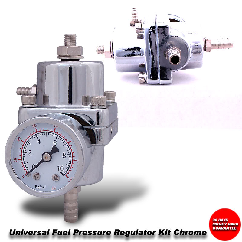

I would use the stock pressure regulator unless you are trying to boost match it. I bought a cheap adjustable regulator a while back for like $20 on ebay. It's very easy to adjust, but doesn't hold pressure at all when the fuel pump is off. I let the system prime before every start.
Well see the stock regulator was giving me the same issues. So it was making me think it was bad. What I bought is an adjustable that has a 1:1 boost reference or something like that so that it will increase pressure under boost.
Actually adjusts exactly the same way as that. Like you mentioned along with a couple on hybridz, so far it seems like none of these after market regulators are any good at holding pressure when the pump is off.
