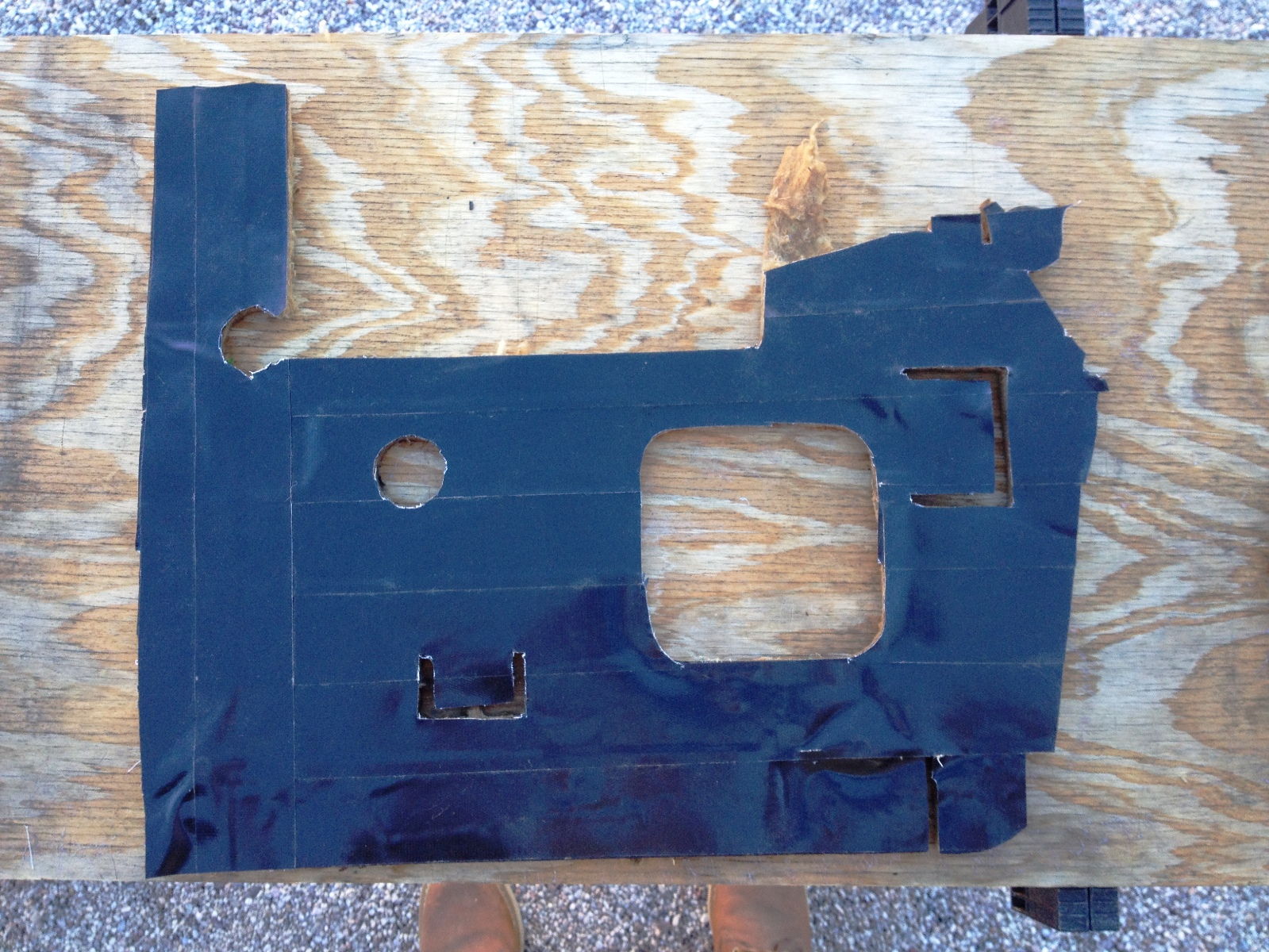

Installed the sound deadening in the rear and front areas. Haven't done the doors yet as they are at the body shop, safe from my wild gyrations with sharp objects.
This stuff was relatively forgiving with some stretchiness. I didn't have to make a cut at every little dimple and curve. I used a carpet/headliner adhesive which seems to hold well. Some of you will note I have installed the foil side down. I see lots of photos of cars using auto-specific stuff with the foil up. I chose to have it down cuz in Arizona you want to keep the heat OUT, not in and besides, that's what the instructions on this material said to do.

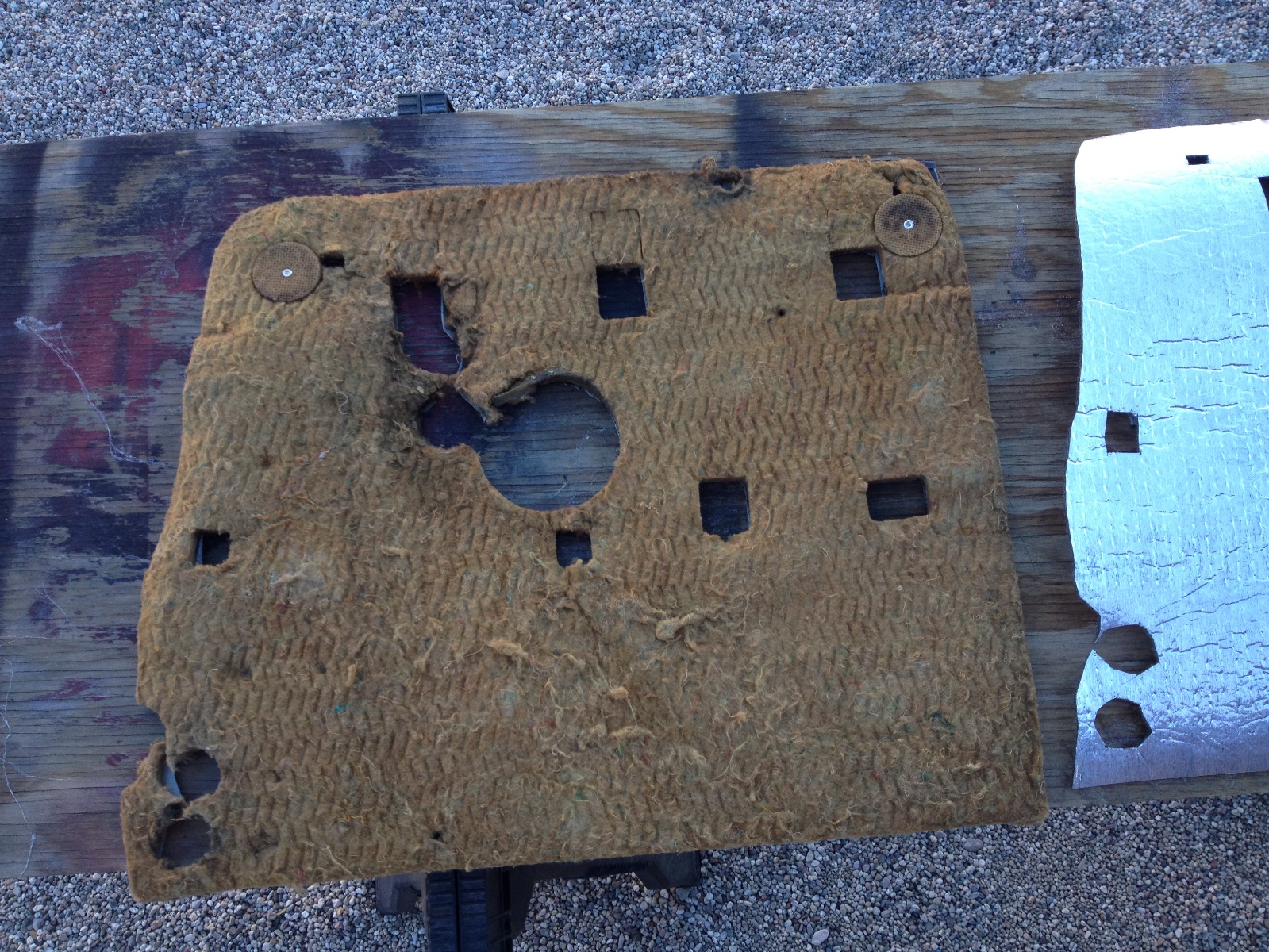

Next up was the firewall. I chose to re-use the original jute firewall material as a couple of internal parts (steering wheel, heater box, etc.) mount over this material. What I did do was rejuvenate it a bit and place the floor underlayment underneath the jute. Rejuvenation was done with Gorilla Tape, that's duct tape on steroids. A lot of the top layer of the jute is a rubbery material which has become brittle with age. The Gorilla Tape holds it all together and should last for quite some time.
It all looks good and will be mostly hidden anyway under the dash when it goes back in.

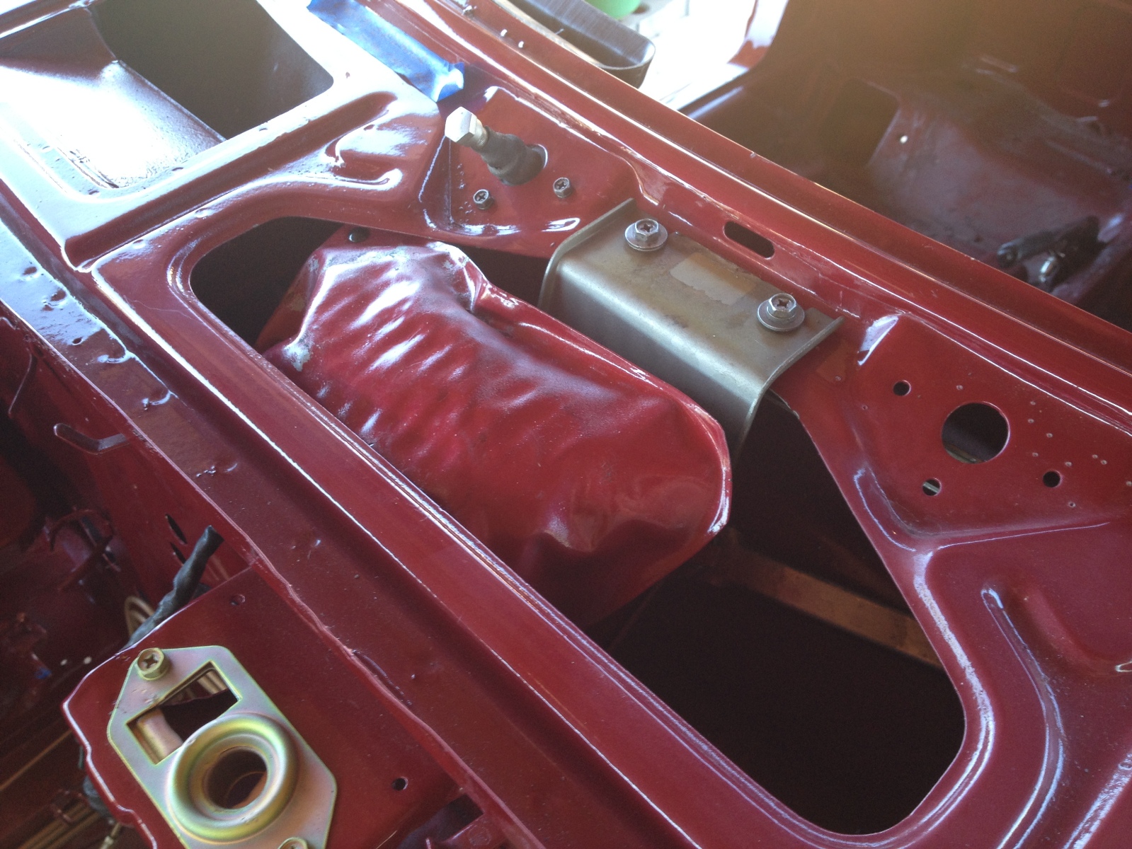

Oh Yeah, Almost Forgot
Got the wiper motor assembly reinstalled too. This is not a job I would want to do very often. It certainly helped the engine bay was empty.
Yes, I did have the bag painted to match the car (got some touch up to do on it).

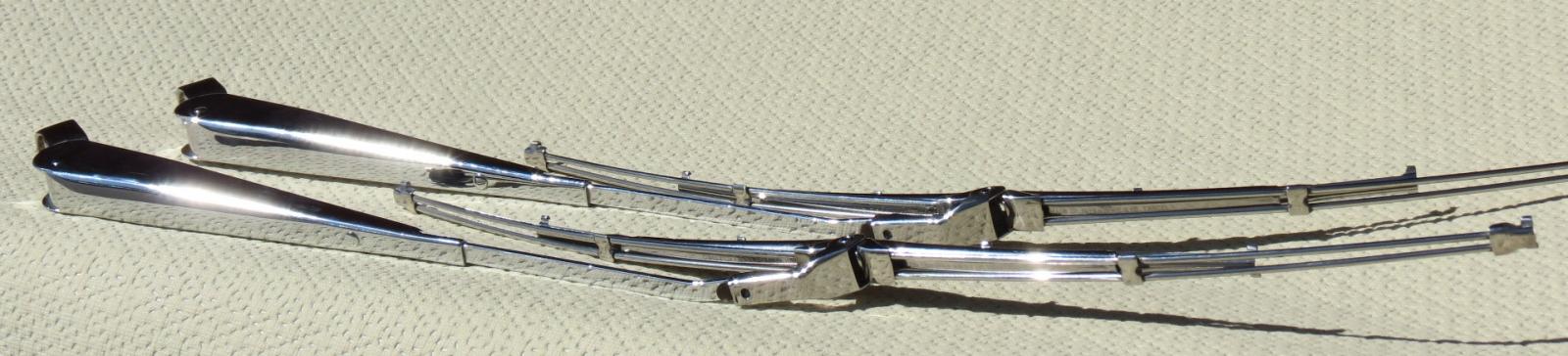

Decided I will have the wiper arms and blade attachments chromed.

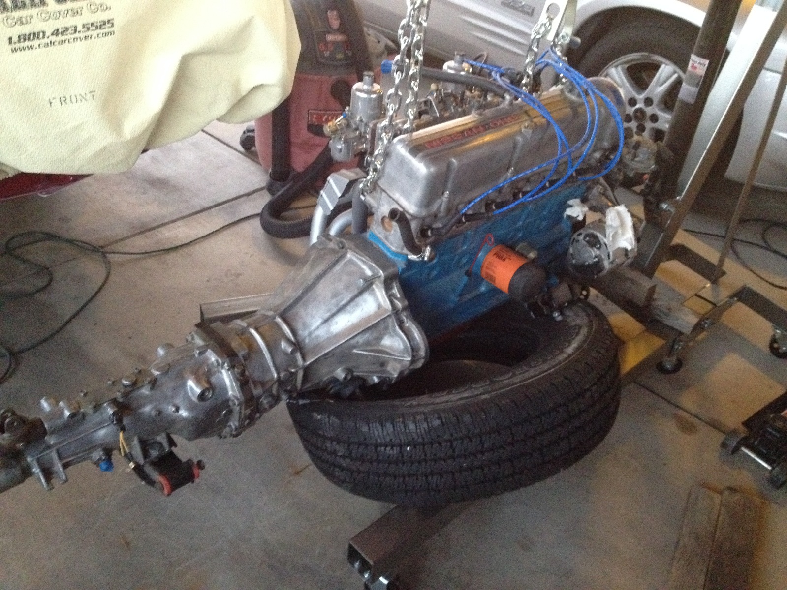

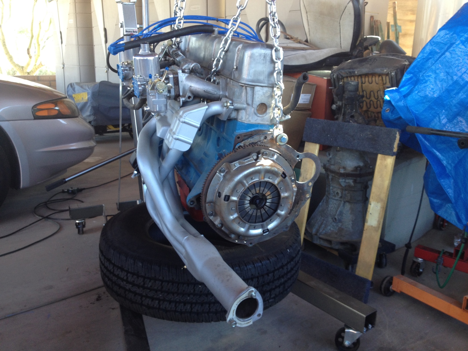

Now it was time to get out the engine hoist (bought on sale a year ago) and get this motor off the stand so I can get at the flywheel. Yay, that worked.
Installed the clutch and the spring assembly. It was off one of the cars and was so fresh you could still read all the markings on the friction plate. Torqued everything down to FSM spec.
And finally, the transmission. Installed the throw-out bearing and the push lever. Was careful to follow the FSM's instructions about grease. Then the hardest part of all. Getting the darn thing to mate up with the engine while it's on a hoist. Thank goodness I followed someone's suggestion to spend about $5 and get one of those clutch plate alignment tools. This would have been a
of a job if I was unsure about that as well. The setup I finally got to work was to place the tranny on a small table and bring it up to the motor on the hoist. I had a leveler on the hoist which really helped. Once I got all the parts lined up, it took a couple of tries with some small adjustments of the crankshaft and finally after about an hour, the thing slid into place. I quickly bolted it in, set the whole assembly down on a tire for cushioning and went in for a beer, dinner and then writing this post - in that order.
All this was done without assistance BTW. For the next step of installing this assembly in the car, I think it will be wise to have some help. My son lives in town and will come by Monday morning. Meanwhile I'll be putting some wheels and tires back on the car and taking it off the jacks as I want it as low as possible when we hoist this mess over the core support.
Heck, I might, just might, give it a go myself as tomorrow is Saturday.
If anyone's got some pointers on an unassisted motor/tranny install, I'd love to read about them.

I was a little worried about leaving the motor/trans hanging on the picker. However the old tire seems to be keeping things stable and the picker is only a backup, keeping it from falling over.
BTW, that tilt bar was certainly worth its cost, even if I only use it once.

Anyway, there's a little bit of bling to report. I finally got the original equipment wiper arms back from the chrome shop. It took them a long time as they are made of two different types of metal with the pot-metal base being very difficult do. They did turn out nice IMHO.
